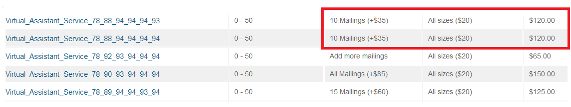

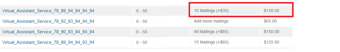

However....I have run into a problem when I add a 3rd option. Here's what my variable page looks like when I have ONLY 2 of the characteristics: Notice it is showing only 4 items:
Add more mailings (the default when the customer doesn't want more mailings
10 mailings
15 mailings
All mailings
I put a red box around the 10 mailings to show it's only listed once
Now, when I add the 3rd characteristic and go to input the price for the variables, it gets really confusing. This 3rd variable allows them to add an option of a blanket mailing regardless of size for an additional $20.
Here's the variable page now...notice that there are TWO rows for 10 mailings!!!! WHY are there 2 mailings and if that's correct, WHICH ONE do I update?
12 years 2 months ago #157920
You can create manually variants (a product with characteristic values) so the problem is that, you can create duplicates.
So you can remove the newer one (with the higher product id).
