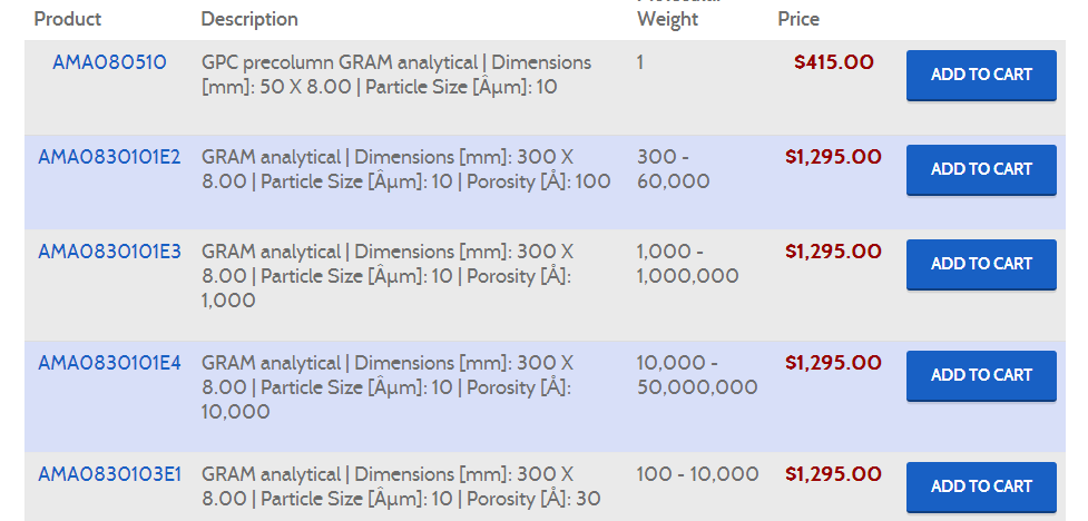

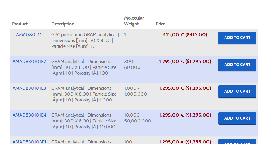

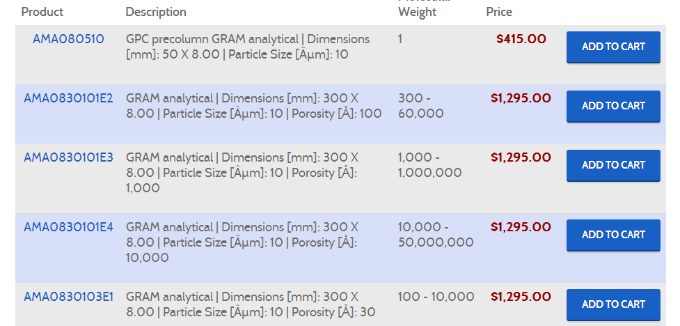

  • Posts: 46
11 years 10 months ago #174371
This is very frustrating, something must be wrong with my configuration.
I have checked currencies, zones, plugins and my individual products and i can not get the appropriate currency to display.
I even tried to change the default currency to Euro and zone for USA to Euro but prices still appear as USD. If I unpublish USD, the price is listed as "free" even though I have Euro prices for the products.
What could I be missing?
Here is a product page that has both euro and usd prices for each product.
www.pssgpcshop.com/index.php/hikashop/category/110-gram-columns
Attached is the screenshot I see when I visit the page through a German web proxy and when I visit from my computer in the US.
Last edit: 11 years 10 months ago by mank087.
  • Posts: 86079
  • Thank you received: 14186
11 years 10 months ago #174403
Based on your screenshots and your explanations here is what I can say:
First, the current currency is probably set when you arrive on your website based on your IP address (or the one of your proxy).
So that's great as it means that the geolocation plugin is doing what it should and that your zones are configured properly.
As you can see, when the price is in €, you get the $ price in parenthesis next to it. This indicates that the system couldn't find any price for the € currency in your product and so it is taking the $ price and converting it to € and as you have a currency rate of 1 and that you have the "show original price" option turned on in your product listing/configuration, you see the same price in both currency like in your screenshot.
So the problem is with your product prices. There are several possible explanations for why the system cannot find the price in € in your products:
1. you didn't set any price in € in your products
2. you set € prices in your products, but you used the "access level" icon to restrict them to only some user groups and thus the system cannot use them for the user group of your current user.
3. you set € prices in your products, but you don't have any € price for the minimum quantity 1.
4. you've changed in some way the € currency and the € currency which is activated is different than the one of your products prices.
So please check on these points. If that doesn't help, please provide a backend access via our contact form with a link to this thread so that we can check your settings for you.
