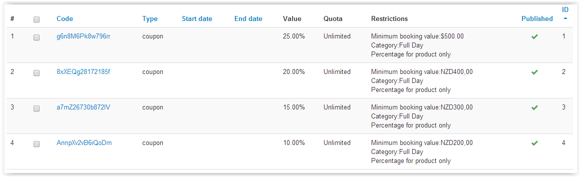

Below is a list of the coupons that used to work for calculating my discounts,
No it only ever applies a 10% discount. It should only give 10% for purchases in the 200's, 15% if in the 300's, 20% if in the 400s, etc
What might have change or have I done wrong?

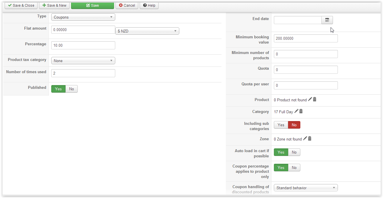

This how a coupon is set up
