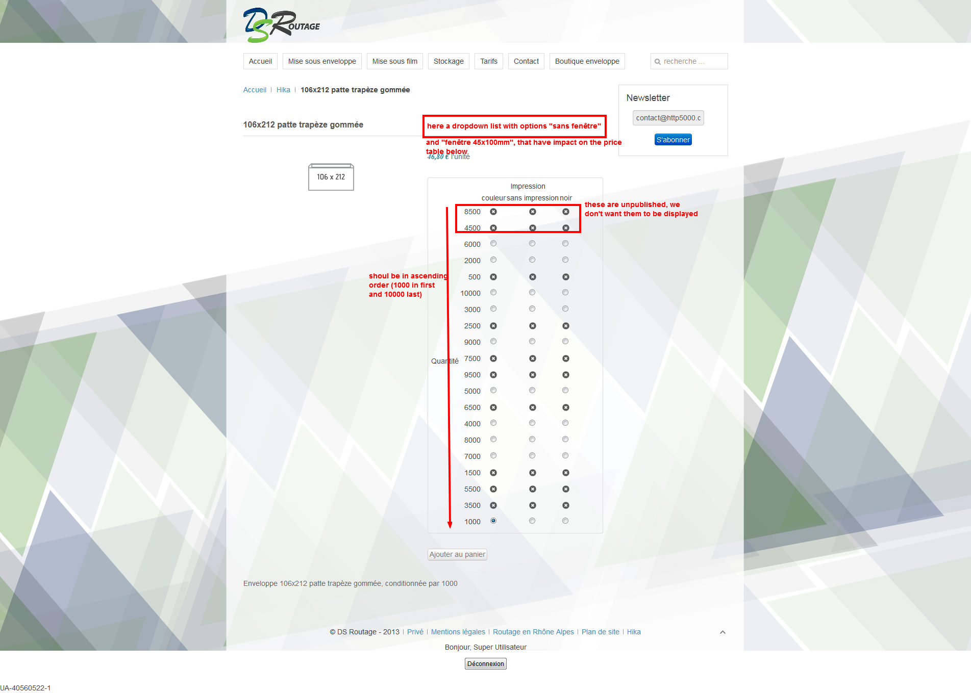

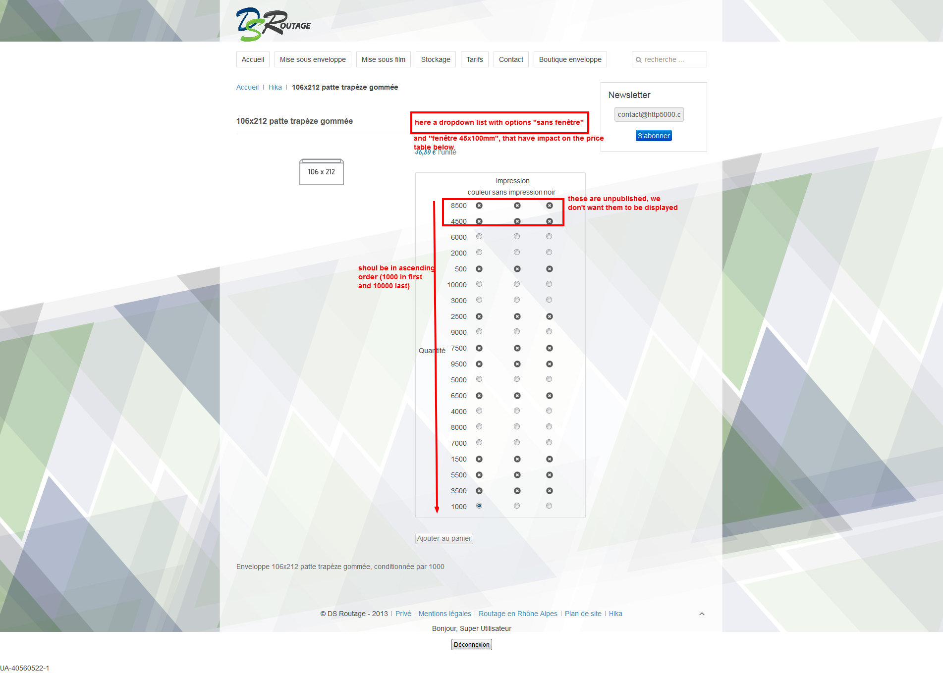

  • Posts: 181
12 years 2 months ago #159236
Here's a screenshot so it will be more clear.
I need to have an option, and to fill prices in characteristics that will be different depending on which option has been chosen.
Besides, I have problems with the display of the table : the lines are not displayed in the order I created them (the ascending order) ; and the characteristics that I have unpublished (because the product doesn't exist with them) are still displayed, but they shouldn't.
Thank you for your help
  • Posts: 86080
  • Thank you received: 14186
12 years 2 months ago #159251
No, that's not possible to do what you want unless you modify the code. An alternative would be to use the "table" display of the "characteristic display method" option of the configuration of HikaShop.
For the ordering, it depends on how you configured your characteristic (did you set an order for each values?) and how you configured the "Characteristics values ordering" option of the configuration. Please check that they are set like you want.
