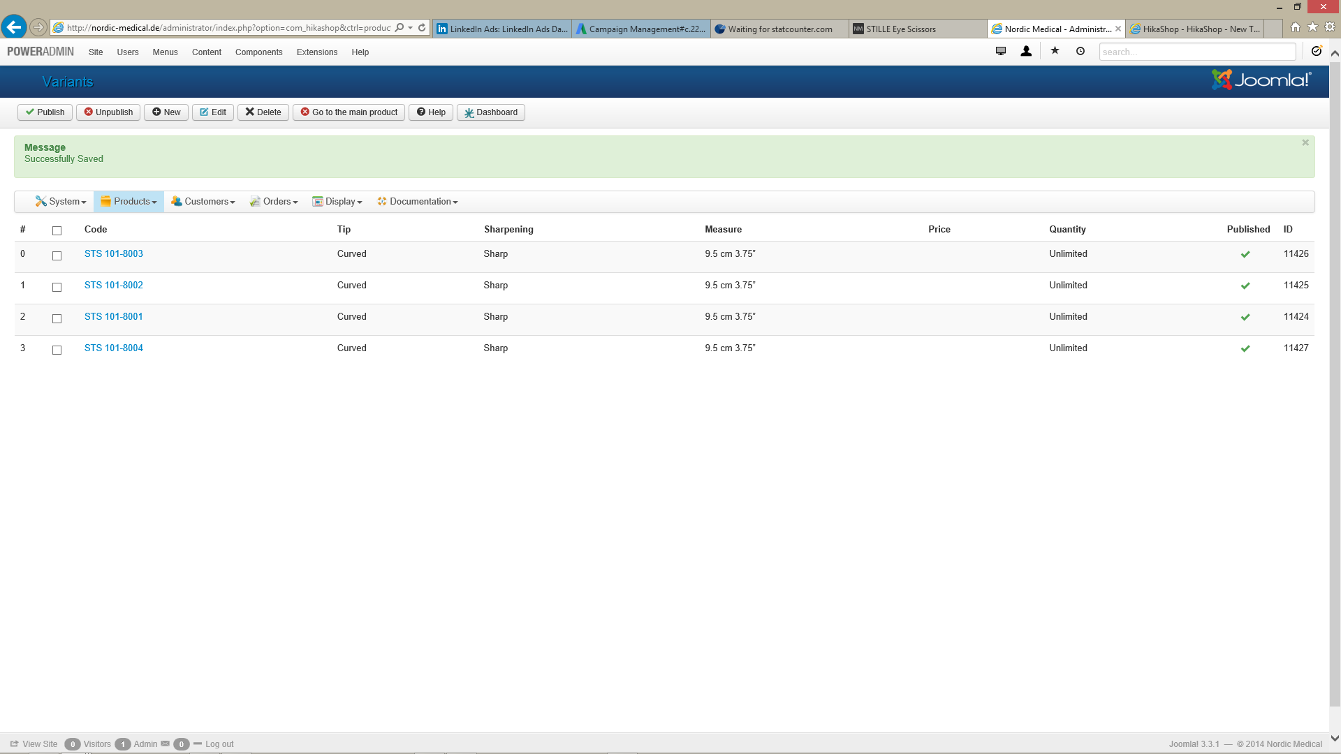

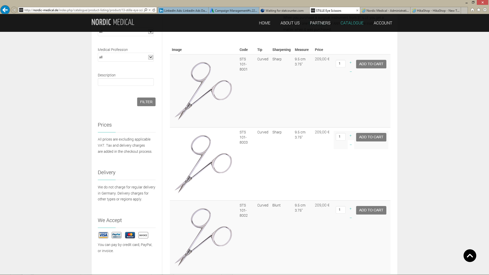

I've created a product wtih different characteristics (e.g. nordic-medical.de/index.php/catalogue/pr...-stille-eye-scissors ) and everything looks as it should. If I then go back to the product and make modification to e.g. the description or FaLang translation and click save ... the characteristics get all messed up or are reset to a default value. There's even a disconnect between characteristics specified on the front end and the characteristics specified in the back end.
