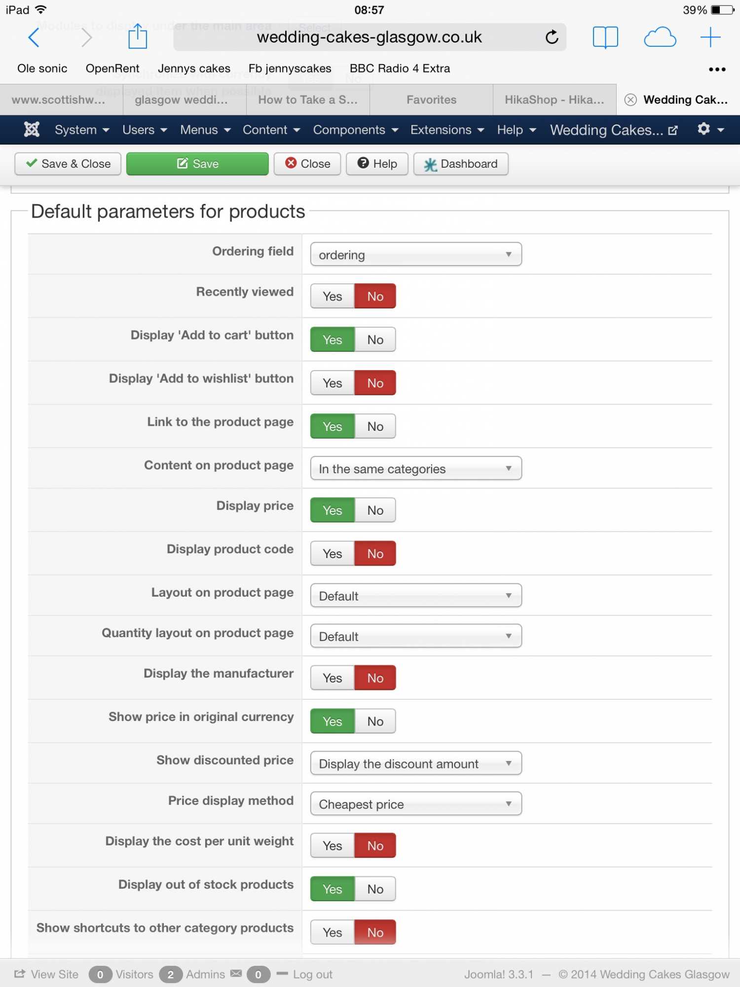

  • Posts: 30
12 years 2 months ago #160512
Hi again, changed template but the tabs still showing...

12 years 2 months ago #160515
Can you show me through some screenshots how did you configured the tab "Default parameters for products" of the page "Hikashop->System->Configuration->Display" ?
Thanks.

  • Posts: 30
12 years 2 months ago #160703
Using ipad, hope the screenshot is visible... Thanks!

12 years 2 months ago #160920
The problem was that you selected the "tabular" layout in the product edition page (page reached when editing a product in backend).
