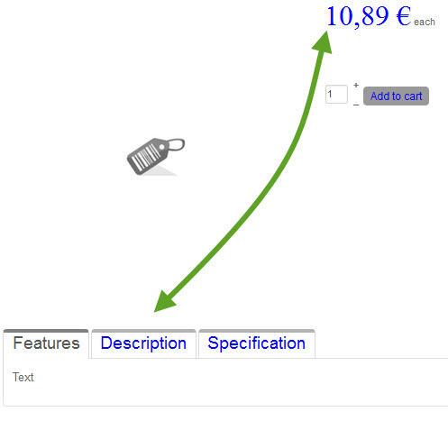

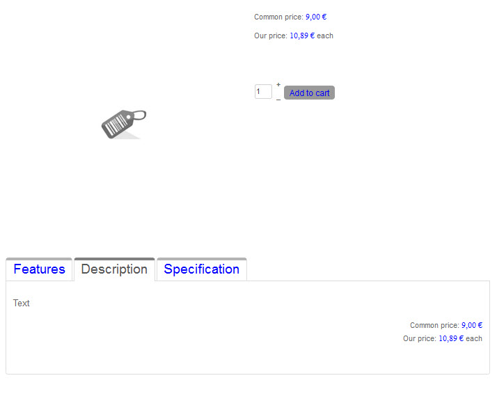

I made customized tabs for our product pages using NoNumber(image attached). The question is: Is it possible to move the product price to the Description tab? Just wondering.

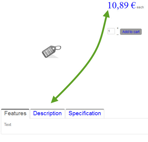

1. As I understand I have to go to Content, Article Manager then new, then I’ll insert the tag using the “Product” button. I did it, but there are no changes on the page. Or I missed something?

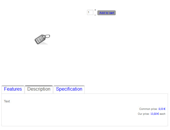

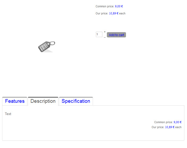

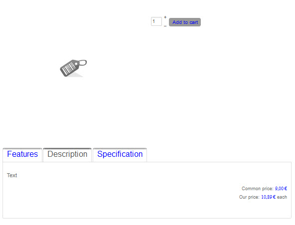

2. What I have tried as experiment was: I went to Hikashop, Products then open the product page and copied the tag above and paste it under the “Description” tab, and yes it appears inside the tab, only, I now have 2 displayed prices(please see attachment) and it is located at the right side. It should be at the left side if possible.
12 years 2 months ago #161592
An easier solution can be to hide the product price by using some CSS code or the "Display price" option through "Hikashop->System->Configuration->Display" and to directly add your product price through your product description.

Super! This one works, so at least I now have one solution. But my question 1 is still open and that was how can I do this automatically because I have to go for thousands of products when I have to do this each time by hand it's quite time consuming because I have to go to Article manager, copy the tag then paste it in Hikashop product page and a high risk for failure. I understand out of the answer of Nicolas that I can do this automatically, at least we know it is possible to place the price inside the tab, I now have a price inside the tab and switched off the price next to the product(please see attachment). But now how to do this centralized?

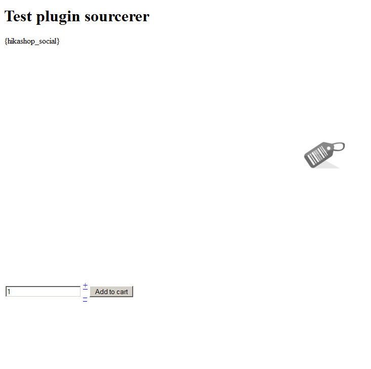

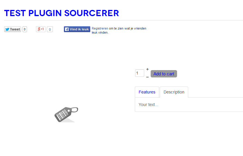

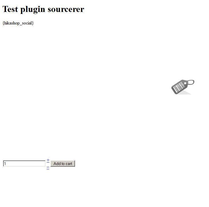

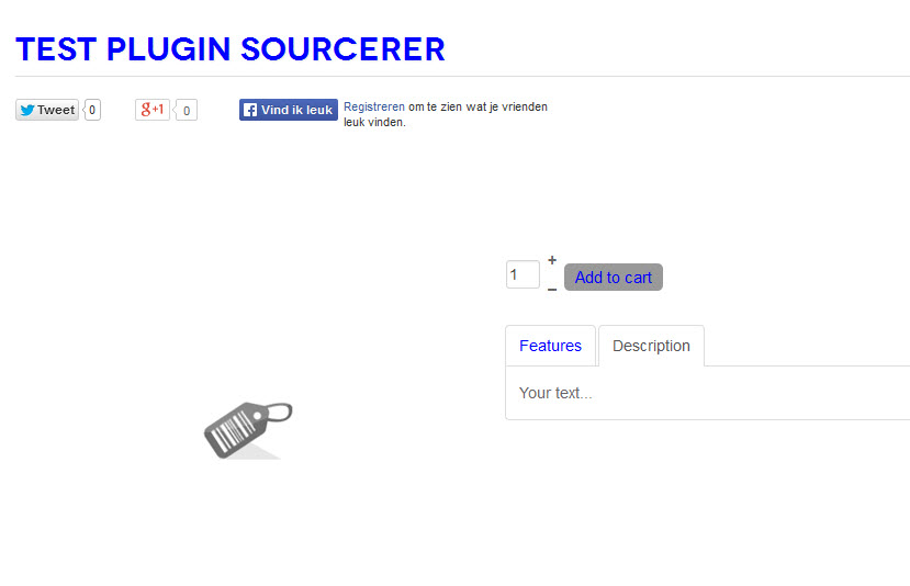

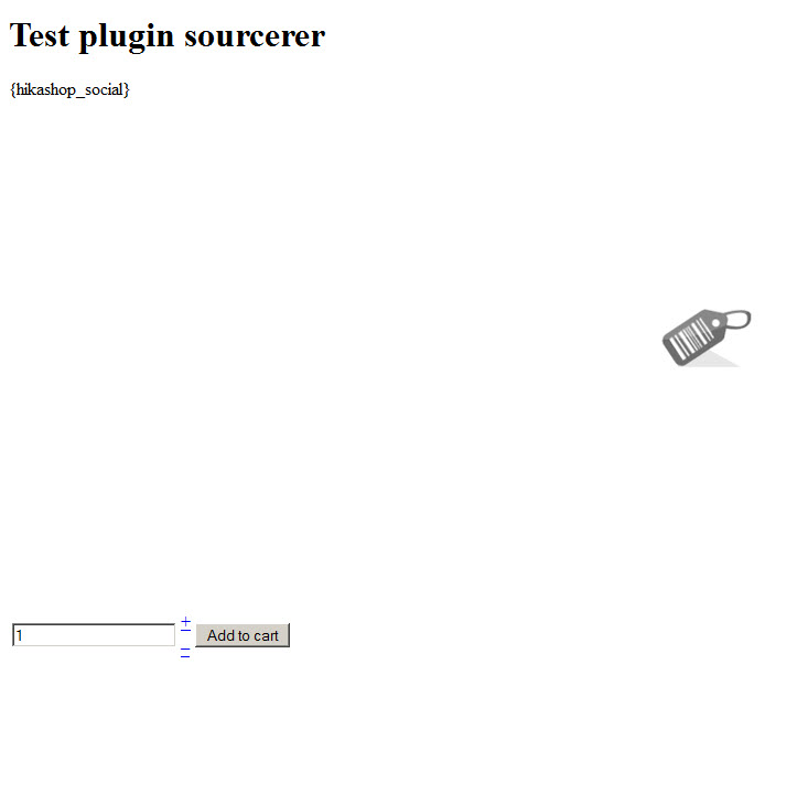

I installed the "sourcerer" plugin and tried to place it inside the description tab, the entire hikashop layout is gone(please see attachments as a comparison).

The full code is "<?php echo $this->element->prices[0]->price_value; ?>".
But there is maybe a compatibility issue between sourcerer and the tabs.

I have tried to apply your code using the Sourcerer inside my tab but the complete Hikashop product layout is messed up. Sourcerer for me is new so I’ve asked at their forum, can be that I missed something and show what code I have used but I understand from them that their there is no compatibility issue between the two, they said that the php is not complete and they pointed the “$this”. They said that it isn't defined anywhere, and neither are the nested classes. So I’m now back to you :lol: what must be replaced by the “$this” to let this work fine?

The method proposed by Xavier won't work.
Sourcerer doesn't have knowledge of the variables of the product page.
That's why $this doesn't exist for sourcerer.
But yes, doing it like I explained can't be done automatically for all the products at once via the interface. That's however the simplest.
Doing it with sourcerer, you'll have to add more complex code in it. And actually, it's really complex as it involves a lot of code to do that (getting the current product id, loading the product data, loading the prices, loading the price display interface with the product price) and it will even require to modify the code of HikaShop directly. So it's not a viable solution.
