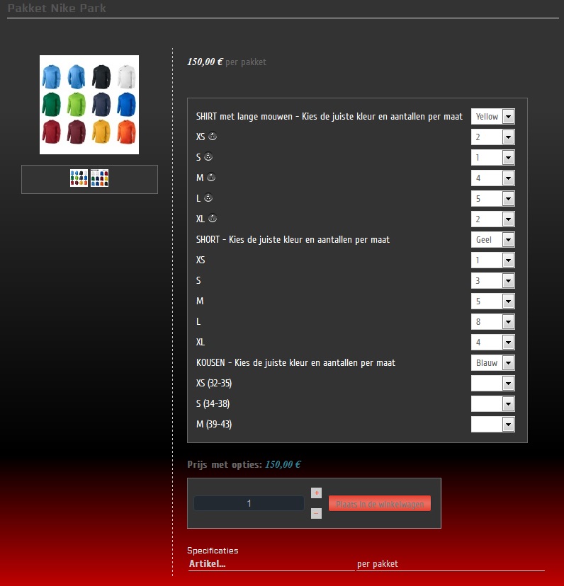

Hello Mohamed,
Thanks for the support, it has helped me allready a great stepp forward.. however I still have some questions...
As you can see on the attached image, people now can select the quantities per sizes, just the way I want. Now would it be possible to limit the total quantities to a maximum?
In the example image you will see that the sum of the sizes for the SHIRTS is a total of 14 pieces. When we count together the quantities of the SHORTS we become a total sum of 21 pieces... Our package has but a total of 14 pieces included for the SHORTS, so we have 7 pieces too much and that we need to prevent that... Is there a way that we can include this limitation? can you provide a sollution for this one?

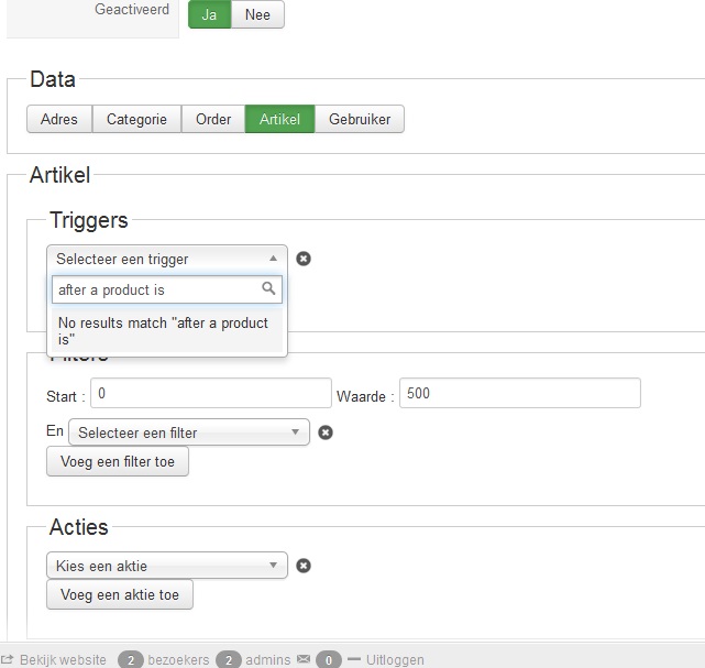

Secondly I'm trying to use the Mass action to adjust multiple products at once. I have made a custom field to change the "Per piece" title into the "Per Package" Now when I use the Mass action i'm unable to fill in anything into the fields, Am I doing something wrong here? (look at the attachement for a screen view)
I don't think that you'll be able to control the quantity of the options added by using variants, the only way will be to use the "quantity" input, or to use some custom code which will require some development skills.
Can you download the last Hikashop version through our website and test it again ?
  • Posts: 3
11 years 11 months ago #163238
I have tried this, but no succes :(
There is still no possibility to use the Mass action... And i realy need it to get to work.
Please help...
Dany

Please provide a backend access via our contact form so that we can look at your mass action and a link to this thread:
www.hikashop.com/contact-us.html
