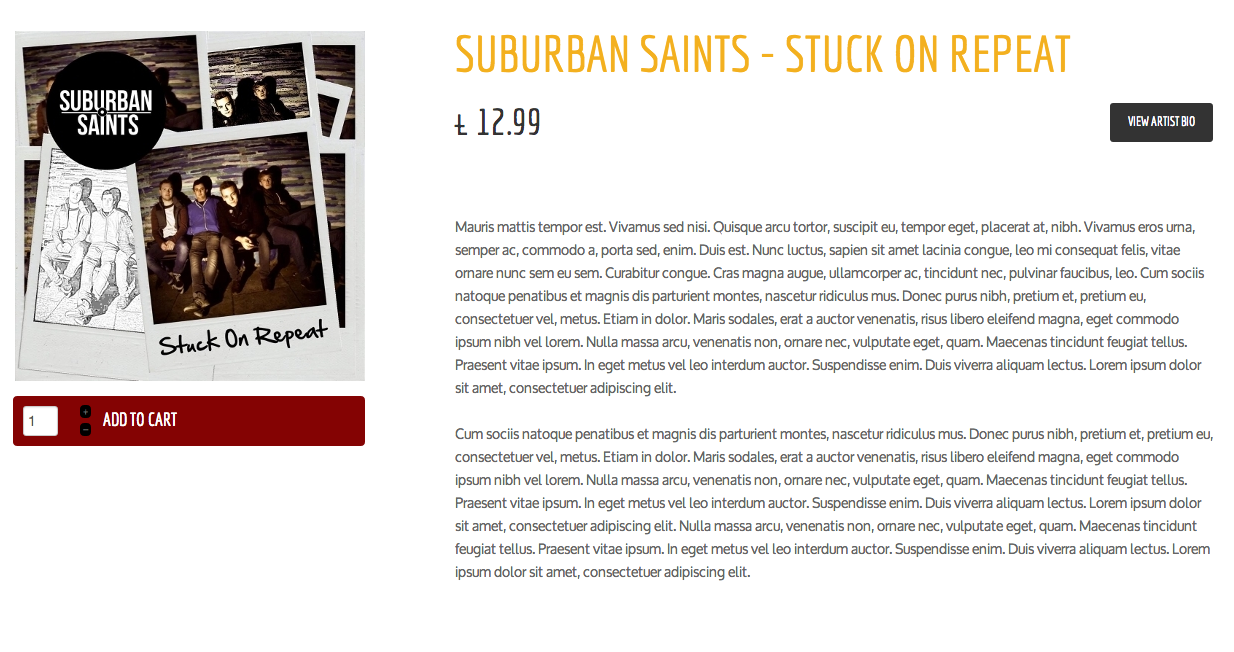

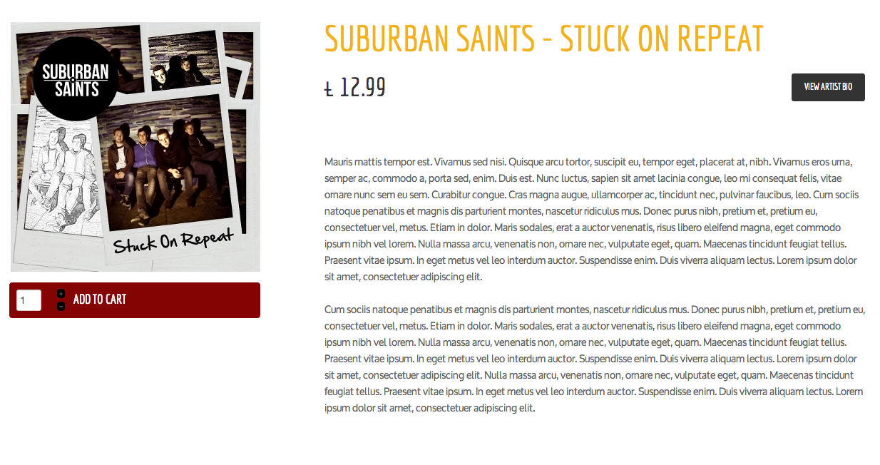

Attached a screen shot - the pound sterling sign isnt displaying properly, how can i fix this?

Looks like the Pound Sterling sign isn't part of the font which is used there. You could apply a different font for it per CSS .

1. This looks like it is how the pound is displayed by the font that you're using (or your template is using) for the display of that. So you would have to use another font which displays it properly.
