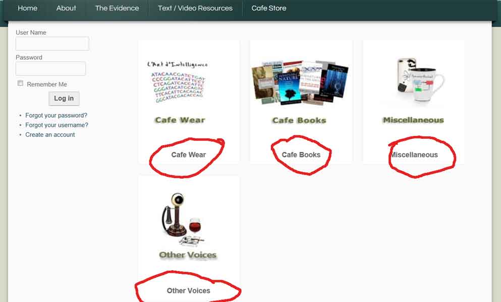

In Hikashop you can display categories with titles, descriptions, and images.
My image has the title built into the image, therefore I do not need to category name to display below it - but I cannot seem to understand how to turn it off. Cuyold someone pleas ehelp me understand this. I have attached a file showing the issue.
Thank You.

There is also a selection for only "Image" available. Check again the setting for the menu in question under "Parameters for DIV" and then "Type of item layout". Should work.
