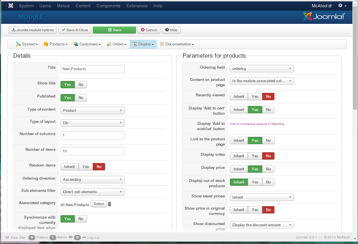

OK so I have the module working, I just can't change the the 'Associated category' setting. I can select the category "New Products", but as soon as I hit save it reverts back to "product category". Any ideas?

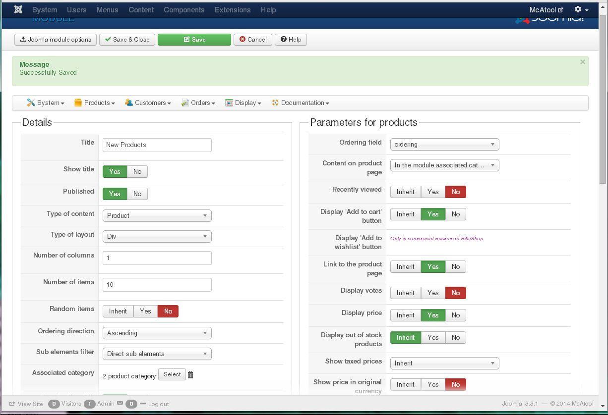

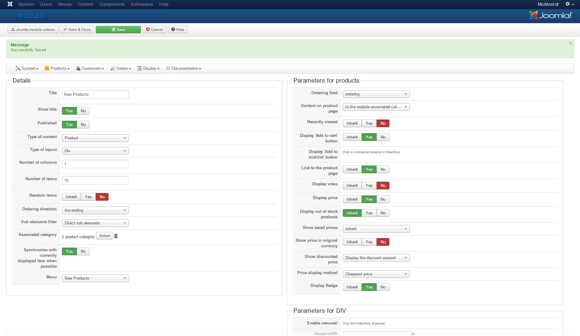

I rebuilt the category tree, but still was not able to set "New Products" as the category for the module.
No error messages were displayed, I've pasted the database queries below, does this help at all?
I've also attached a screen shot of the module settings, just in case I'm doing something dumb.

  • Posts: 85792
  • Thank you received: 14084
11 years 11 months ago #163465
Looking at the debug data, it just seem that you didn't select another category in the category selection popup.
Can you make sure that you click on the + icon of the "use" column of the categories listing in the popup ? Normally, it should close the popup automatically and refresh the associated category with the one you just selected and then when you click save it will be saved in the database.
  • Posts: 8
11 years 11 months ago #163474
Thanks Nicolas,
The associated category is definitely set to "New Products" before I click the save button, but afterward it has reverted to "Product Category". Is it maybe a javascript issue? I've attached two screen shots just to be certain we are talking about the same field.
  • Posts: 8
11 years 11 months ago #163475
I know this would be an awful hack, but just to get me out of a spot is there anywhere I can update this value directly in the database?
  • Posts: 85792
11 years 11 months ago #163547
Then you should have the same problem with any of the settings of the module, not just this one.
Do you have the problem with other options ?
This would indicate either a server configuration issue, or a user session glitch.
Please first try with another browser, maybe it will help.
Otherwise, change the same option in the configuration and create a new module. It should directly have the category from the main configuration.
  • Posts: 8
11 years 11 months ago #163594
Thanks for your help. I tried it in IE (have been using Chrome) and got the same error. I also tried changing the setting for "Display add to cart button" to inherit, and this worked fine. Can you just elaborate on what you mean by "change the same option in the configuration and create a new module. It should directly have the category from the main configuration", I'm not clear on how to do that.
11 years 11 months ago #163621
You have to set the desired category in Configuration > Display > Modules main default options, option "Associated category".
This way, when creating a new module, it will get the selected category in the main configuration by default.
  • Posts: 8
11 years 11 months ago #164353
OK, that works! Bit of a cludge but gets me out of a spot. Thanks for your help.
