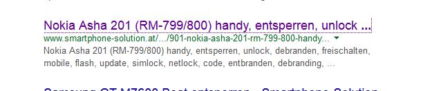

is it also possible to change the "Product not found" pages? - because on google some old sides are indexd - sent them the new sitemap, but it takes a while to recognize that...

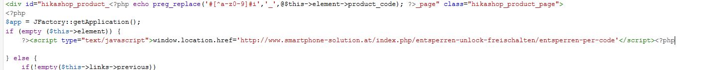

You can potentially edit the view "product / show" and instead of the code:
$app->enqueueMessage(JText::_('PRODUCT_NOT_FOUND'));
Put custom code to redirect to the desired page, something like:
?><script type="text/javascript">window.location.href='Your_custom_location.html'</script><?php

if i remove the first line
and set it to
?><script type="text/javascript">window.location.href=' www.smartphone-solution.at/index.php/ent.../entsperren-per-code '</script><?php

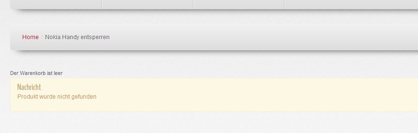

i get the website without any text inside - just navigation path

This would mean that the modification hasn't been done correctly
Could you do a screenshot of the page where you changed the code of the view ?

11 years 11 months ago #162785
Here a Outdated Link:
www.smartphone-solution.at/index.php/nok...netlock-entsperrcode
and in the attachment the things i changed

The modification is correct as far as I can see. I don't see why it would create an error.
Could you do the modification again and turn on the error reporting and debug mode options of the Joomla configuration and if you have again the problem, see if you have an error at the bottom of the product page ?
