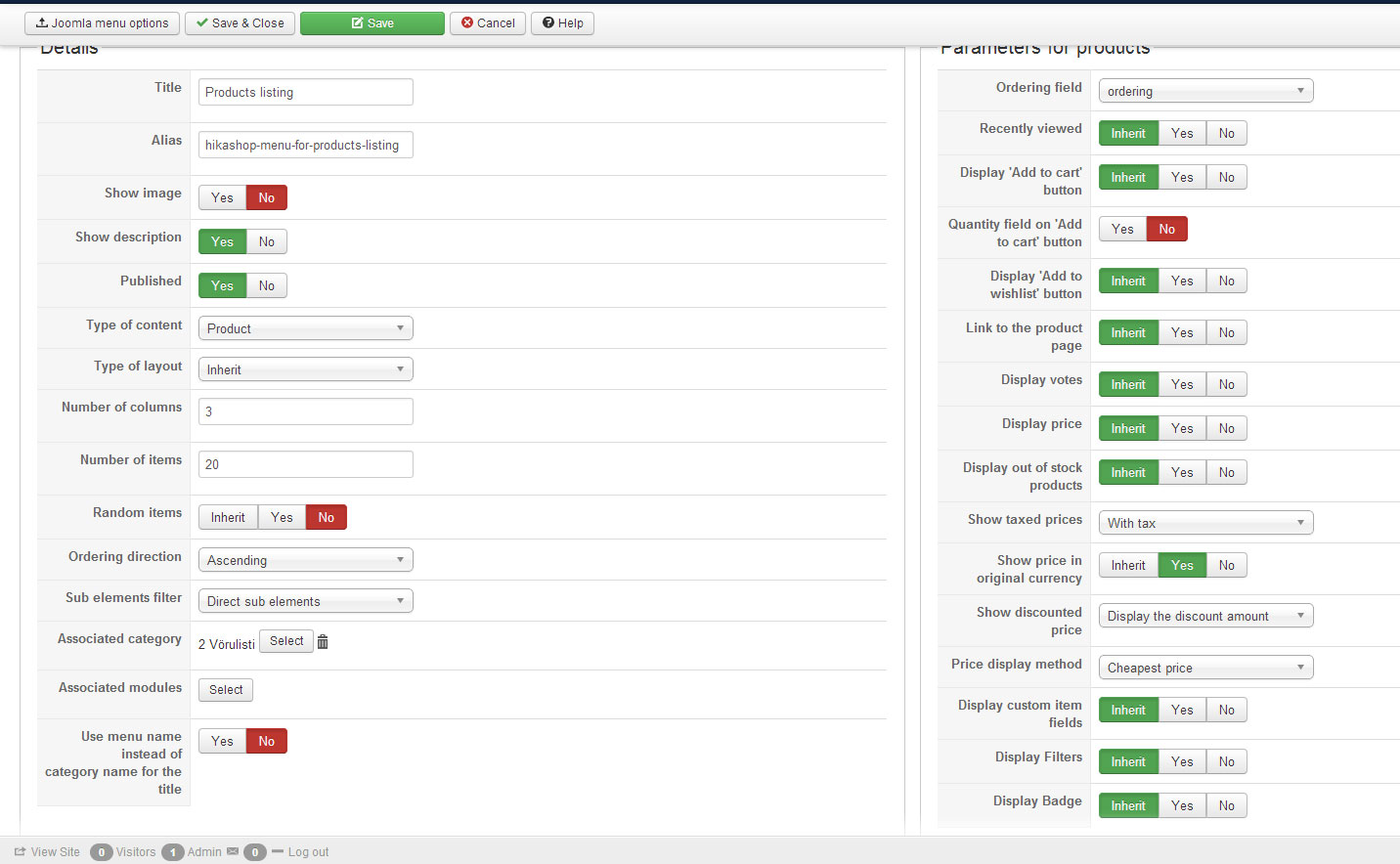

I've attached a screenshot of the product listings menu. I don't see a module associated to it...
The Mega Menu devs are taking a look at the site. If they don't come up with anything I'll look into redoing the whole setup.
11 years 11 months ago #163696
Don't you have created a products listing module, and assigned this module (via the Joomla options) to the product listing menu or "on all pages" ?
