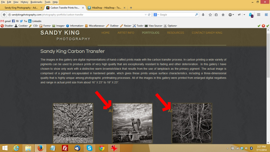

-- url of the page with the problem -- :http://sandykingphotography.com
-- HikaShop version -- :1.6.0
-- Joomla version -- : 2.5.22
When I click on Portfolios and then click on the Carbon Transfer thumbnail the products display correctly. However if I click on Carbon Transfer from the drop down created when you hover over Portfolios the product titles are all messed up as highlighted in the attached screen shot. I have checked all settings between categories that work and the Carbon Transfer category and all are identical.
Any help would be greatly appreciated.

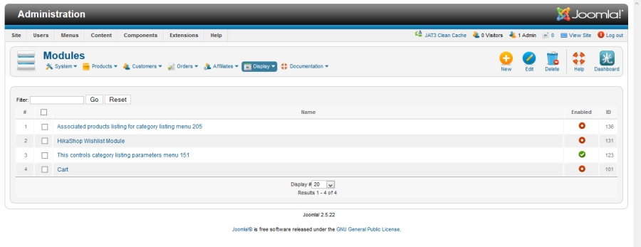

Please compare the configuration of the module "136" (not working) with the module "123" (working) in the HikaShop "Display > Content module" section.

I can't seem to find the modules you refer to. Here is a screen shot of what I do see.

The module id is written in the last column in your screenshot.
136 on first line.

Got it figured out. You guys are great! Thanks for being patient.
