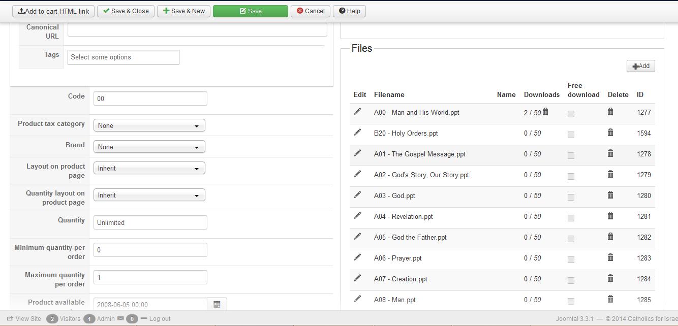

Still, when I add your code, it completely messes up the backend display so that Joomla becomes inoperable. And the notification email continues to display the download links in an apparently random order (see attached). How to order them alphabetically?

I can see that you didn't enter any name for the files in your first screenshot, so it's normal that the code of Xavier doesn't do anything.
Instead, use that code:
Code:
<?php $product_id = hikashop_getCID('product_id'); $database = JFactory::getDBO(); if(!empty($product_id)) { $query = 'SELECT * FROM '.hikashop_table('file').' WHERE file_ref_id = '.$product_id.' AND file_type=\'file\' ORDER BY file_path ASC, file_ordering ASC, file_id ASC'; $database->setQuery($query); $this->element->files = $database->loadObjectList('file_id'); if(!empty($this->element->files)){ $query = 'SELECT SUM(download_number) AS download_number,file_id FROM '.hikashop_table('download').' WHERE file_id IN ( '.implode(',',array_keys($this->element->files)).' ) GROUP BY file_id'; $database->setQuery($query); $downloads = $database->loadObjectList('file_id'); if(!empty($downloads)){ foreach($downloads as $download){ $this->element->files[$download->file_id]->download_number = $download->download_number; } } } } ?>
That will order the files instead on the filename of the files on the backend.
