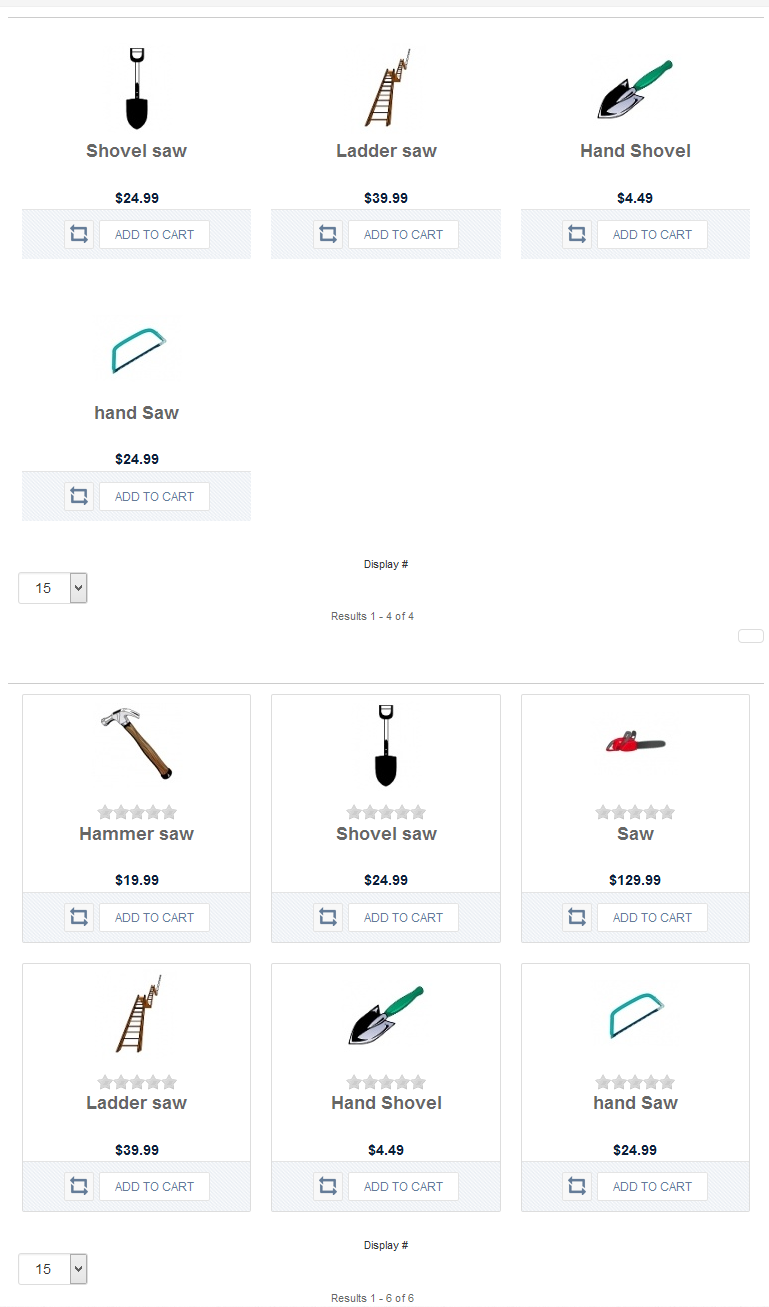

I am stuck on the category and bread crumb issue. I have a 2 category menu that is category and then subcategory. when I go to the subcategory everything is working but when I use the bread crumb to drill back to the parent category I show two different category sets. i have 6 test products total so it seems that the bottom one is correct but I can't get the top one to go away. I only need the parent category to show all of the products available for the site. for some reason it is showing some products at the top then what seem like the correct one all of the products on the site for the second one.

We would indeed need a link to the page in order to be able to analyze the issue.
Please use our contact to provide the link along with a link to this thread.
  • Posts: 85792
  • Thank you received: 14084
11 years 11 months ago #164969
We got your contact request, thanks.
The issue here is that you have a products listing menu item with an associated product listing module. So you get two products listings on the page.
You need to edit your menu item (id 274) via the menu Display>Content menus, and disable the associated module by clicking on the "select" button of the "associated modules" option there.
That will remove the second products listing.
Then, just make sure that you configure the options on that page so that it displays the products you want and not the 4 products that you have now. It could come from several options so I can't say precisely what you do. If you could provide a screenshot of the options of the menu, I should be able to tell you.

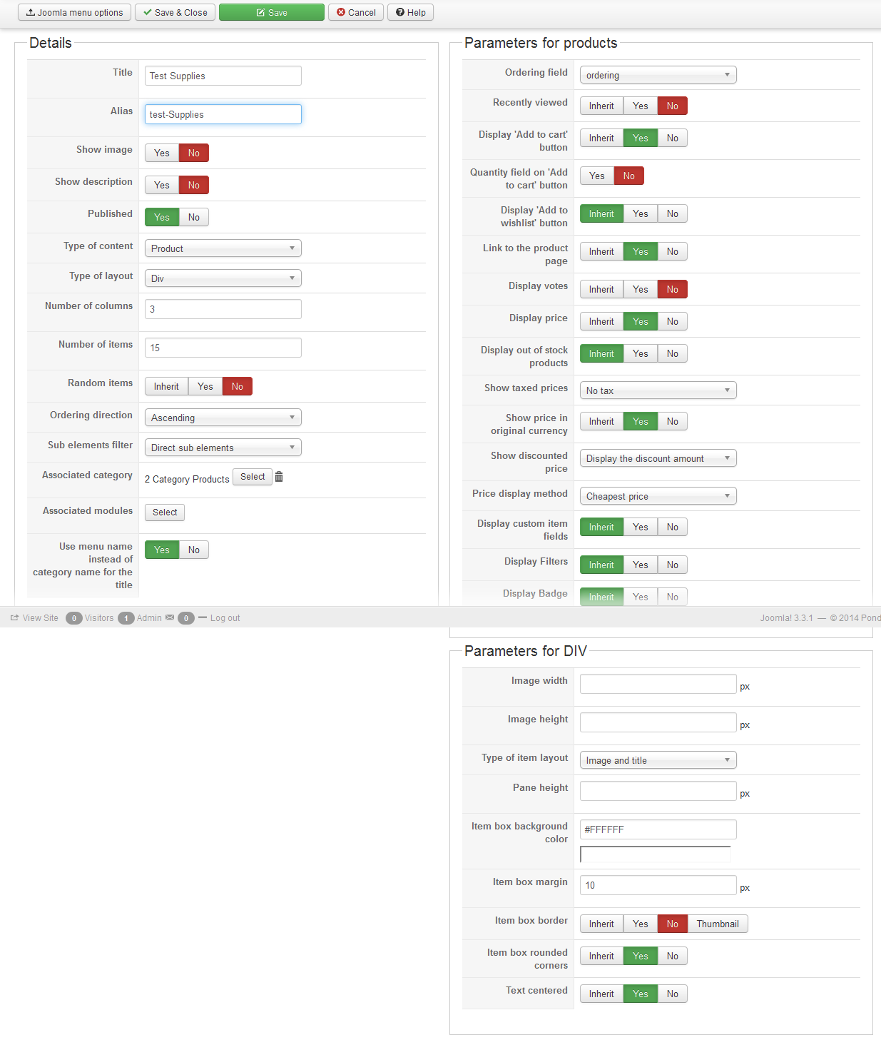

Ok I have done that but if you look at the page again. Now i don't have anything for the sub-menus. If I added the associated module back then I get the products for the sub-menus. My guess it would be hard to tell what going on just by looking at the site now. here is a screen show of my configurations. Let me know if you need more information.

  • Posts: 85792
11 years 11 months ago #165161
Ok, I see what you mean. So what you need actually is to change the "type of content" option of your menu item to "category" and enable back the associated products listing module.
That way, it should work at all the levels.
