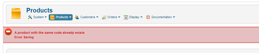

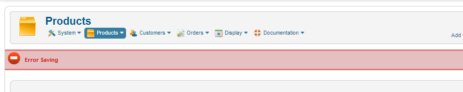

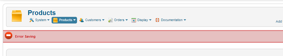

After adding custom fields and assign them to a product category, I can't save the products no more. All other categories that doesn't have custom fields assigned to them, are working fine. First error that I get is: "A product with the same code already exists" . After I change the product code I get a second error: "Error Saving" and the product will not save either way. The product code is correct since if I remove the custom fields, everything works fine again.
Could you please tell me what is the problem?

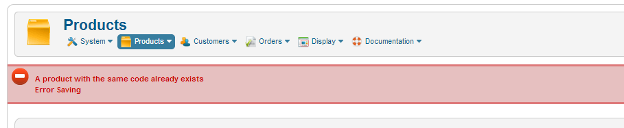

  • Posts: 162

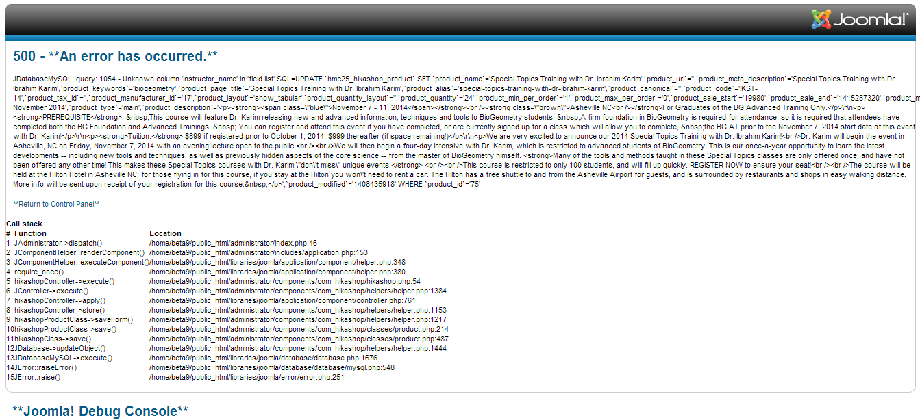

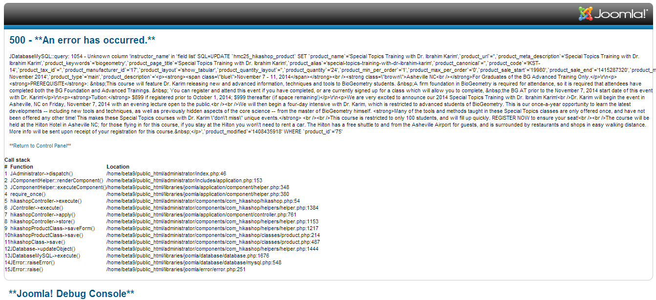

11 years 10 months ago #167968
After I've enabled debugging mode this is what I get. Please see screenshot.
  • Posts: 85790
  • Thank you received: 14084
11 years 10 months ago #168002
This indicates that the "instructor_name" custom field has been deleted from the hikashop_product table in the database.
Delete the custom field via the menu Display>Custom fields and recreate it and that should then work.

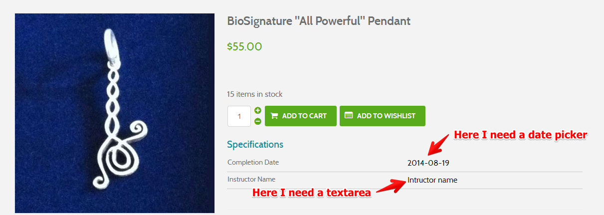

  • Posts: 162
11 years 10 months ago #168174
thanks Nicolas, that worked!
Now I have another problem.

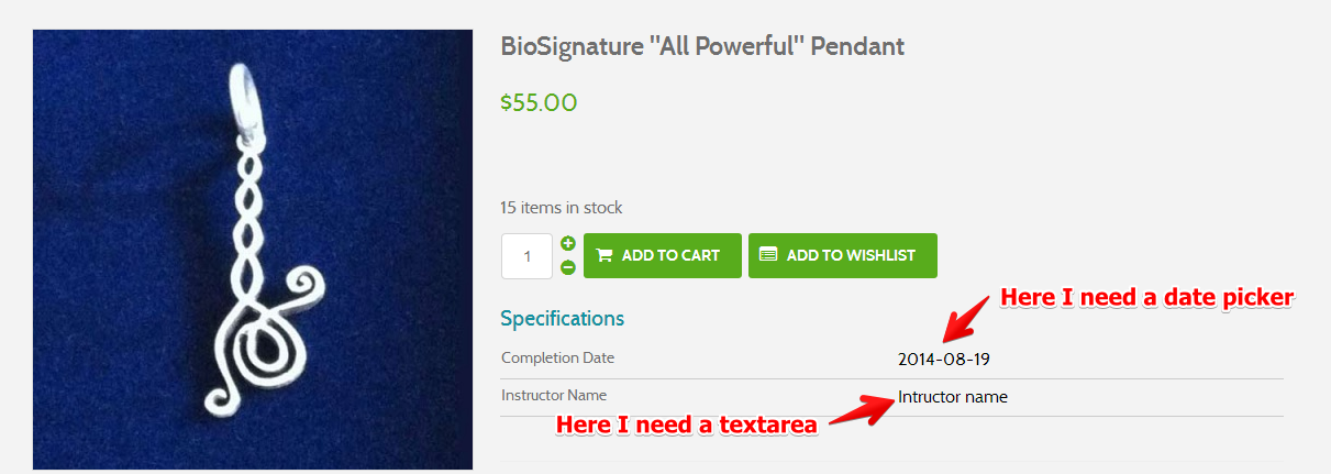

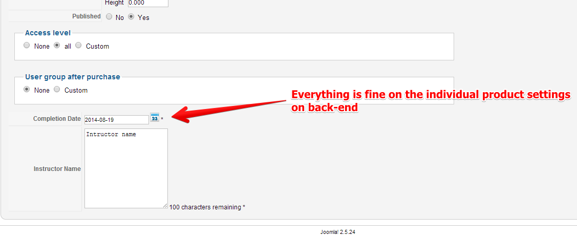

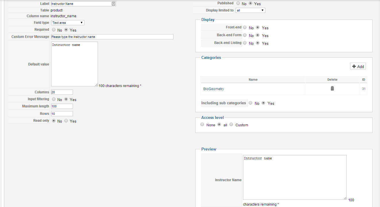

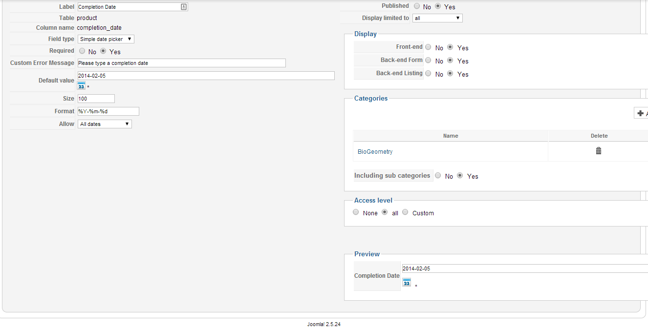

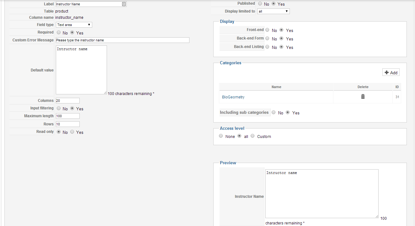

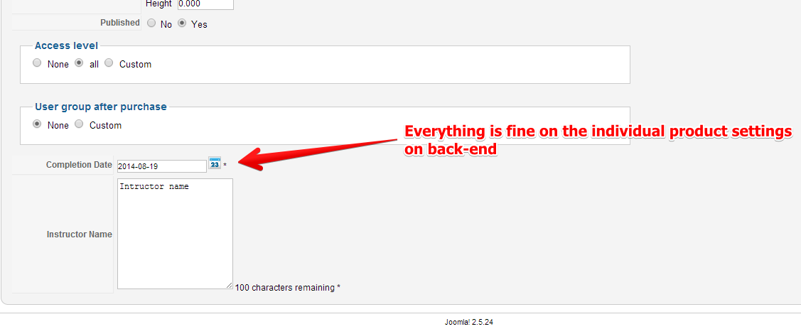

The fields look OK in the back-end but in the front-end all I get displayed is the input that I've typed in the back-end and not a date picker and a text area where users can input data. Please see screen1.

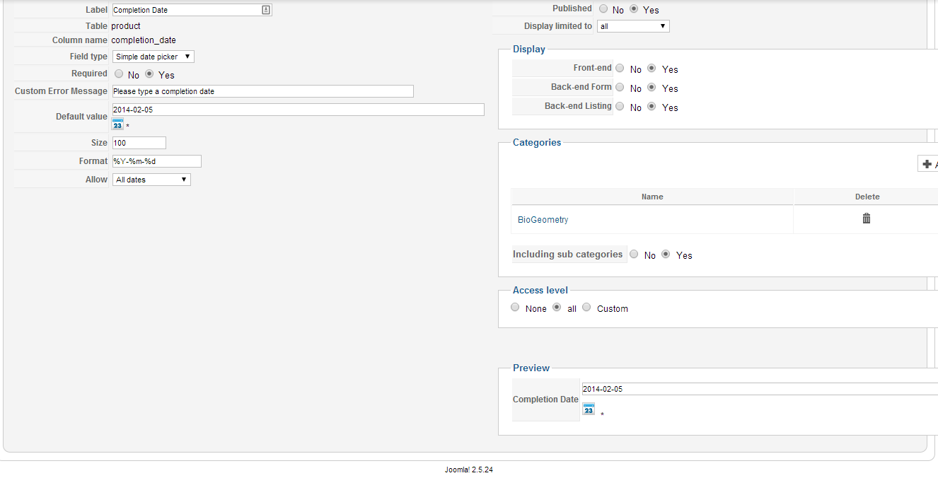

Please see the other screenshots attached for back-end settings.
thanks!
  • Posts: 85790
11 years 10 months ago #168178
You created custom fields of the table "product". These allow you to enter data for the product in the backend and potentially display it on the product page on the frontend.
If you need to have the fields on the product page on the frontend, then you want instead to create custom fields of the table "item".
The following user(s) said Thank You: info@vesica.org
