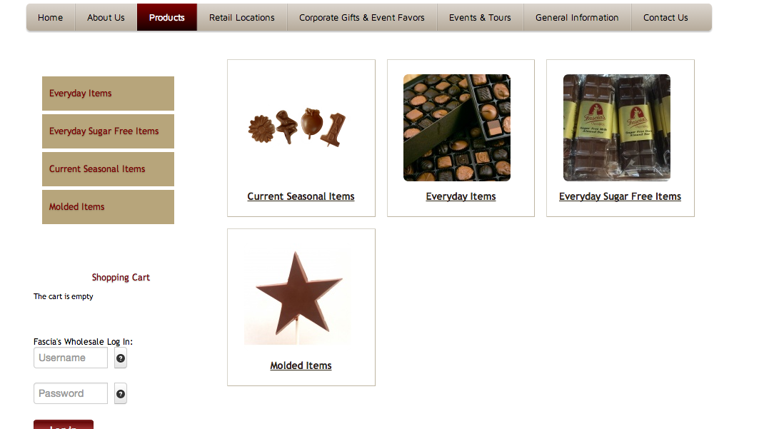

I am trying to have Hikashop run in sales mode with the 'add to cart button' for some categories while other categories (in the same menu) remaining in catalogue mode without the 'add to cart button'.
I have attached a screenshot photo to show you what I mean. In the photo I want the category 'current seasonal items' to run in sales mode so people can add the products in the cart, however the category 'molded items' I want to be in catalogue mode so it looks the same layout wise, but people cannot add the products to their shopping cart.
