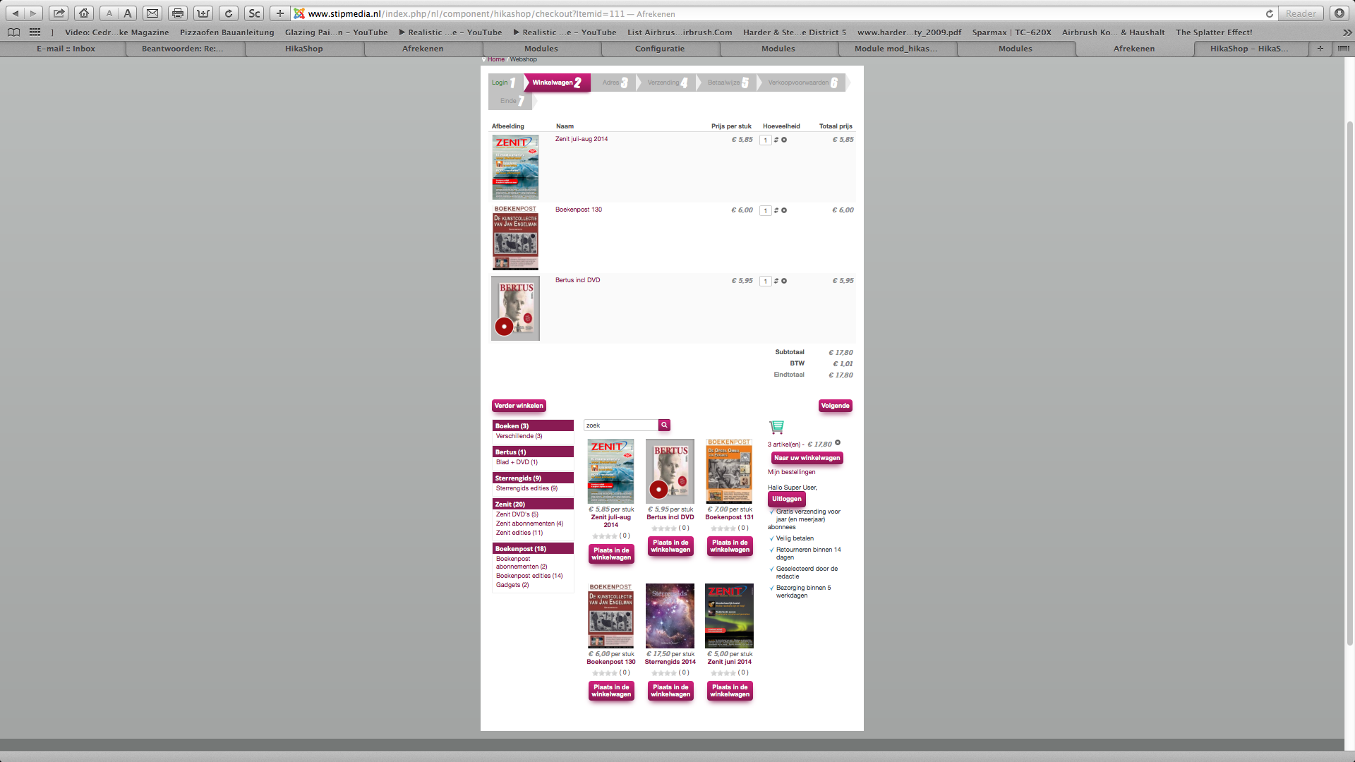

I have a question because the way my shop is setup: I can't figure the following out:
www.stipmedia.nl/index.php/nl/webshop
My joomla Template layout: has a placeholder with the hikashop module:
This exist under a menu item webshop.
when clicked in the front end it goes to webshop page (hikashop).
When I buy a product (see file) in the shopping cart step:
The categorie menu is showed on the left
The little shopping cart is shown on the right.
The other modules Which I don't want to have in this shopping cart step.
Where did I go wrong and how can I solve this?
I only want to have the shopping cart and not the modules below the shopping cart
if you need more info I can understand don't hasitate to ask
Thanks ronald
  • Posts: 85790
  • Thank you received: 14084
11 years 10 months ago #167897
You want to set the "Force menu on checkout" option of the configuration to a hikashop checkout menu item (that you can create via the Joomla menu manager if you don't have any). Then, simply don't check that menu item in the menu assignment tab of your modules and they won't display on the checkout.

11 years 10 months ago #167974
Thank you nicolas
I was digging in php files so I continues to look for this in the php files. :) you saved the day
