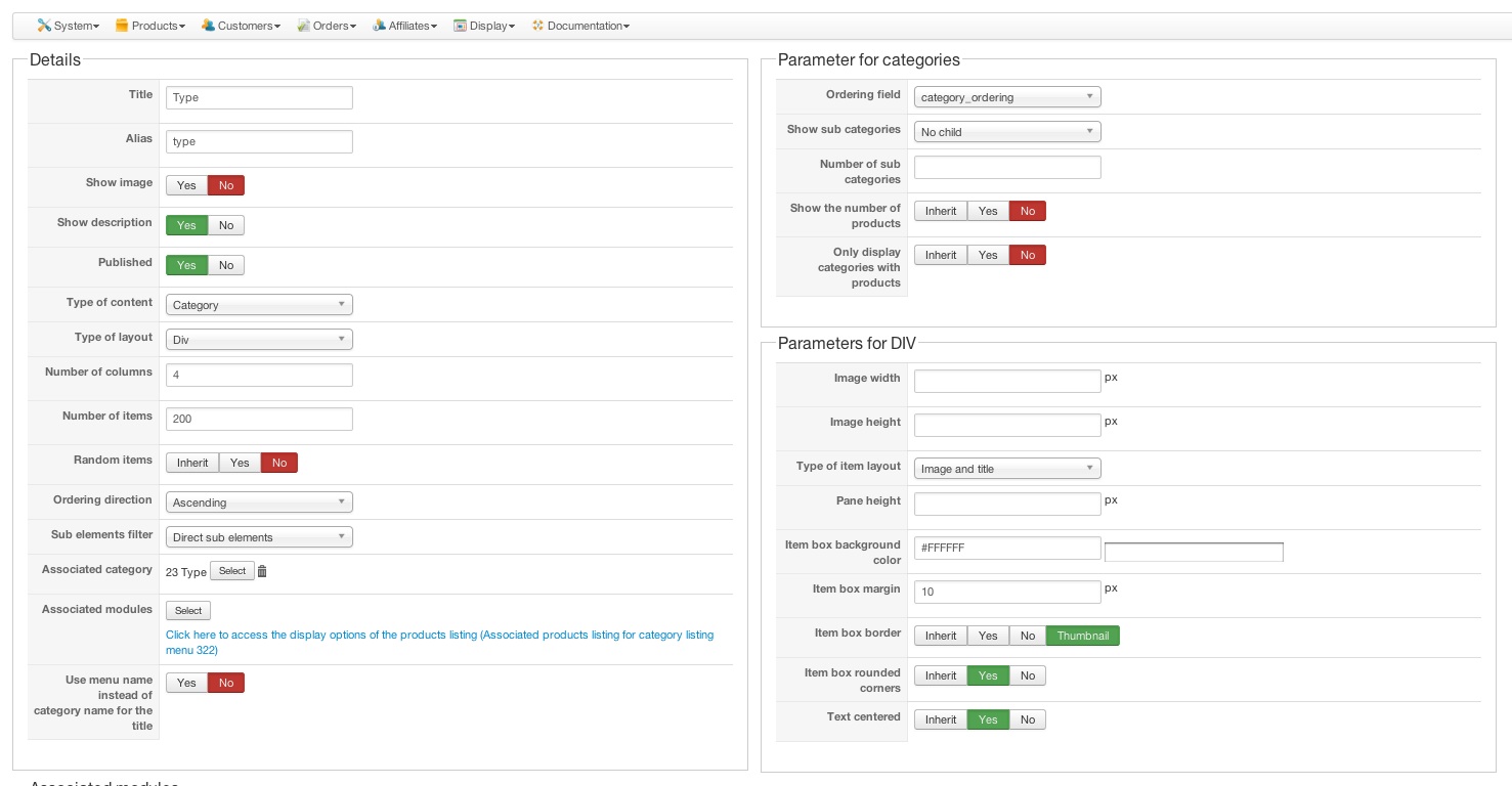

Thank you for the quick reply. However, I do not think this is my problem. On the category that works, I have NO modules associated with it, but it works.
Here is the Category that IS working. You can see that it has no modules associated to it. However, when you click on the category you can see the products:

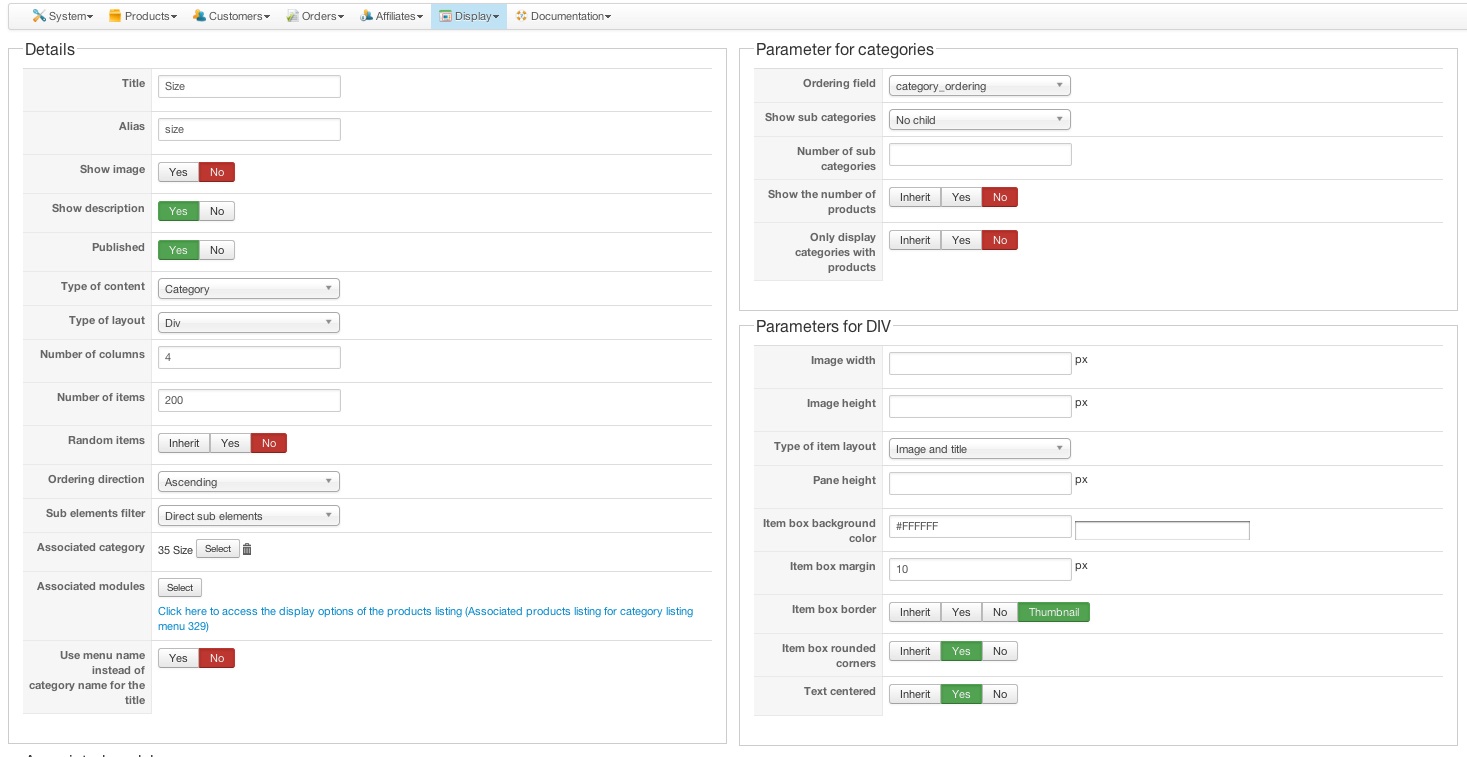

And here is the Category that is NOT working.
Thanks for your help!

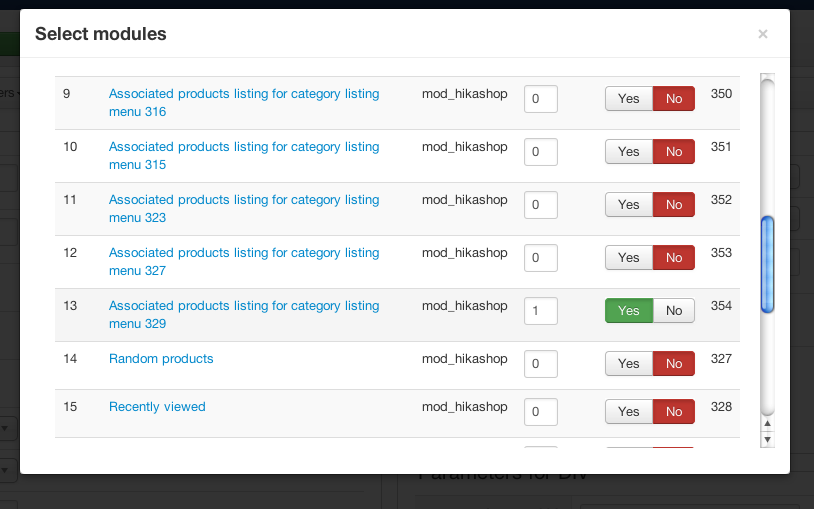

11 years 3 weeks ago #169108
There is an associated module ;)
In the option "Associated modules", you can see that there is a value, in this case the module named "Associated products for category listing menu 322".
So for the non-working listing, thanks to edit the options of the module "Associated products for category listing menu 329"

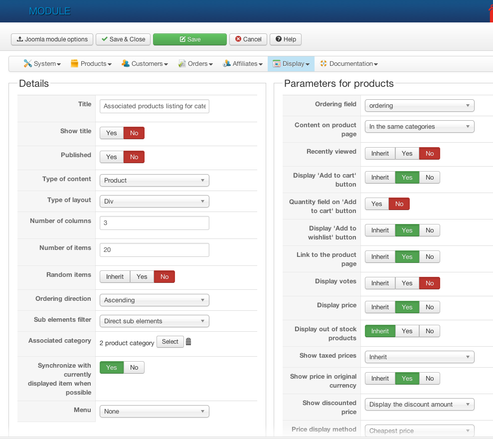

11 years 3 weeks ago #169257
Thank you for the help, but when I edit the module options, it looks like the products are turned on and should show up. See the screenshot...
What am I missing here?
Thanks!
  • Posts: 84315
  • Thank you received: 13706
11 years 3 weeks ago #169286
Yes ! As Xavier said, the problem is with the settings of that module, not whether the module was enabled or not in the associated modules option of the menu.
So you need to click on the link of the module name in order to access the settings of the module itself and check the options of the module (and mainly the sub element filter one as Xavier said, the recently viewed option which should be turned off, the synchronize with current element option which should be turned on etc).

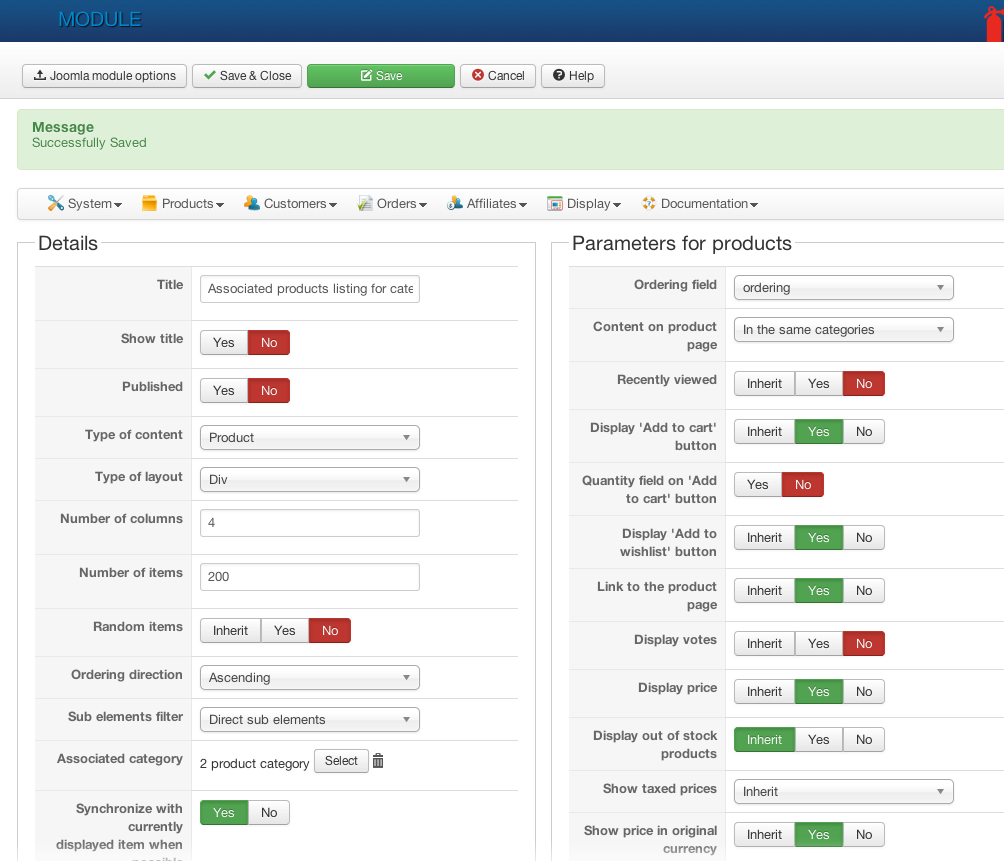

  • Posts: 5
11 years 3 weeks ago #169368
Thank you for the reply, I appreciate your help.
It looks like he module settings are the same for both the working and non-working categories.
Here is the module for the one that works...
Here is the module for the one that does not work...
Just to review. I have a menu item called TYPE. It links to a HikaShop Category Listing. When you click on that menu link, you see the 11 categories inside the category TYPE. When you click on one of those sub-categories you see the products. It works great. I did not change the settings of the HikaShop modules that I know of. So, I copied that menu item and changed the name to SIZE and linked it to the Size category. When you click on SIZE you see the 14 sub-categories inside the SIZE category. However, when you click on any of those sub-categories, it reloads the page, changes the URL and does NOT show the products.

  • Posts: 84315
11 years 3 weeks ago #169375
This looks ok.
