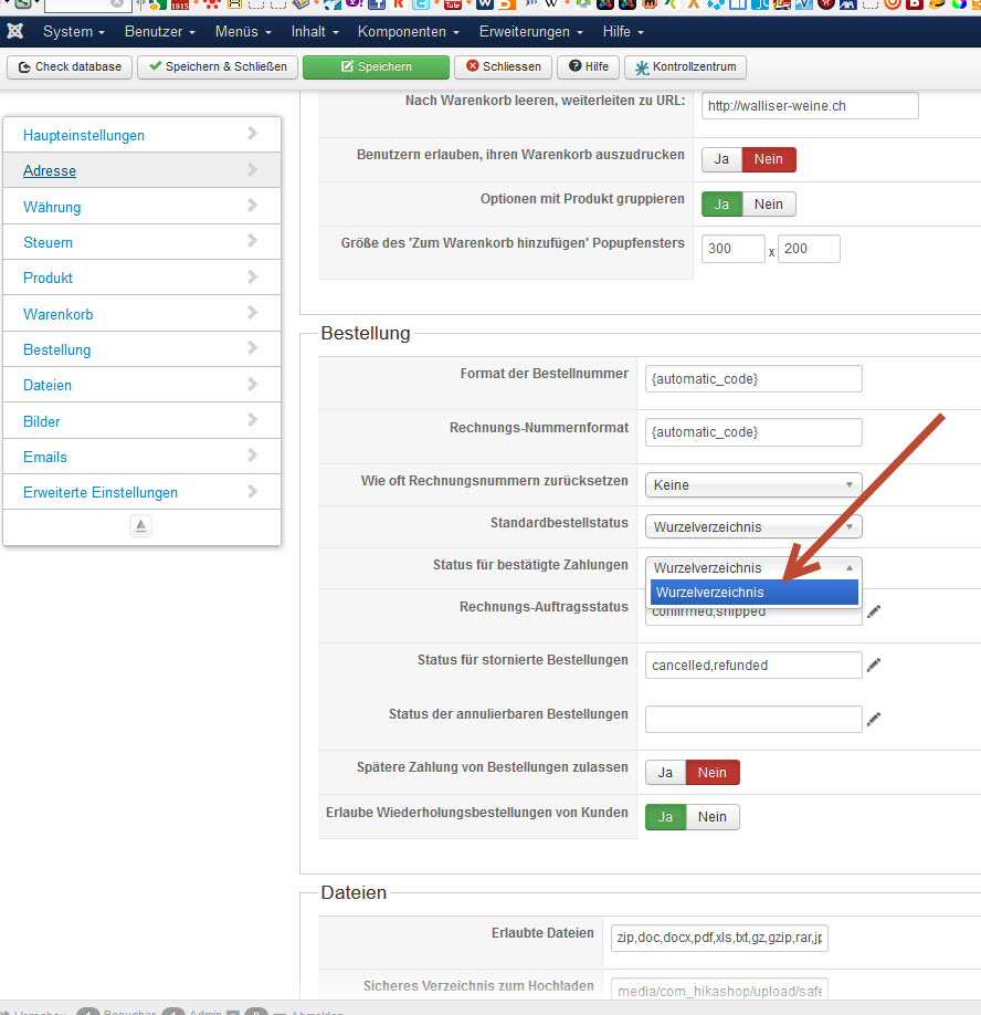

I have missconfigured something and i cannot fix anymore. Because of that, i cannot logout using the SOFORT payment method anymore.
In the orders i can see: your order is ROOT.
I see this also in the main configuration and i am not able to change it.

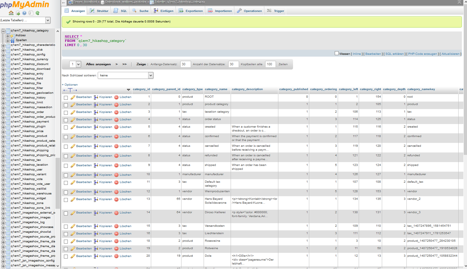

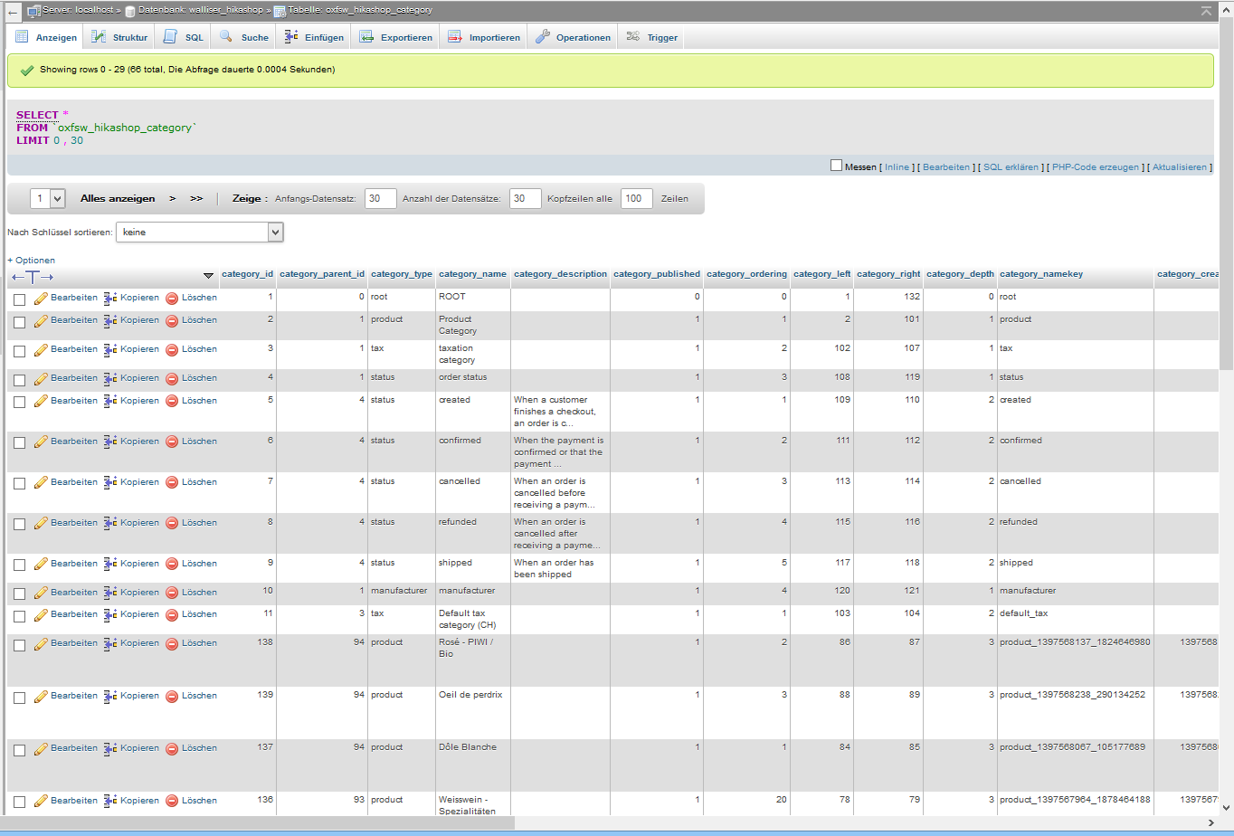

Attached i send you 2 Screen shots of the SQL-DB and HikaShop-category tables.
I cannot see any diffference. I would really appreciate when you could have a look ;)
It would be a big problem and a lot of work when i have to reenter everything. I did not delete anything in the tables.

The database content looks good.

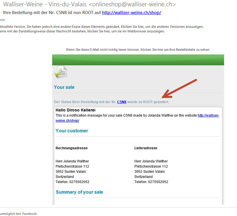

I tried to buy something from Dioroso but i then still get the msg: order status has been changed to ROOT. The Email confirmation is sended as you see in the attachement. Is that maybe causing the problem?

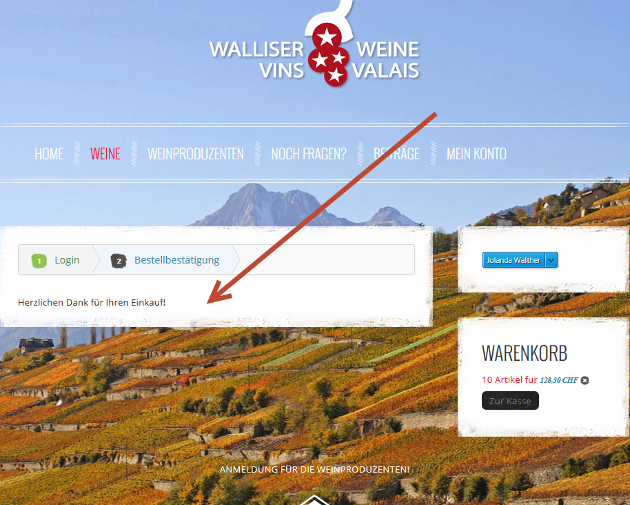

For some reason i am also not goingto be switched tot he SOFORT payment page. Instead i get immediately the msg. "Thanks for your purchase". The only payment method is: SOFORT Überweisung. The order stays in the basket.
So now you can see your order statuses in the backend and you are able to change your configuration to something working.
