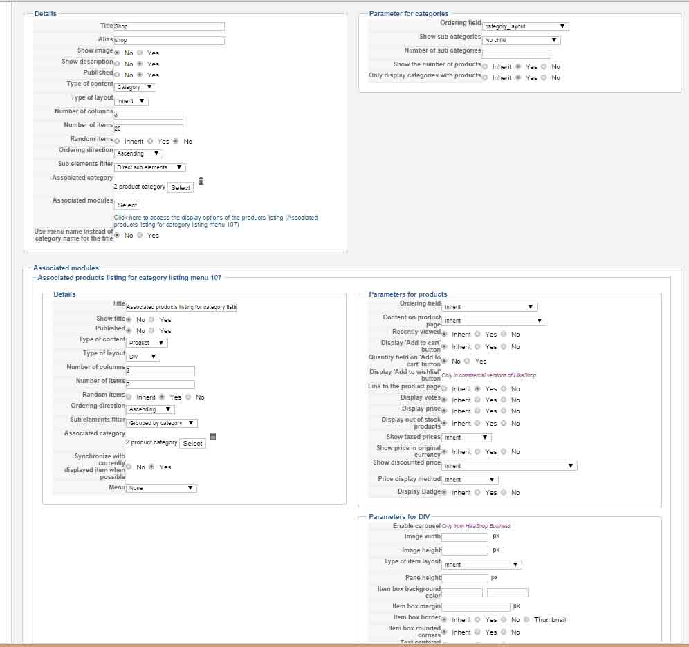

Regarding the products not showing when you click on a category, it means that the options of your products listing are probably not correct. It could come from several settings. Could you go in the menu Display->Content menus of HikaShop, edit your menu and provide a screenshot of all the options ?
  • Posts: 21
11 years 11 months ago #169524
Here is the Shop Menu Item
Thank You,
Teverz
  • Posts: 86079
  • Thank you received: 14186
11 years 11 months ago #169529
Set the "sub element filter" option there to either "all sub elements" or "direct sub elements" and turn off the "recently viewed" option and try again.

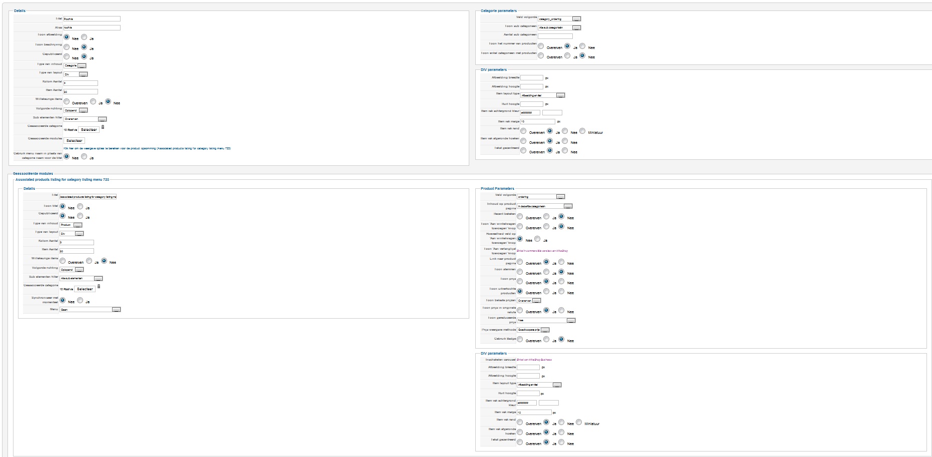

  • Posts: 86079
11 years 8 months ago #183255
Could you redo a screenshot of the options screen of your menu item with a better resolution and with the interface in English so that we could better read how you configured it ? Maybe we missed something else.
