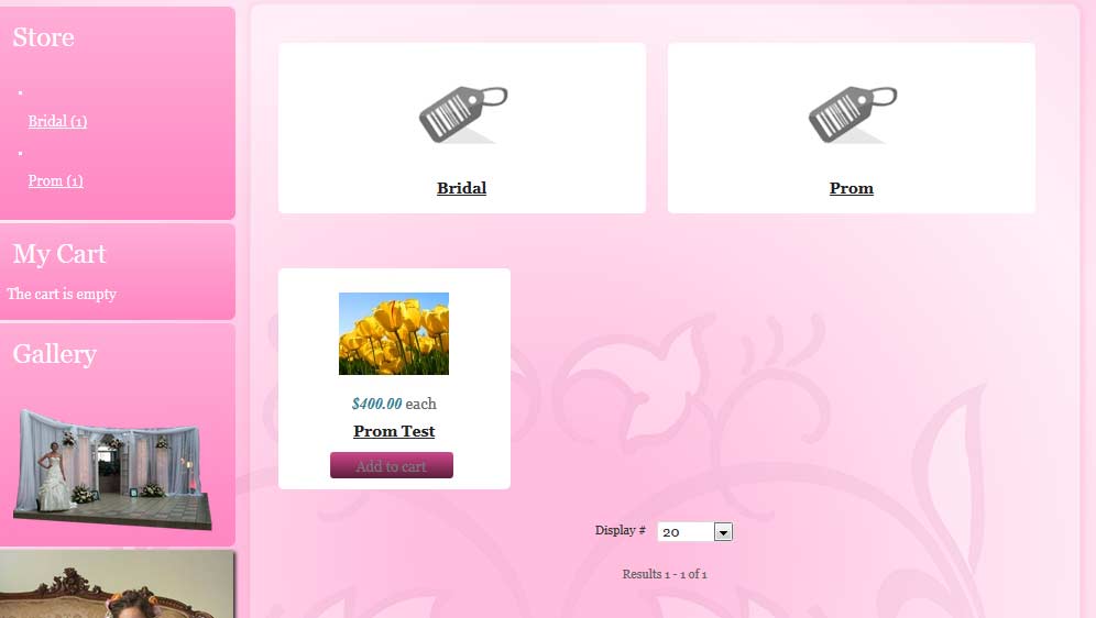

I am trying to just add a menu that lists out all the categories, but it's also showing products under the categories.
How do you turn OFF product display on categories listing menu?

The solution will be to :
- Unset the associated module through the "Associated module" option of the configuration page of the category listing content menu which have the ID number 134 (Hikashop->Display->Content menus").
- Delete that associated module which have the ID number 123.

Hi thanks -
- I found this location, but there isn't an option to "Unset" as described?
- When I delete that associated module which have the ID number 123 , then I loose the product information when you click on the category?

1. You'll just have to :
- Click on select
- Set the "Published" column of each line to NO
- Save
2.
Don't you want you category listing to ONLY display categories ?
