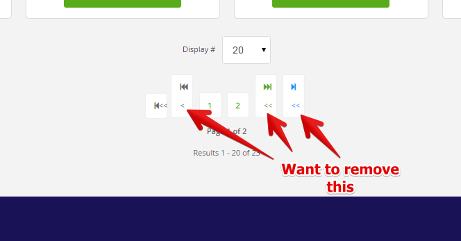

  • Posts: 162
11 years 11 months ago #172674
Please see screenshot. I'm using icon fonts all over the website and I want to remove the html characters.
thanks!
11 years 11 months ago #172680
The pagination can be override using the "template override" system.
www.hikashop.com/support/support/documen...tation.html#override
File : templates/YOUR_TEMPLATE/html/pagination.php
The file should contain the functions :
* pagination_list_render($list)
* pagination_item_active($item)
* pagination_item_inactive($item)
It allows you to override the different parts of the pagination.

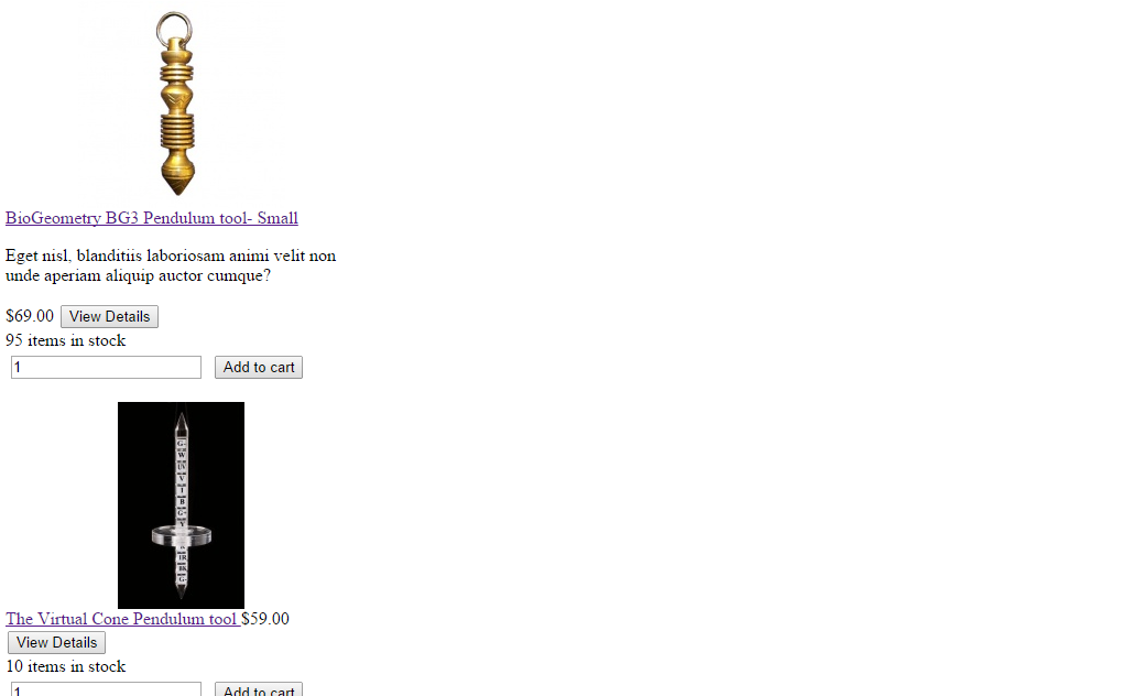

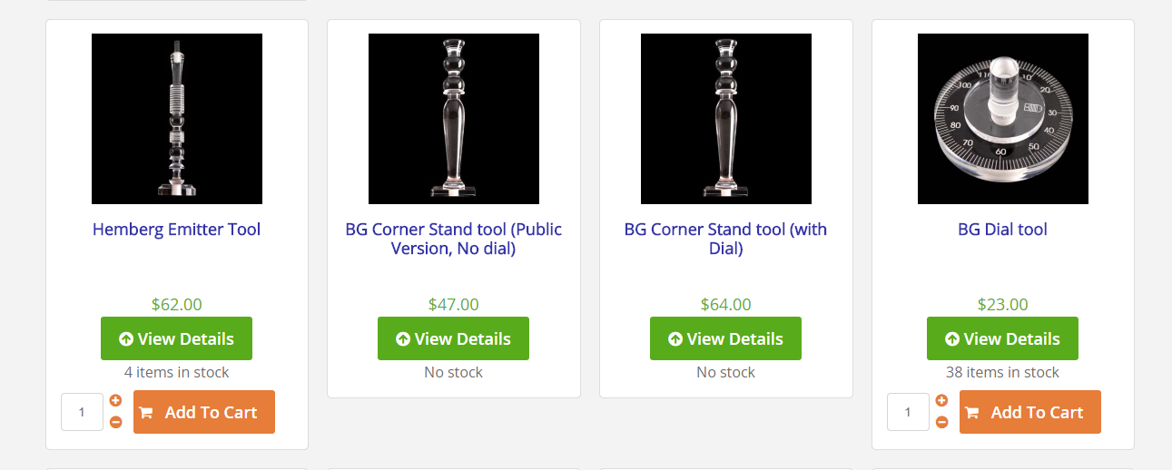

  • Posts: 162
11 years 10 months ago #173124
thank you for your help!
What you're telling me is that I have to do a normal Joomla template override and I should copy the pagination.php from com_hikashop/administrator/helpers to templates/MY_TEMPLATE/html/pagination.php ? If yes, I already did that before starting this tread and unfortunately it breaks the hikashop layout. On screen1 is the layout as it should be and on screen2 is the layout after pagination override.
thanks!
11 years 10 months ago #173157
If you have such kind of page it means that your have a PHP fatal error.
Please check your PHP error log.
  • Posts: 162
11 years 10 months ago #173270
This is the error:
PHP Fatal error:  Cannot redeclare class hikashopBridgePaginationHelper in /home/beta9/public_html/templates/rt_anacron/html/pagination.php on line 196
Could you please tell me how do I fix it?
thanks!
11 years 10 months ago #173342
It looks like you put the class hikashopBridgePaginationHelper in your pagination.php file but you just have to put the function I listed and just that function (no class).
