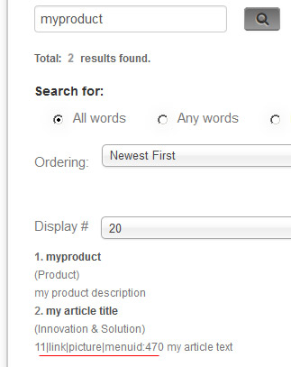

11 years 10 months ago #174025
Hi, I'm sorry but probably I didn't explained well this issue:
your patch hides the product description on the products records that comes as results of the search,
but the problem isn't on the product records, but in articles records that contains the code.
When the search lists one of these articles it doesn't parses (or hide) the plugin, but let the user view the raw ugly code.
I've attached a screenshot of the typical result when the search find both the product and also an article that contains the product code.
11 years 10 months ago #174119
Oh... Right, I see.
Ok then, you can use the trick that Nicolas gave you in your articles, so you will add an "<!--" and " -->" to hide the content in most cases.
