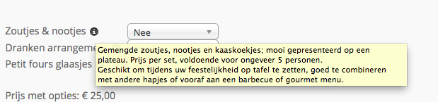

When showing options for a certain product, there's a 'i' next to the option-name. On your demo website, one can click on the 'i' and a popup shows the extra info. How to realise that, because now, on my site, the info is only showed when I keep my mouse on the 'i', but it's not a popup.
