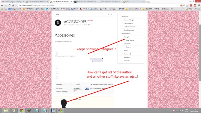

Regarding your display questions, I checked your link but it is very different from your screenshot.

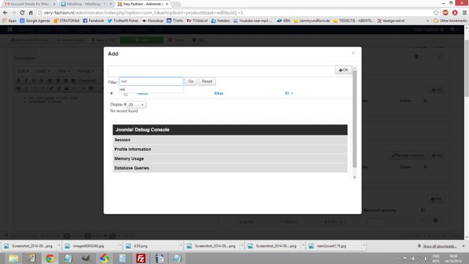

  • Posts: 30
11 years 10 months ago #175578
Hi again,
first of all sorry: I messed up with a wrong screenshot.
My problem (better clients problem;-) is that if we try to add a new characteristic to a product:
1. select and open product
2. press the +add btn
Then a window opens...and we want to add a second color - say 'red'
and then: neither on the GO or +OK btn happens anything except at +OK a popup saying 'make choice'
But there is no choice :(
I am new to hika shop as I never used it before (in earlier joomla versions mostly virtuemart or other) so I am desperate looking where I go wrong?
I also would be glad to give you a temporarily access to the admin of the site. (in cae: by private message or mail?)
In
  • Posts: 30
11 years 10 months ago #175619
ai ai ai - shame on me!
I overlooked to make a value first:
Menu: products/characteristics/new...
:oops:
