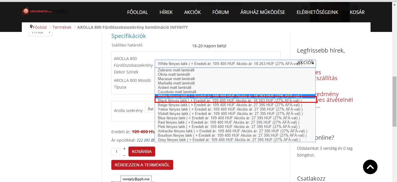

Hi!
I have a problem setting up the options of the product. When a product has only one price, it is ok, the problem is when it has a reatil price as well, both prices are shown in the select field.
How can I avoid it?
Here is the link:
http://teszt2.honlapkeszitespecs.hu/hikashop-menu-for-products-listing/product/858-arolla-800-fuerdoszobaszekreny-kombinacio-infinity
Thank you!

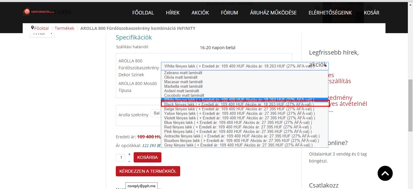

  • Posts: 24
11 years 10 months ago #175646
Hi, Mohamed Thelji!
Thanks, but I think if I add that css I will remove the original price from everywhere, and that is not what I want.
I would like to remove it only from the select field.
I have attached a screenshot.
Thanks!

11 years 10 months ago #175689
Please replace the file components/com_hikashop/views/product/tmpl/option.php with the one in the archive enclosed and that should fix that.
