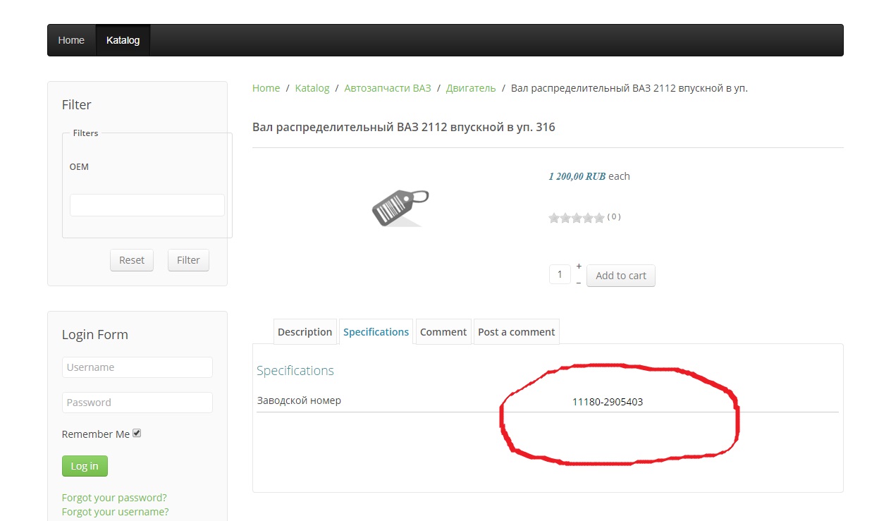

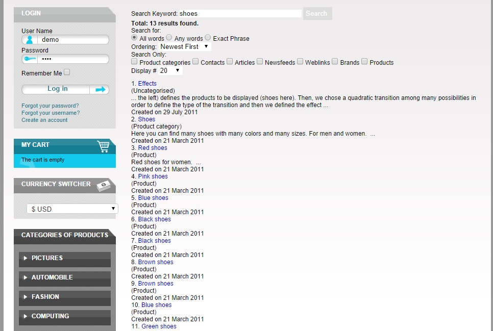

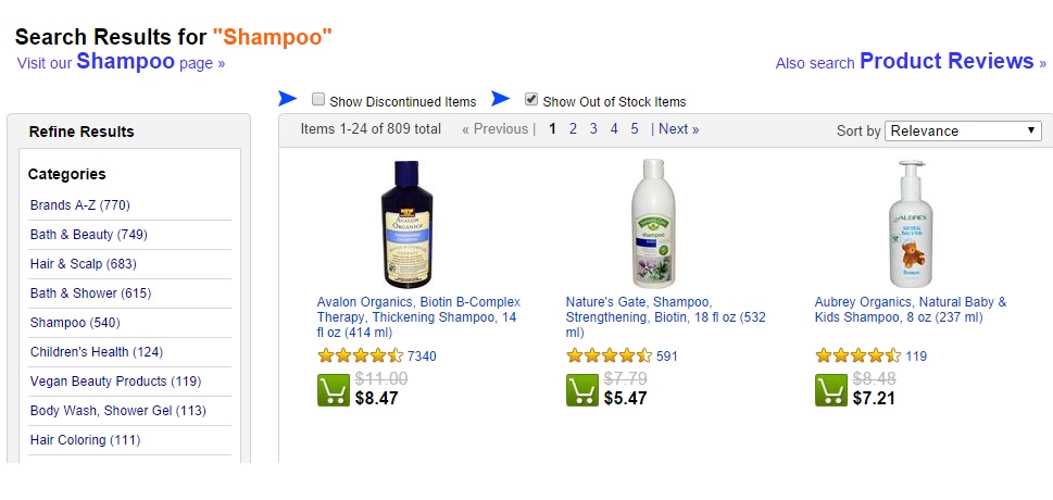

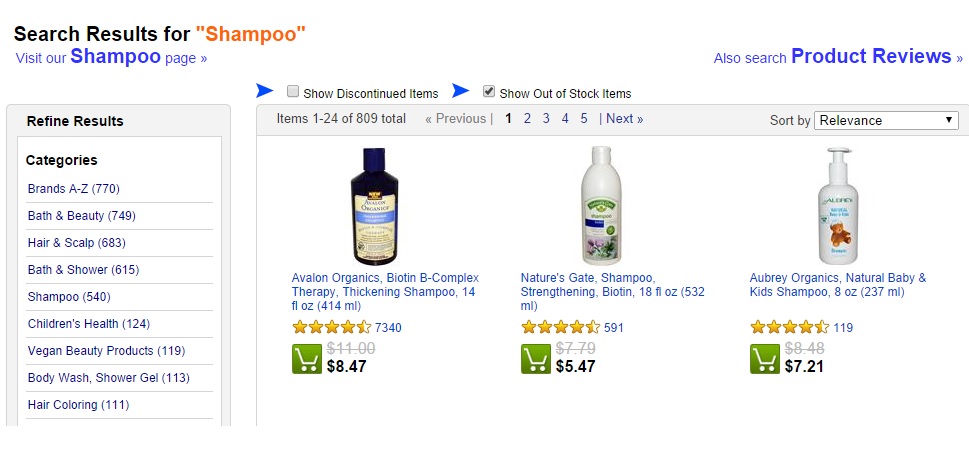

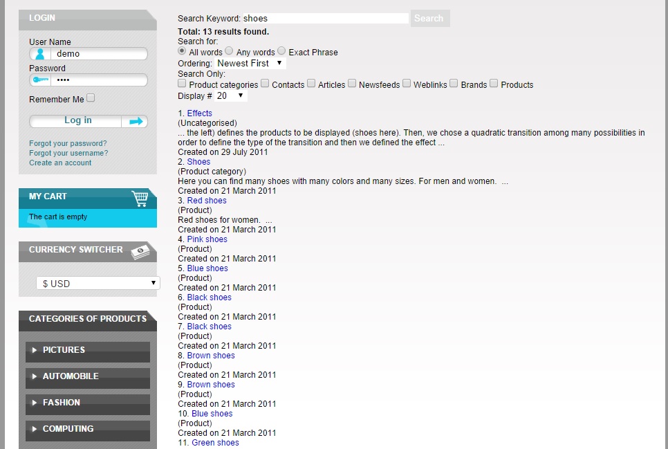

Search result list as in the materials Joomla bad usability for a store.
not seen product code, custom fields, image and much more.
foto1 as now, foto2 as we would like in the future.

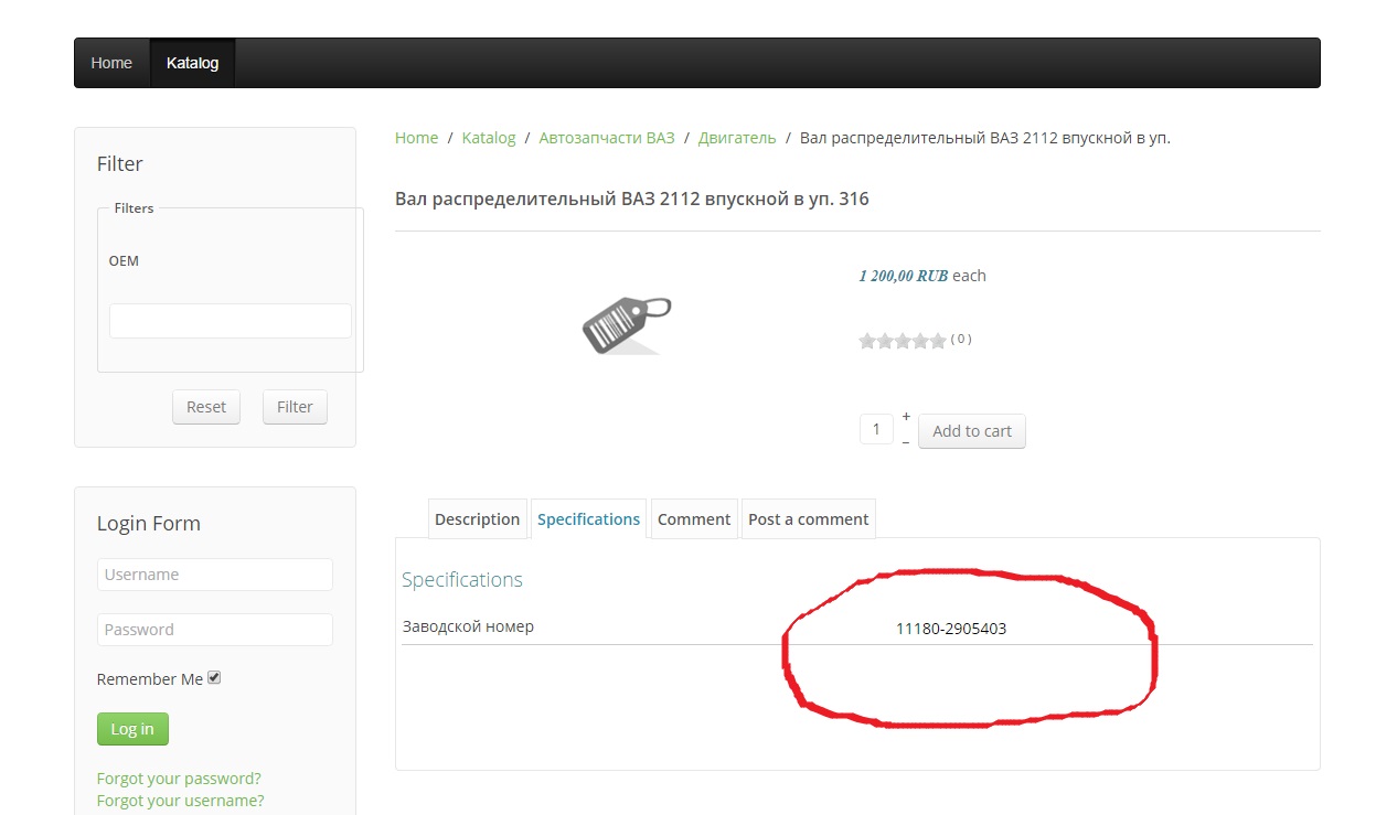

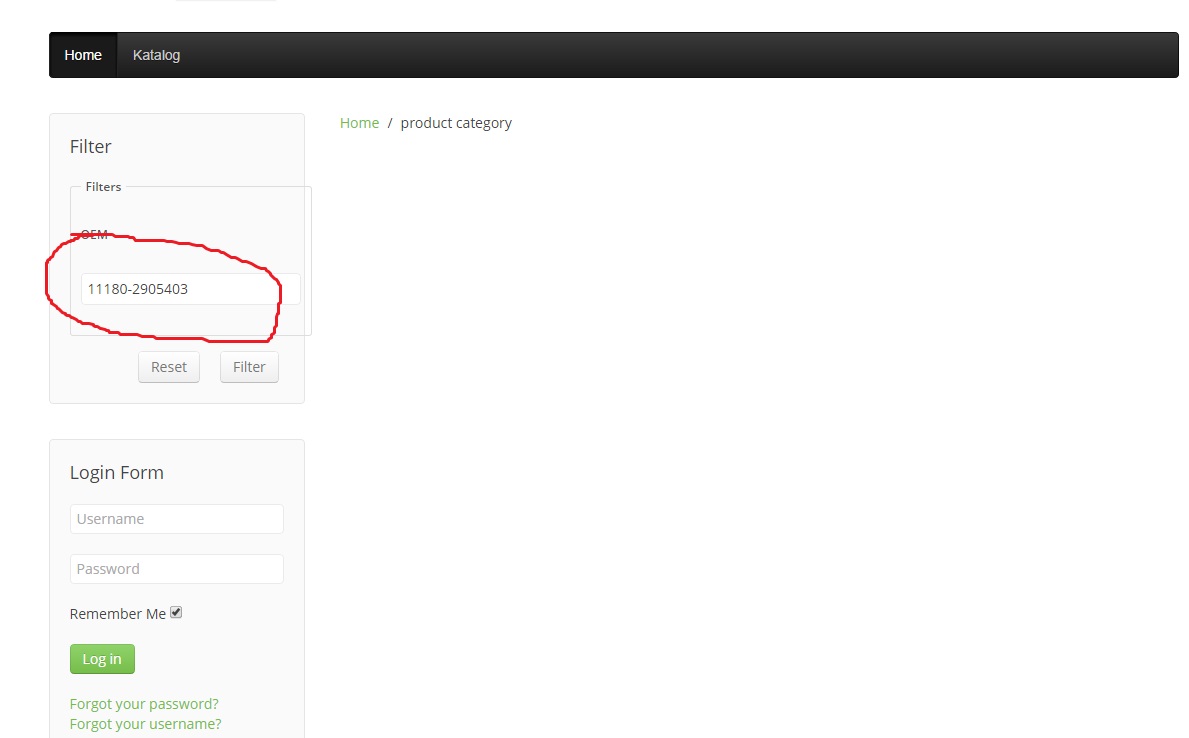

11 years 10 months ago #175663

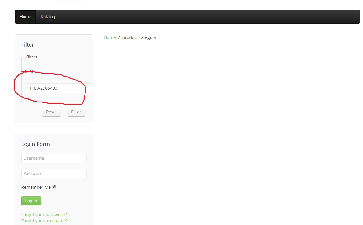

The filters does not work with custom fields not just me

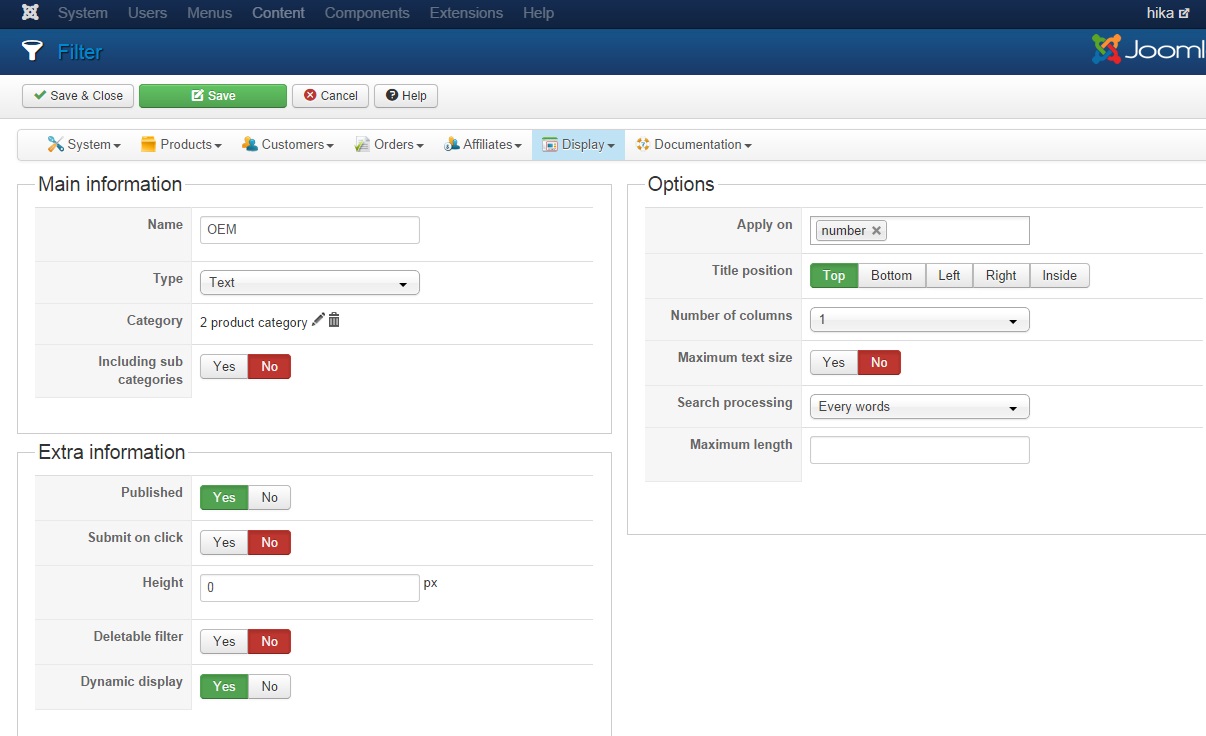

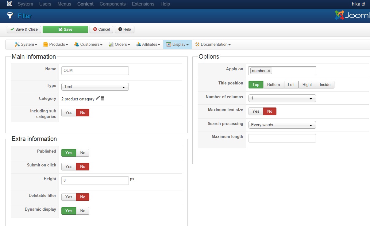

Could you give us a screenshot of how you configured your filter ?
  • Posts: 4
11 years 10 months ago #175772
well here screenshot
Last edit: 11 years 10 months ago by andrey_ka.
11 years 10 months ago #175793
So your custom field "column_name" is "number", right ?
And your products are all in the category "Product category" no in sub categories ?
If they are in sub categories, you have to enable the option "Including sub categories".
You can too try to change the "Search processing" value.

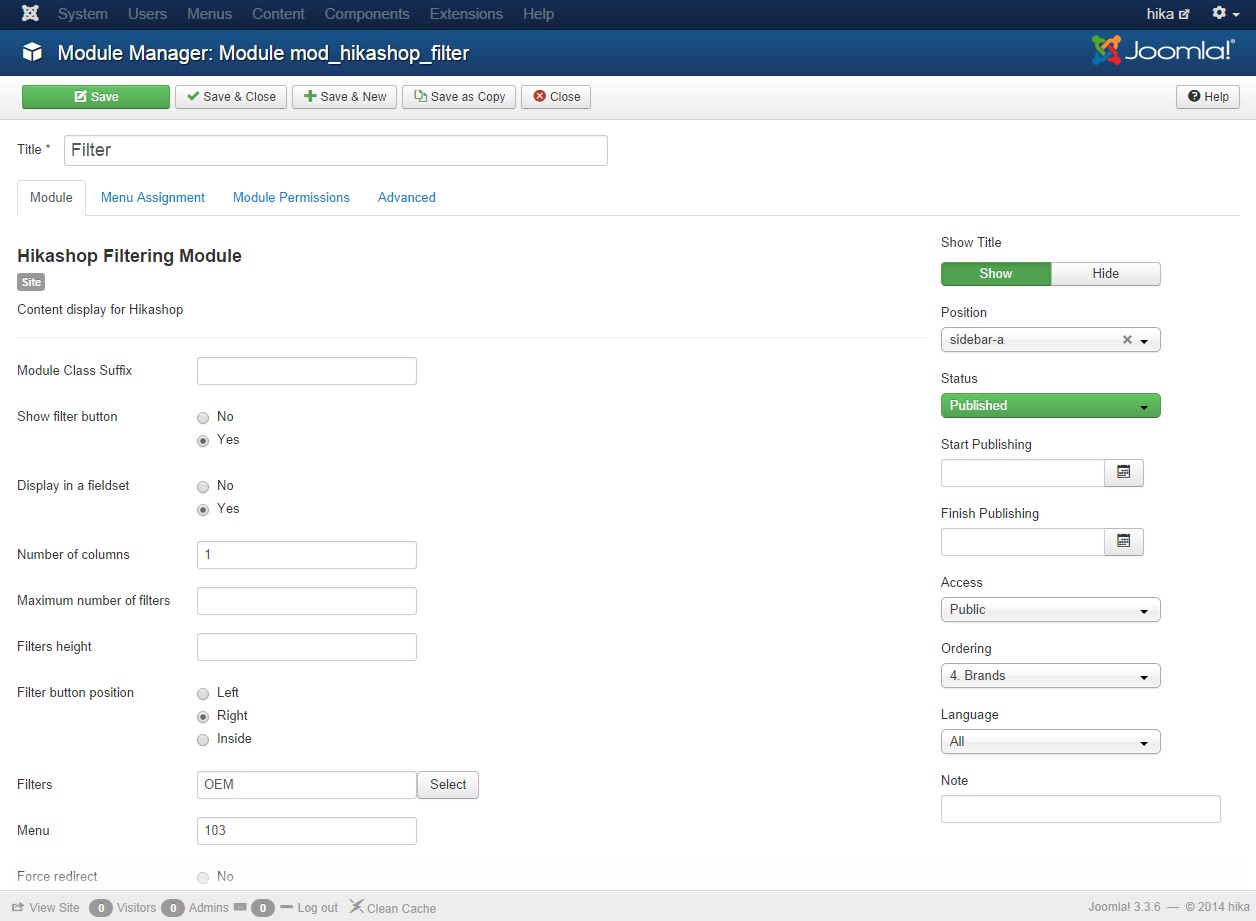

Regarding the menu with the id "103", is it a listing menu which allow to list all the available products in your shop (from all categories and sub categories) ?

11 years 10 months ago #175936
Yes my custom field "column_name" is "number"
I tried all options the "Search processing" value
nothing has changed.
the menu with the id "103" disabled

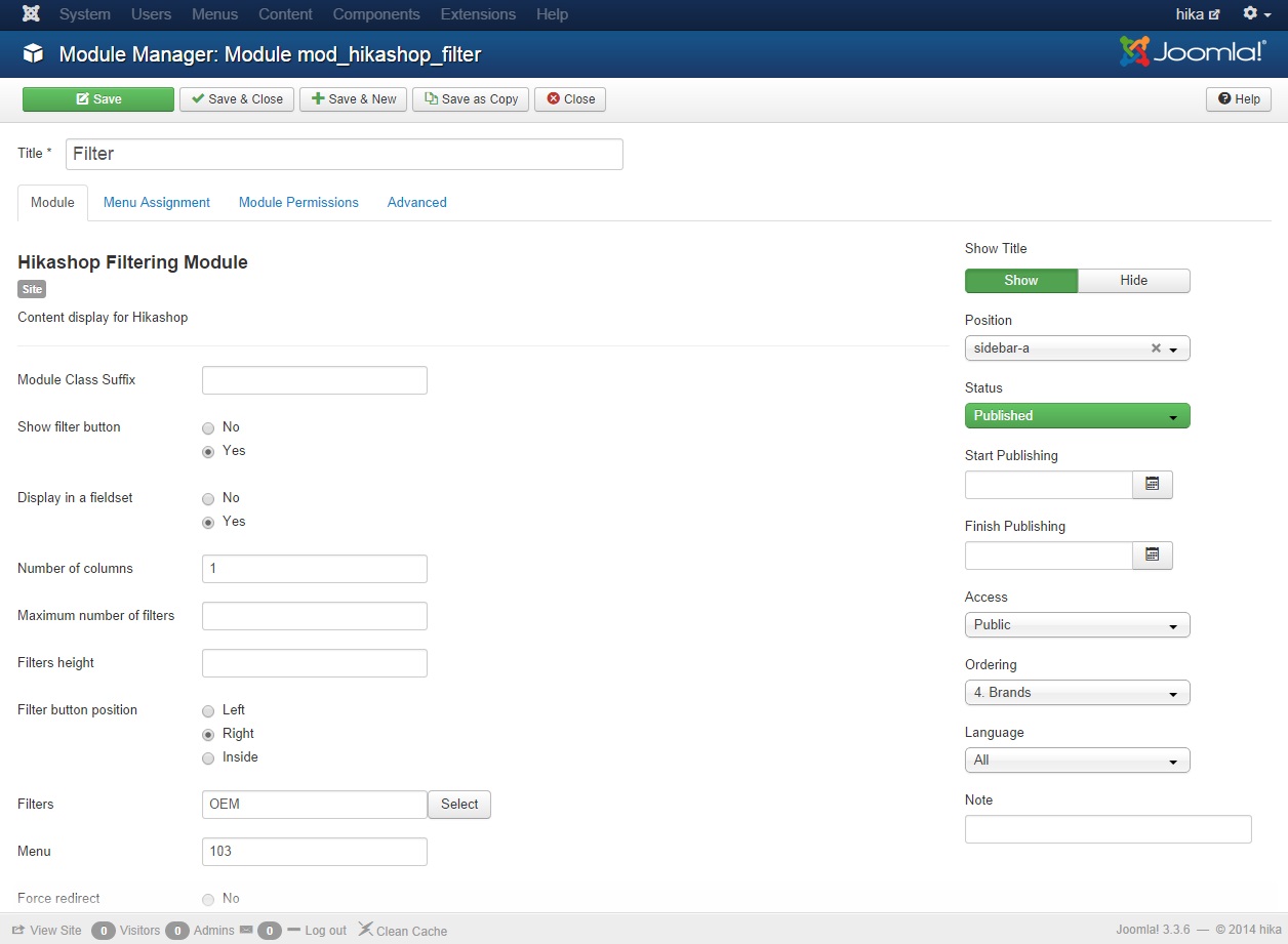

11 years 10 months ago #175938
I really think that your issue is due to the menu with the id 103, please try another one, a published one and it must allow the listing of all the products of the shop.
