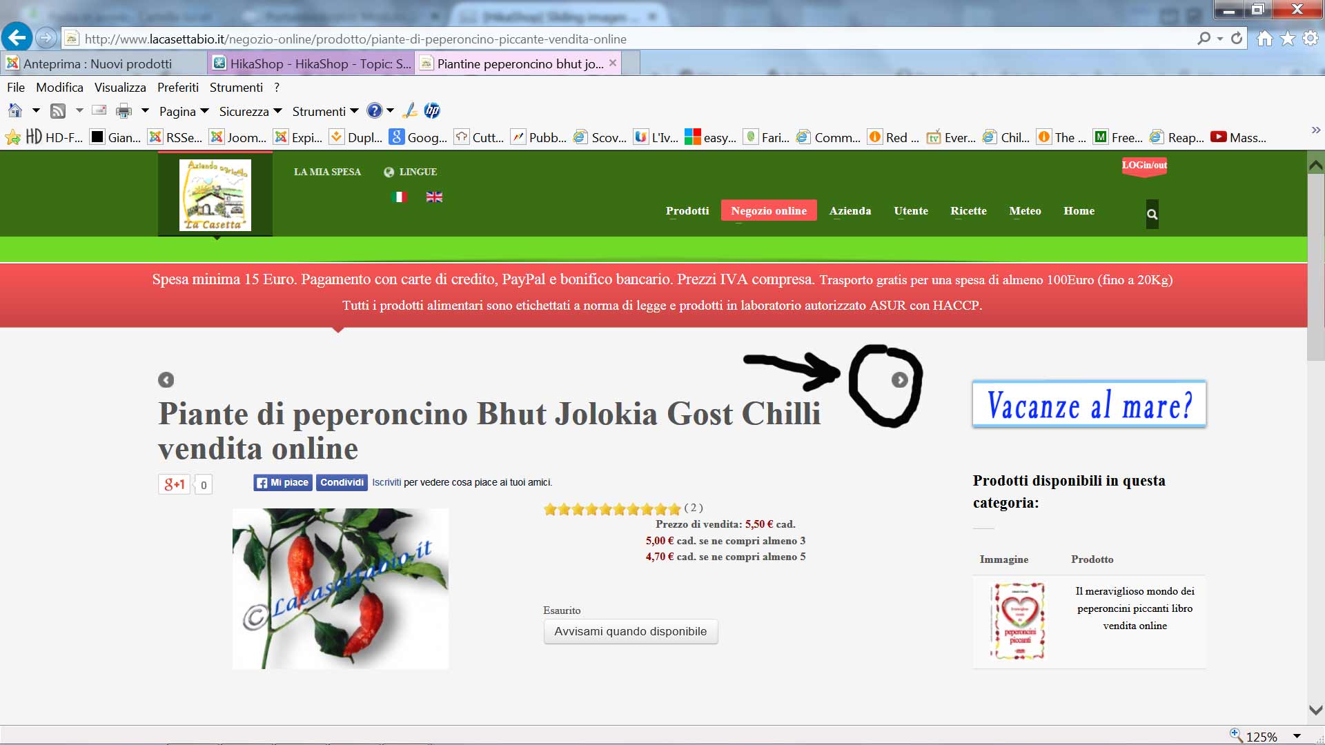

  • Posts: 719
11 years 10 months ago #175656
here a screenshot
my site with Hikashop
www.lacasettabio.it
11 years 10 months ago #175661
That's potentially because of the category assignation.
If the first associated category redirect to another one with the same product and vice versa, it loop.
Please try to change the category ordering on that product page.

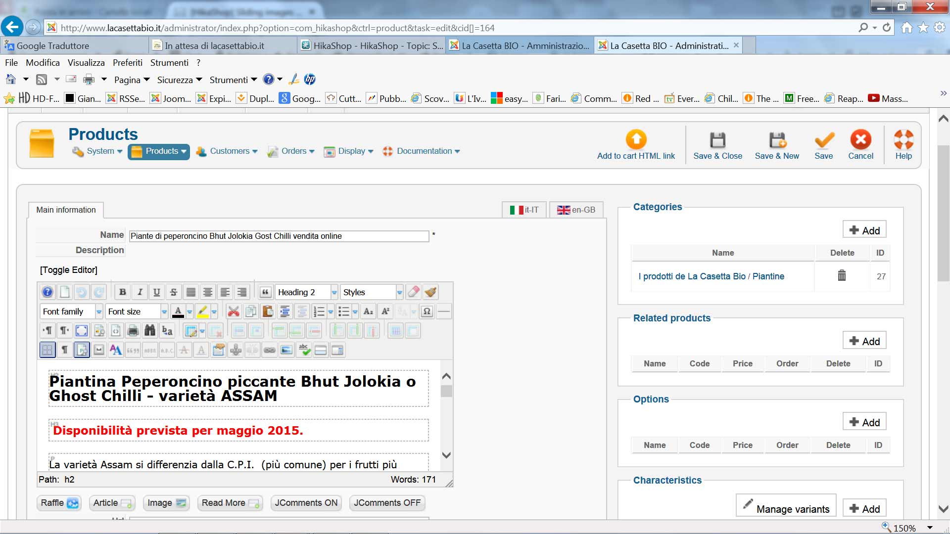

  • Posts: 719
11 years 10 months ago #175924
all those products have just one category associated.
Here a screenshot
www.lacasettabio.it
11 years 10 months ago #175945
Is that product the last one of the "Piantine" category ?
You can see that by filtering on the direct sub elements in the product listing in backend in the Piantine category.
We will need a ftp and backend access to see what's happening, you can provide it via private message or contact form, don't forget to give the url of that topic in the message.
