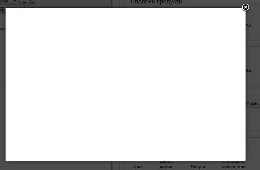

A while ago I wrote about problem with back-end price for all products. Now i'm havinig problem with access levels for them. When i try to set it a white screen open, but with no options.
Any idea? Maybe some code is missig?

11 years 9 months ago #178229
I've set the Joomla error reporting but still nothing... white page.
About the browser console... i try different browsers and different pc and the result was the same...

11 years 9 months ago #178483
If you can explain me why the HikaShop core files as been modified and why the files:
"administrator/components/com_hikashop/views/product/tmpl/price.php"
"administrator/components/com_hikashop/views/product/tmpl/priceaccess.php"
Are just empty files ; I will be happy to understand.
Please do not modify HikaShop core files ; please be sure that when you update HikaShop, you have right access to all files and that the installation is processed correctly.
I can't know if other HikaShop core files are empty ; but for the moment your backend product edition is working just with the overrides, which is not normal.
