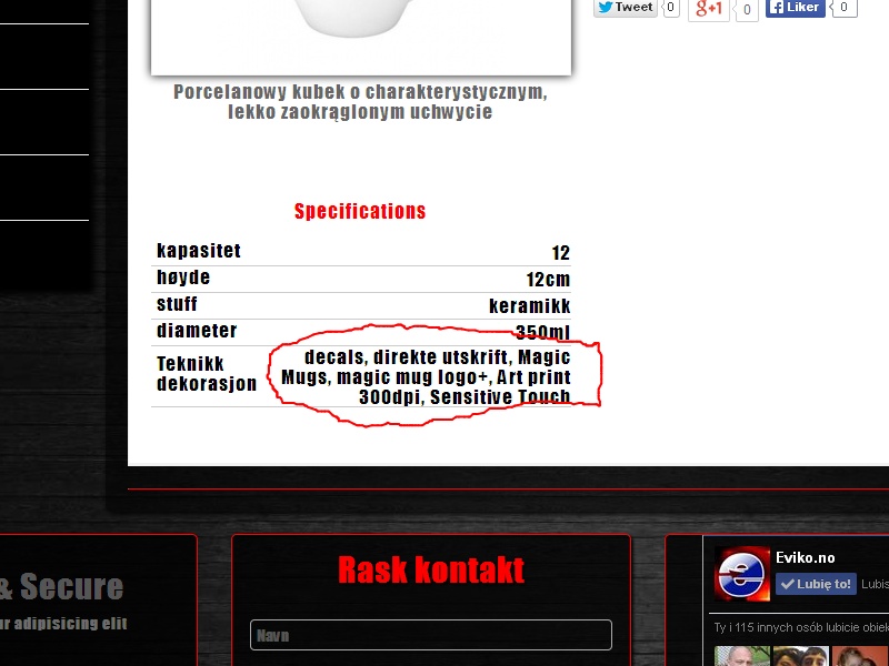

1. how to do that entered in the additional information box display them in a list? Image in the appendix.

11 years 9 months ago #179246
1. There is no option for that.
You would have to change the lines (twice in the code):
return implode(', ',$results);
to:
return '<ul><li>'.implode('</li><li>',$results).'</li></ul>';
in the file administrator/components/com_hikashop/classes/field.php
2. I don't understand your question. Could you give a precise example of what you want to do ?

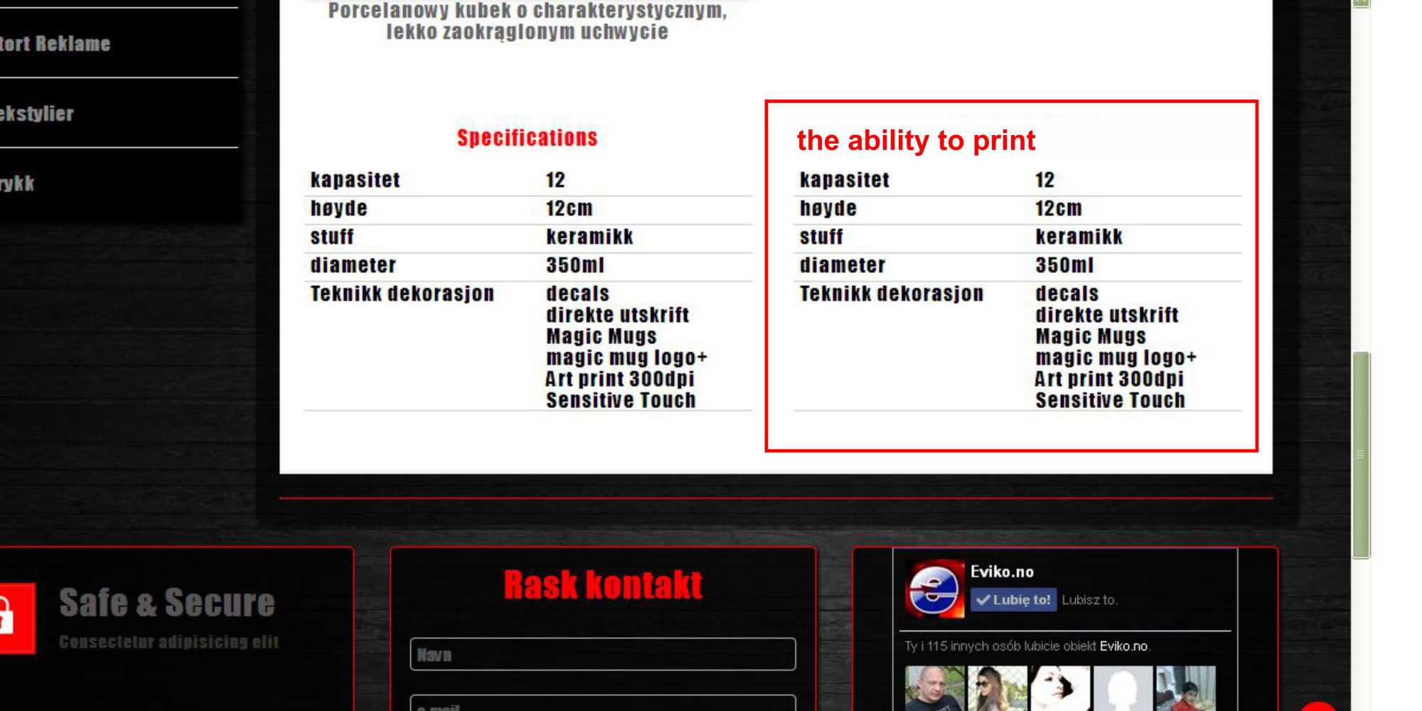

the second case is what I mean is that at the moment giving the specification of all I get together. I wish there were separate information about glass and separately on methods of printing. See the attachment.

  • Posts: 86079
  • Thank you received: 14186
11 years 9 months ago #179370
There is no option for that. You would have to customize the code of the display of the custom fields in order to get them into two columns.
You can do that in the file "custom_fields" of the view "product" that you can edit via the menu Display>Views.

What I mean is that I have such a group of additional fields that can be attributed to the example, cups, mugs, steins, plates. But such plates can not be such as to adorn the ear which has a cup and a pint. therefore, the possibility of decorating I would somehow enter separately and not all together.
I will try to give some details.
For example, I would like to do a half additional: material from which glass is made, eg, diameter, height,
in the second half of extra group would write such possibilities of decorating;
- Printing on the ear
- Print at the bottom
- Printing on saucer
There is such a thing possible?
Best regards and have a nice day :)
Peter
  • Posts: 86079
11 years 9 months ago #179469
So if I understand correctly, you want to restrict the display of some of the custom fields based on other fields values.
That can be done with the "display limited to" option of custom fields that you can configure in each custom field when you edit them via the menu Display>Custom fields in the Business edition.
