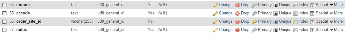

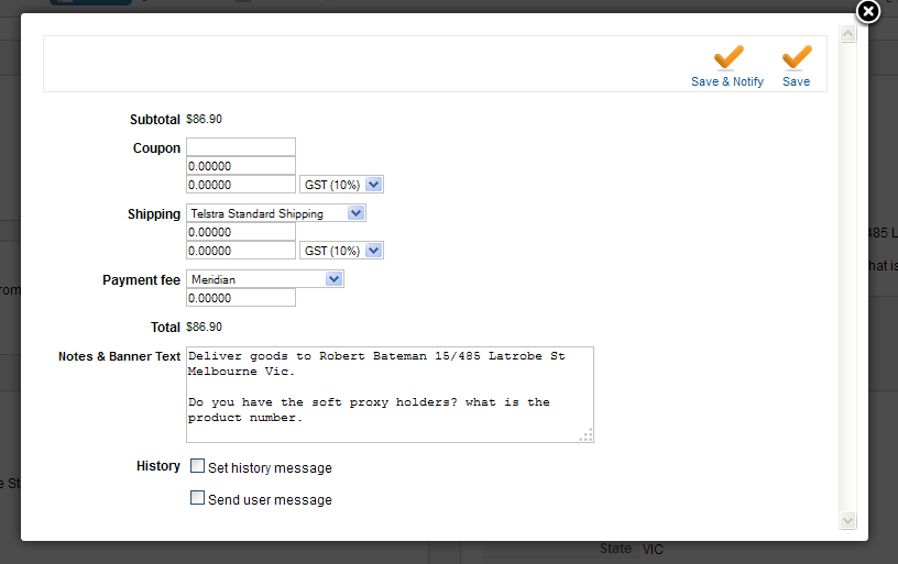

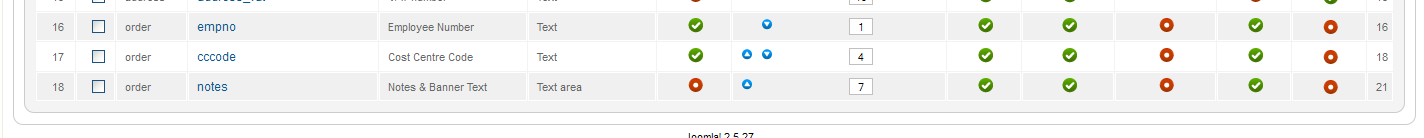

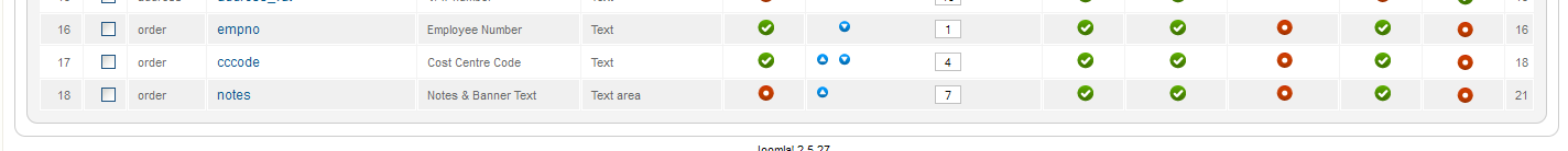

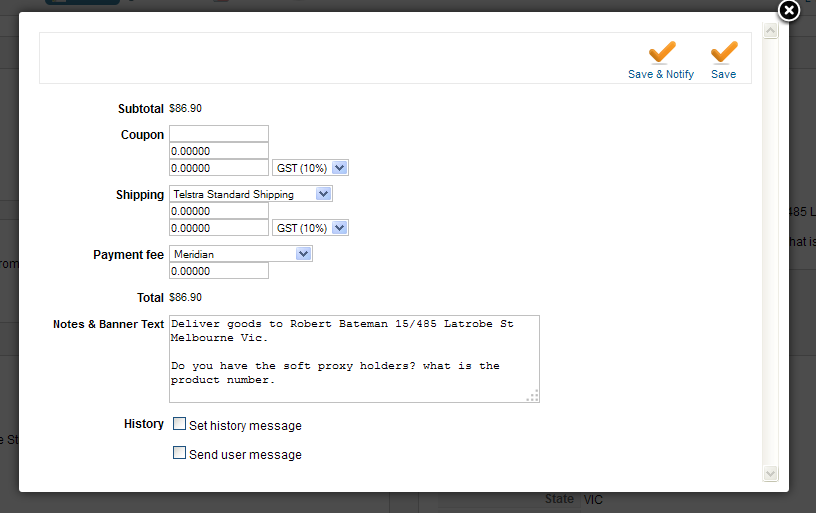

I have created three custom fields in the Order table. One is a text Area field the other Text fields. All work correctly on the front end and all store the text in the database tables. The configuration for each is identical except that the Text Area field is not "Required". All are published and set to display in the frontend and backend.
All display correctly on order emails.
The problem is that the two text fields can't be viewed in the backend while the text area field appears. What am I missing?

I just tried on my end and the input text fields are well displayed in order edition.
Do you have edited the view "order / edit_additional" view in the backend template ?
In that view there is the code:

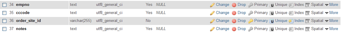

As you can see it list all the custom order fields, so please check via phpMyAdmin in the table order if the columns with the custom field name are well created.
  • Posts: 259
  • Thank you received: 22
11 years 9 months ago #180872
That view has not been edited and the code looks the same as yours.
What do you mean "the columns are well created? They exist and the data is stored in them - what else would I check?
