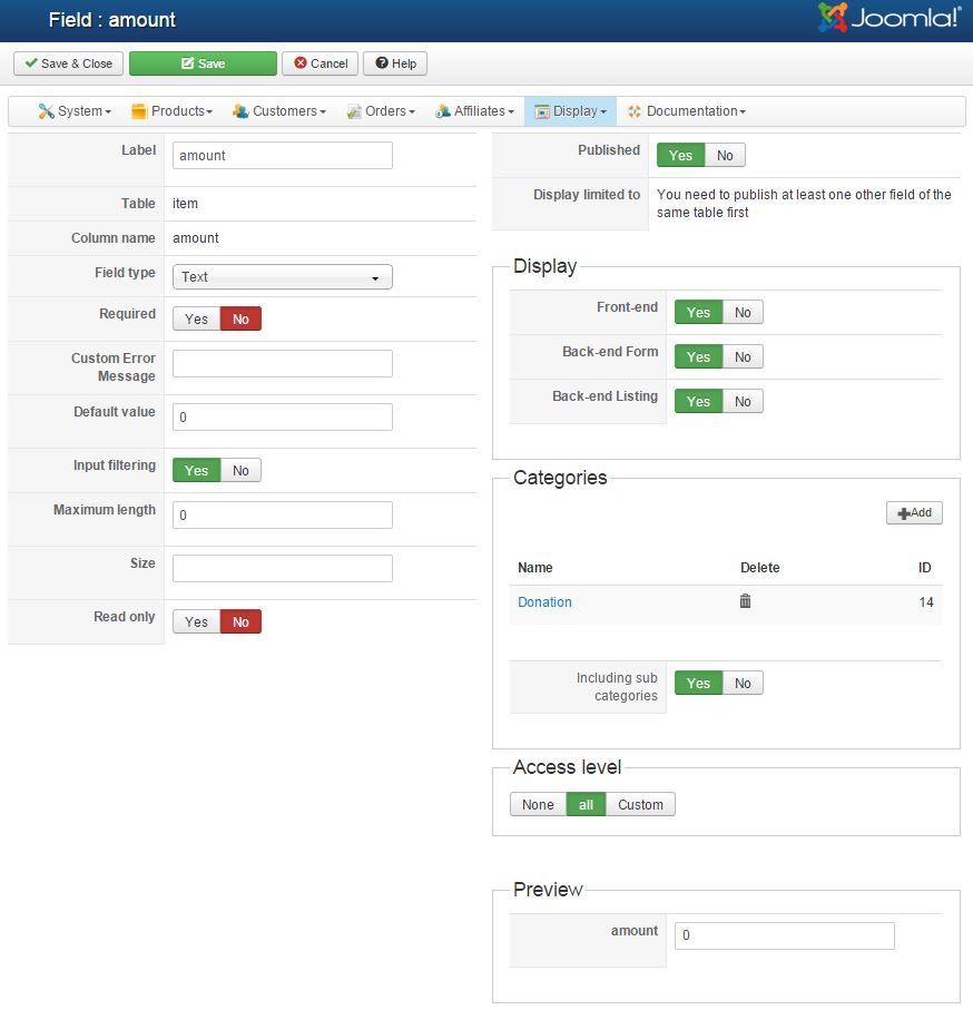

Okay, I've now got the custom "amount" field showing but when I go through to the checkout, the amount of the donation is not passing through to the cart. I've got the site set up like your demo, i.e. custom field is labeled "amount" and the donation item is labeled "donation".

Did you enable the HikaShop donation plugin via the Joomla plugins manager ?

Yes, the plugin is enabled. How does the plugin work? Is it looking for a specific field name, ie "amount" to replace the price? I have ensured that the custom field label/name/alias is set to "amount".

I see that the value of the amount is not added to the cart on your website when you add the product to it. So the problem here is not the plugin but the fact that there is something preventing HikaShop from handling the custom field.
How did you configure the custom field ? Could you do a screenshot of its options ?

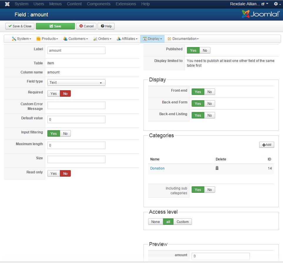

The screenshot is attached above (towards the top of this thread) but I've included a current version here in case I made any changes since posting the last screenshot.
BTW - I did the "check database" and everything came back "OK"

I got the access 2 days ago yes. I checked but couldn't find anything from 2 months ago.
I've checked the issue on your website today, and the issue comes from something on your website which removes the amount parameter from the data received. I don't know why. Just changing the name of the custom field make it work.
So the simple solution I did is to create another custom item field with another name and modify a bit the donation plugin to have an option in it in order to be able to set the column name of the field to use.
It now works on your website.
