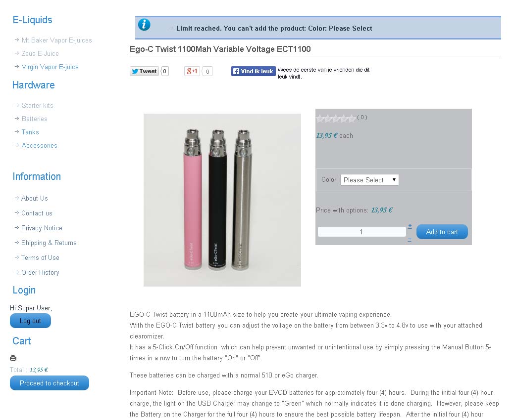

I have a Product : Batterie (see picture) with options:
Collor
- Please sellect
- Red
- Pink

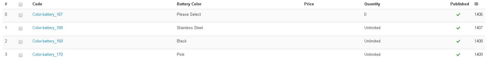

Defaultt: Please sellect (Because this option reqoured before you can order this prosuct) with Quantity of 0
If they click add to cart they get a error = You need to sellect color but he placed without collor in the cart.
Limit reached. You can't add the product: Color: Please Select - but he placed now the batterie without collor in the cart
Thanks for your time

We do not have the problem on our end. When we do that, there is no add to cart button on the product page for the default variant since it has no stock. So that means that you (or your joomla template) must have changed something in the views of the product page.
Rename the folder templates/YOUR_TEMPLATE/html/com_hikashop/product and that will deactivate all the file overrides of the product view and it should then work normally.

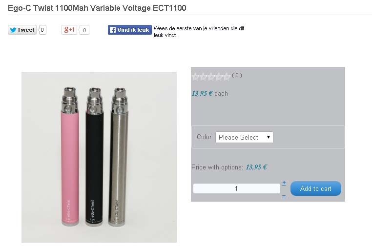

Same issue. When i do Charic to product directly i have also no Cart button. Only with the option function and the Characteristics function i have this problem. He placed the main product into the cart and the option he leaves. But when the option is not avaibl i like the main product doesnt going into the cart also
I hope there is some solution for this.

After checking your website, I can see that you're using options and not characteristics, which is why you get that behavior as you can't have a "please select" choice for options (remember that they are options, so they are optional and you can still add the product to the cart without them). So normally, the variants of the options should either all have an unlimited quantity, or the "show out of stock" option of the configuration should be turned off in order to not display the out of stock choices of the options.
