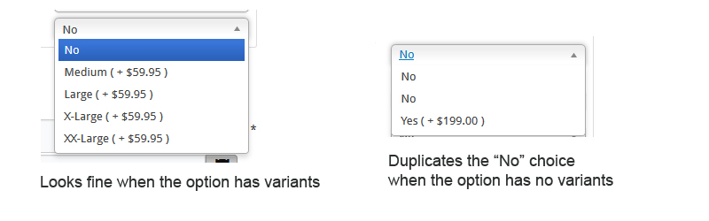

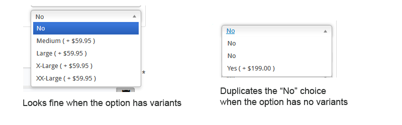

9 years 8 months ago #256349
Hi Nicolas, its been a while since I revisited this - I gave up last time.
Changing the code on the product / option view works HOWEVER now if I add an option that does not have variants, it puts 2 "no" choices in for that option.
See image.
I've seen other posts describing this problem too but no solutions. Any help appreciated.
9 years 8 months ago #256403
Can you try to remove this line (around line 24) :
$this->values[] = JHTML::_('select.option', 0,JText::_('HIKASHOP_NO'));
In order to replace this (WITH previous customization suggest by Nicolas):
<?php
		$this->values = array(JHTML::_('select.option', 0,JText::_('HIKASHOP_NO')));
		$value = 0;
		$currency = hikashop_get('class.currency');
		$map = 'hikashop_product_option['.$i.']';
		$id = 'hikashop_product_option_'.$i;
		if(empty($optionElement->variants)){
			if(!$optionElement->product_published || (!$this->config->get('show_out_of_stock',1) && $optionElement->product_quantity==0)) continue;
			$text = JText::_('HIKASHOP_YES');
			$this->row =& $optionElement;
			if(!empty($optionElement->prices) && ...
To have this :
<?php
		$value = 0;
// LINE ERASED HERE !!!
Hope this will solfe the "double no" issue AND still display good choices for products options WITH variants, awaiting news from you.

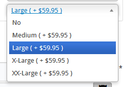

9 years 8 months ago #256458
Thanks Philip, that removed the "double no". However, now I have the option defaulting to one of the priced variants and I don't have a "no" variant to set as the default.
I want the options to default to "no" which gives customers the choice of adding extras to their base product (ie: upsell). I have 5 options on my products and I don't want them to have to deselect the variants.
Please see image.
Here is my revised code in option.php in case I've not made the changes correctly:
