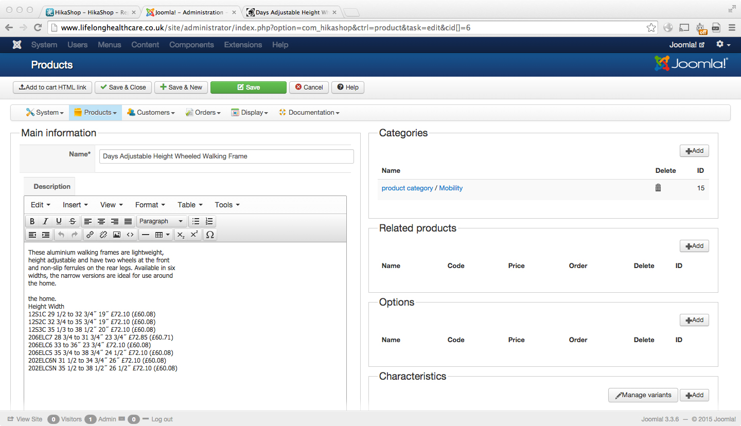

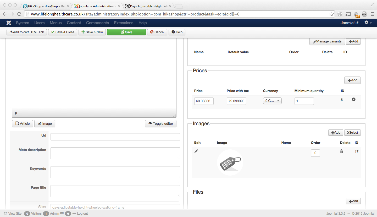

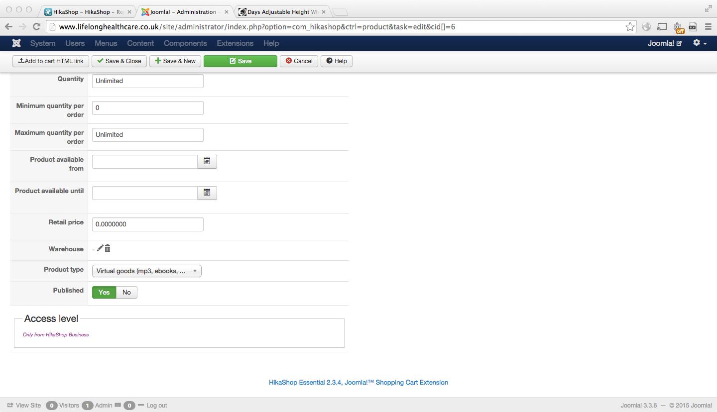

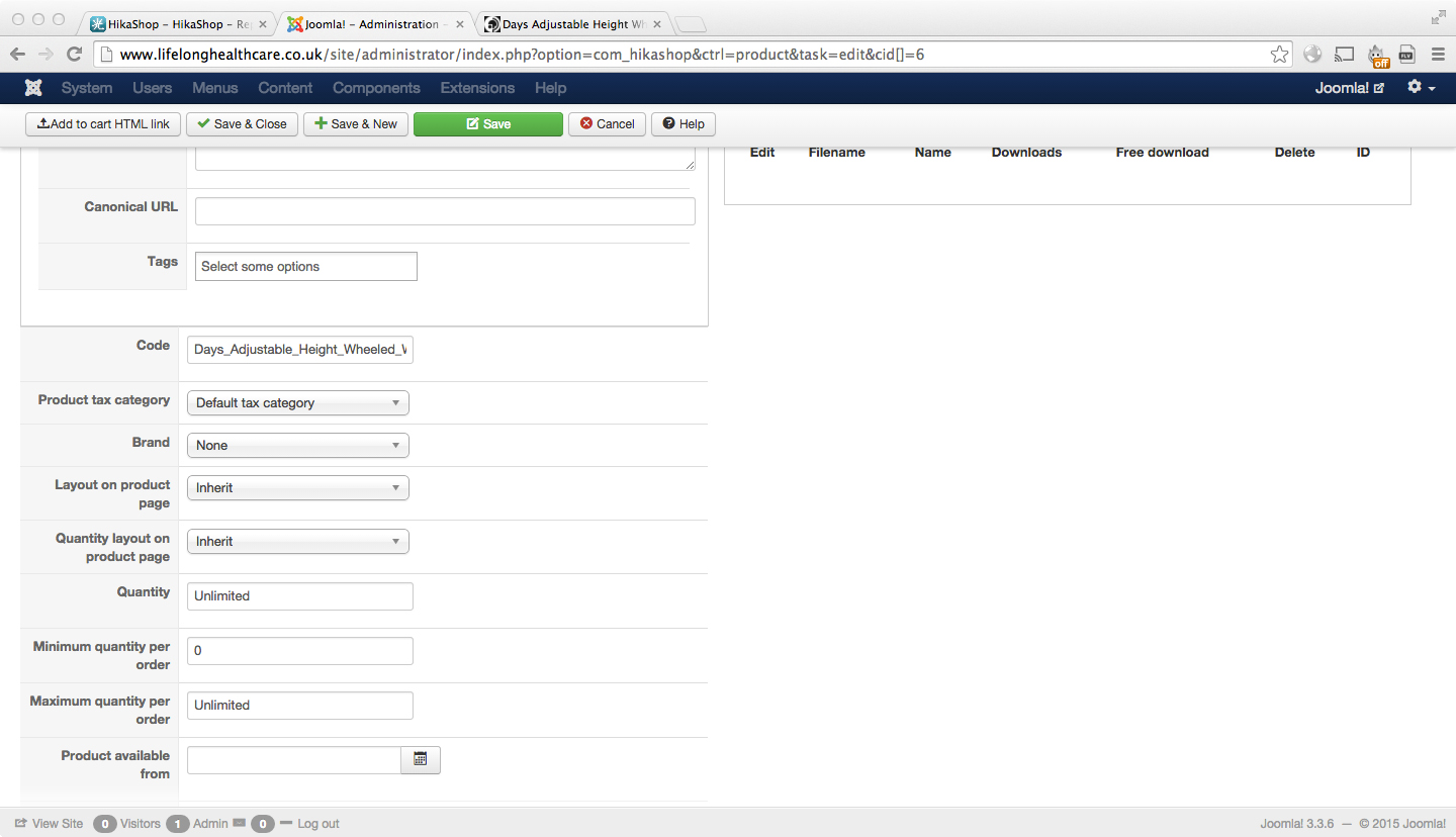

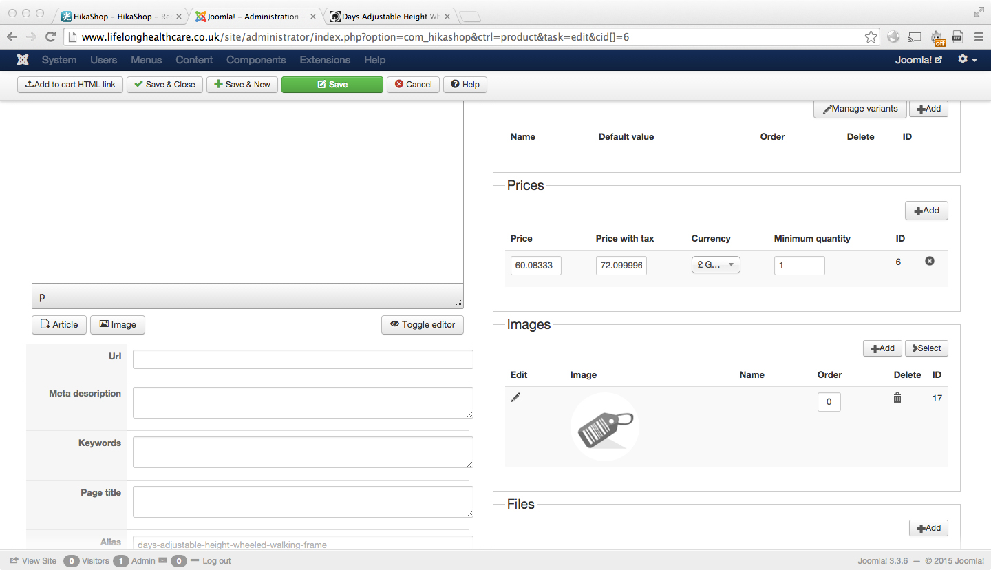

Can you provide a link to a product page so that we can see it and a screenshot of all the settings of the product page of the same product ?

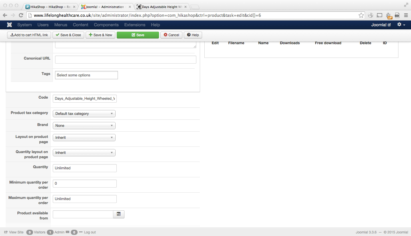

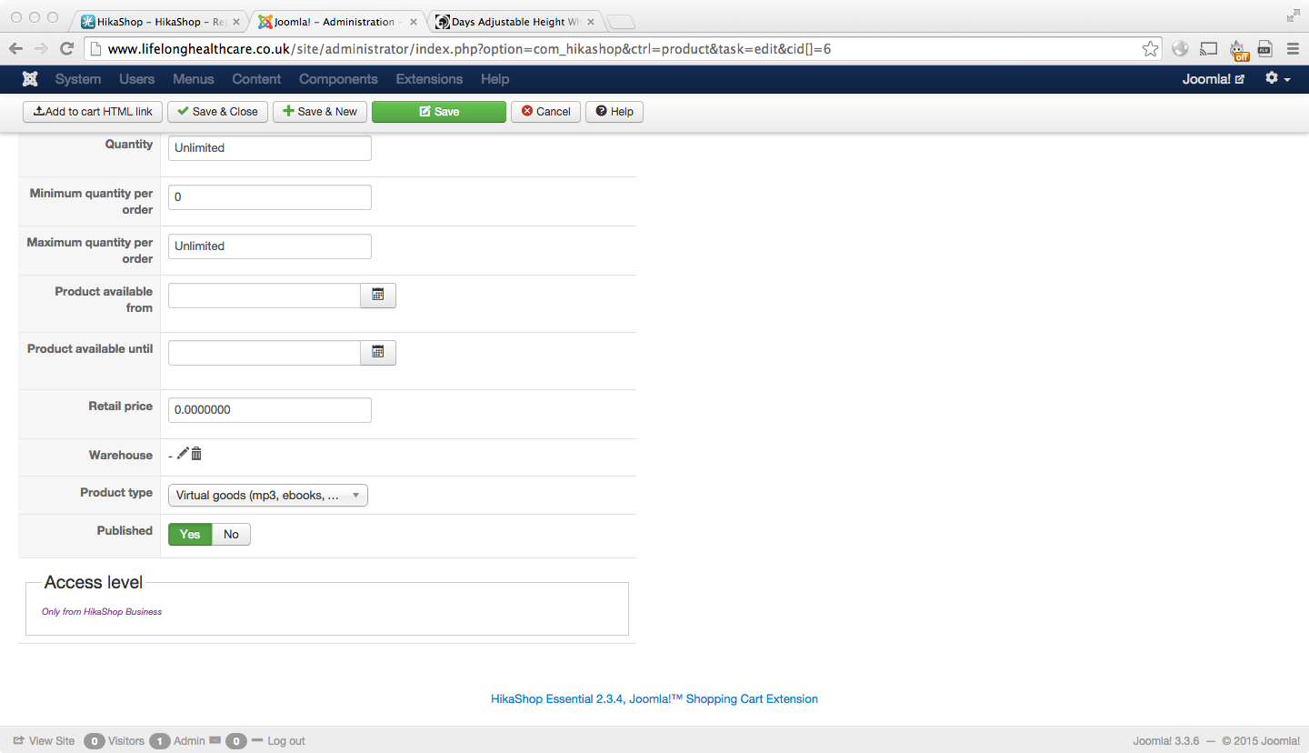

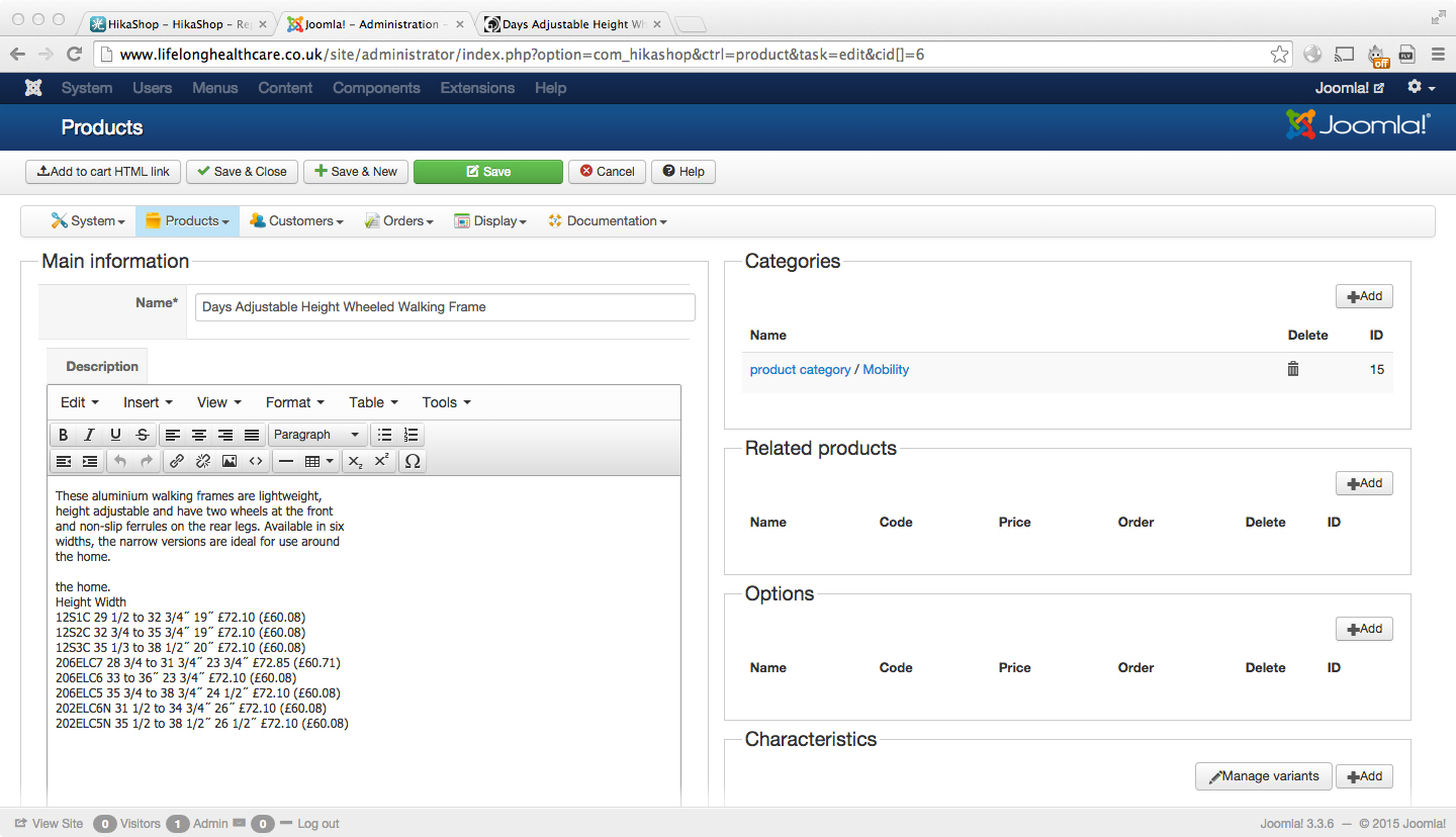

  • Posts: 7
11 years 7 months ago #185019
Last edit: 11 years 7 months ago by davidhharnertt. Reason: Upload didnt work
  • Posts: 86079
  • Thank you received: 14186
11 years 7 months ago #185076

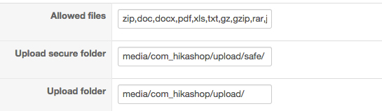

I can see the image entry listed in the "images" area of the product. So if you upload the file with the correct name in the correct folder it should find it.

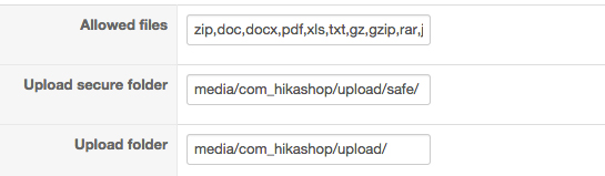

Please check that the "upload folder" option of the HikaShop configuration is set to the same folder where you uploaded the file for that image and make sure that the name is exactly the same as before.

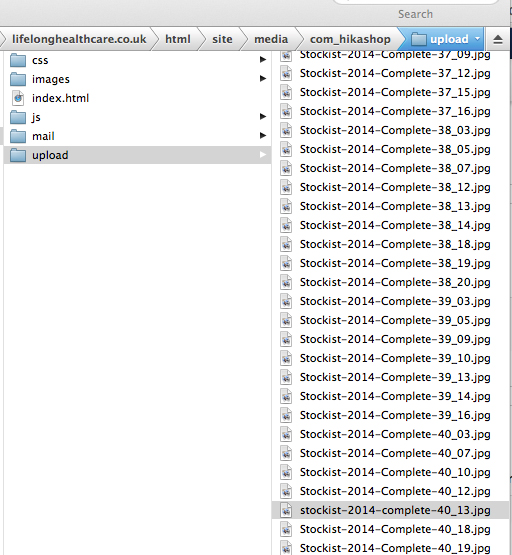

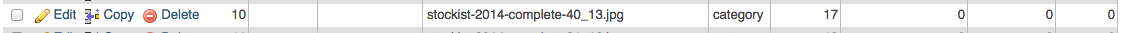

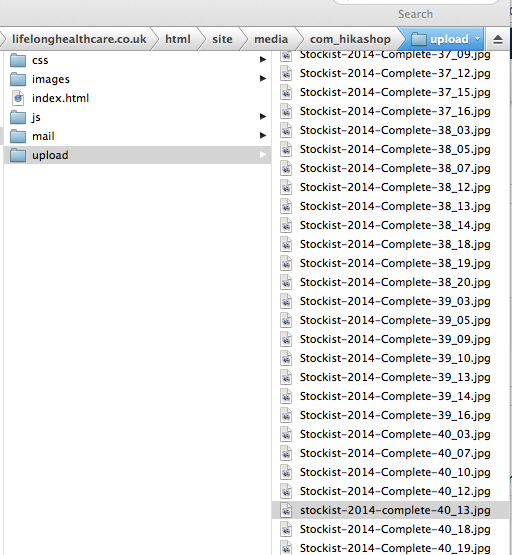

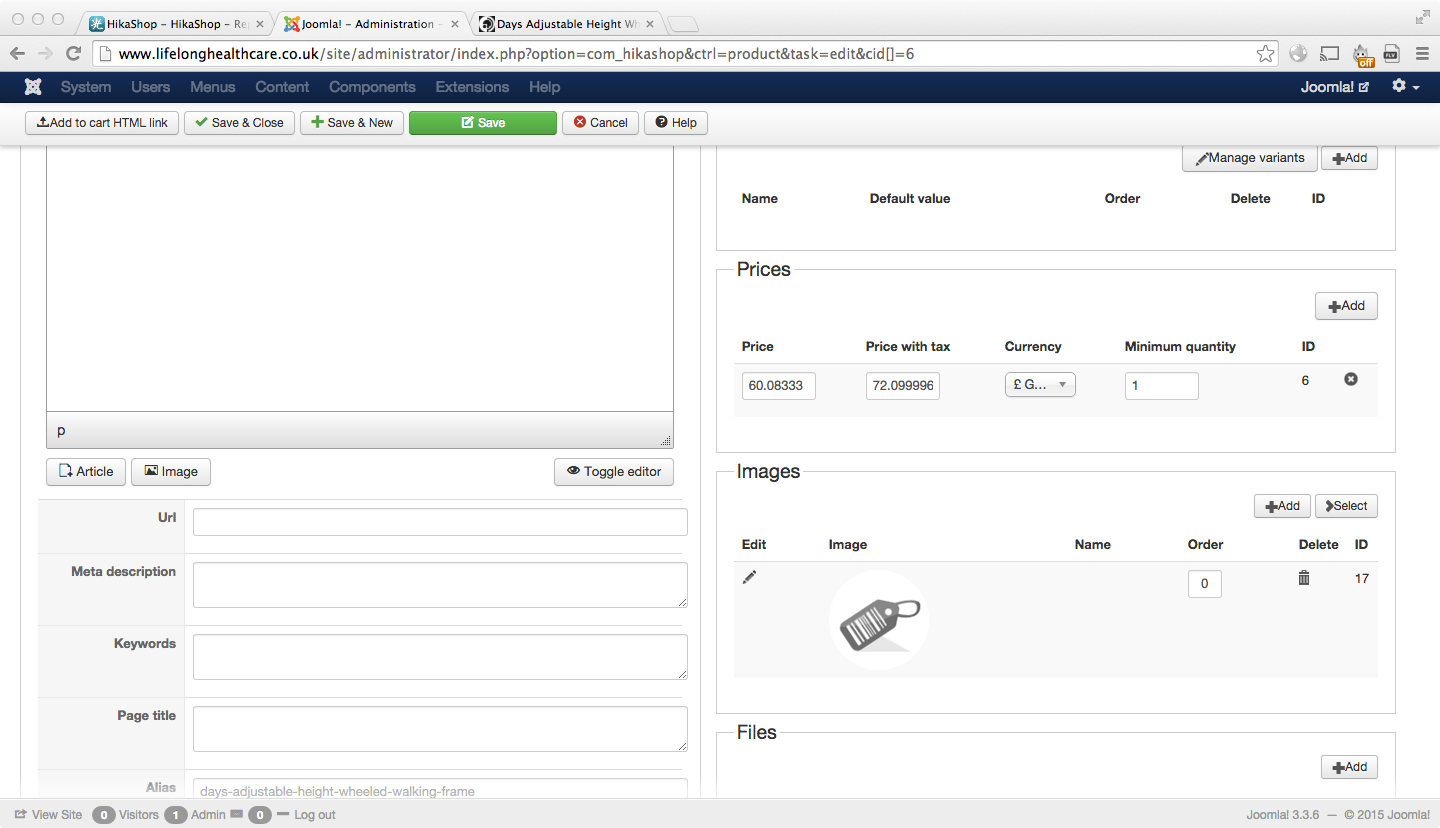

I really think I am doing everything as you suggested but still not having much luck unfortunately please see these further screenshots regarding the same product listed in the last post. Screenshots of database setting, FTP folder and configuration please tell me if you can see any errors.
Thanks Again
David

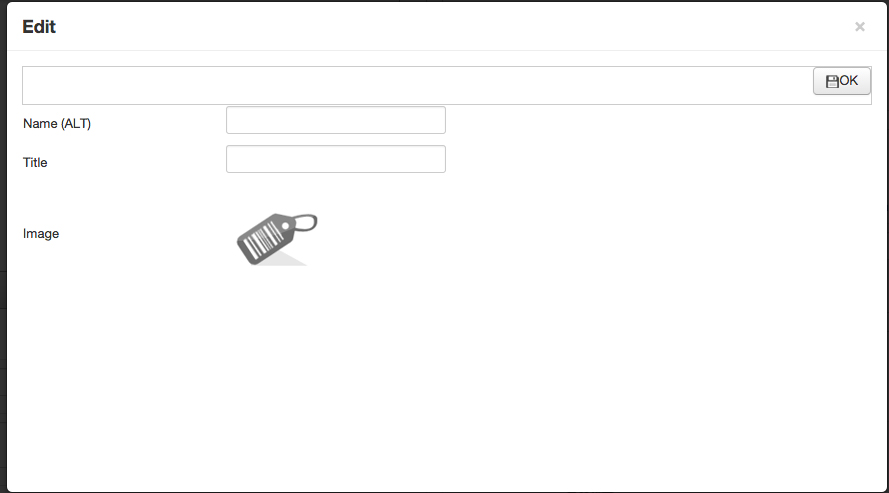

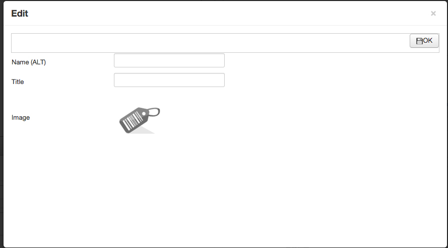

11 years 7 months ago #185500
This seem to be correct, please give us a screenshot of the image edition popup when clicking on the edit icon next to the image on the product edition page.
You can too check via phpMyAdmin if the entries in the table "#__hikashop_files" are correct.
  • Posts: 7
11 years 7 months ago #185554
HI screenshot requested below the first screenshot on the last post was of the phpmyadmin entry.

  • Posts: 7
11 years 7 months ago #185570
sorry everyone it is all working, the issue was that I had capitol letters in the original filenames which I have now batch changed and reuploaded and almost all the thumbnails are now back
Thank you so much for your help.
