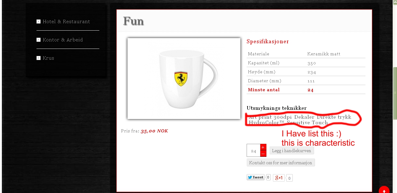

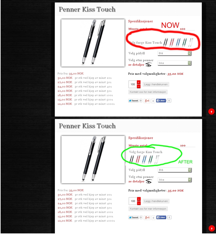

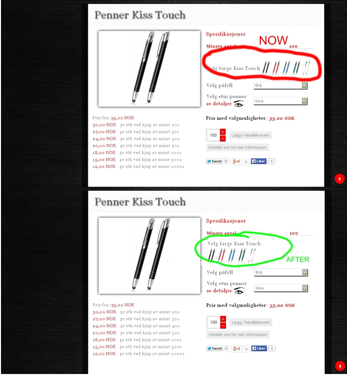

I would like for example to display the characteristics with pens as a radio button, while at the cups as a drop-down list on the T-shirts and such as a table, and at watches as a list. It is possible to create such Characteristics for each product to display the different?
Another question. How do the characteristics of that title was on the characterization? I know that at the moment, both the title and the characteristics of the parameters in the table, but I'm trying to take it out and give up (above) and I can not do that.
I will try to show you the picture I want to do.
Last edit: 11 years 7 months ago by piotreczek100.

1. There is no option to have different display methods for characteristics for now so it would require some customization of the code in your end to be able to achieve that.
2. That's possible with some CSS. Please provide a link to that page so that we can analyze the CSS of your website and we should be able to tell you what CSS to use.
Last edit: 11 years 7 months ago by nicolas.

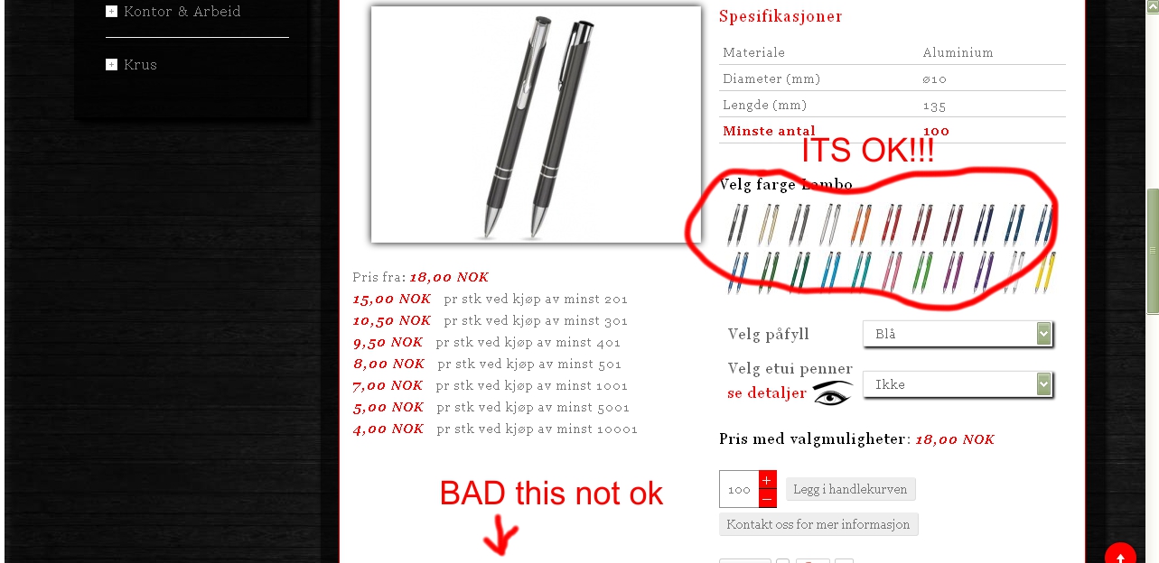

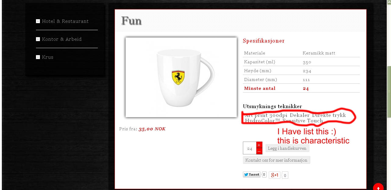

  • Posts: 32
11 years 7 months ago #184597
Hello.
here
test.chelm24.pl/avdelinger/kontor-og-arb...product/penner-lambo

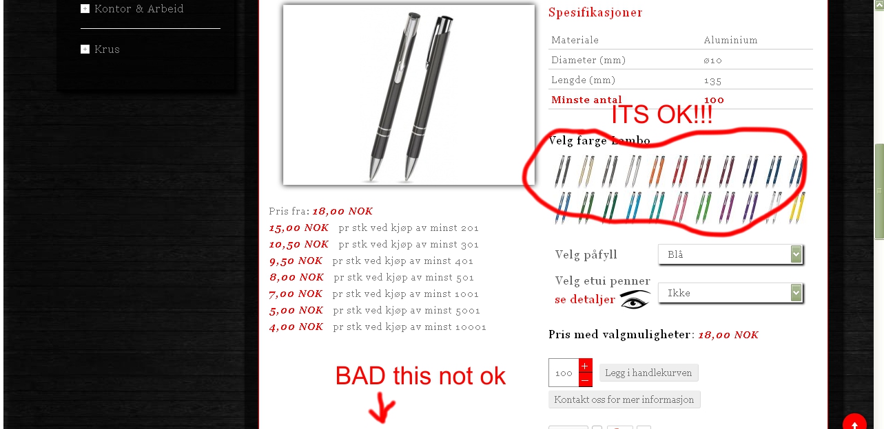

Everything is just as I like it, but when the characteristic is in word format, unfortunately this is no longer so clear.
I would like to do that here already CHARACTERISTICS view this as a list down. test.chelm24.pl/avdelinger/krus/product/fun

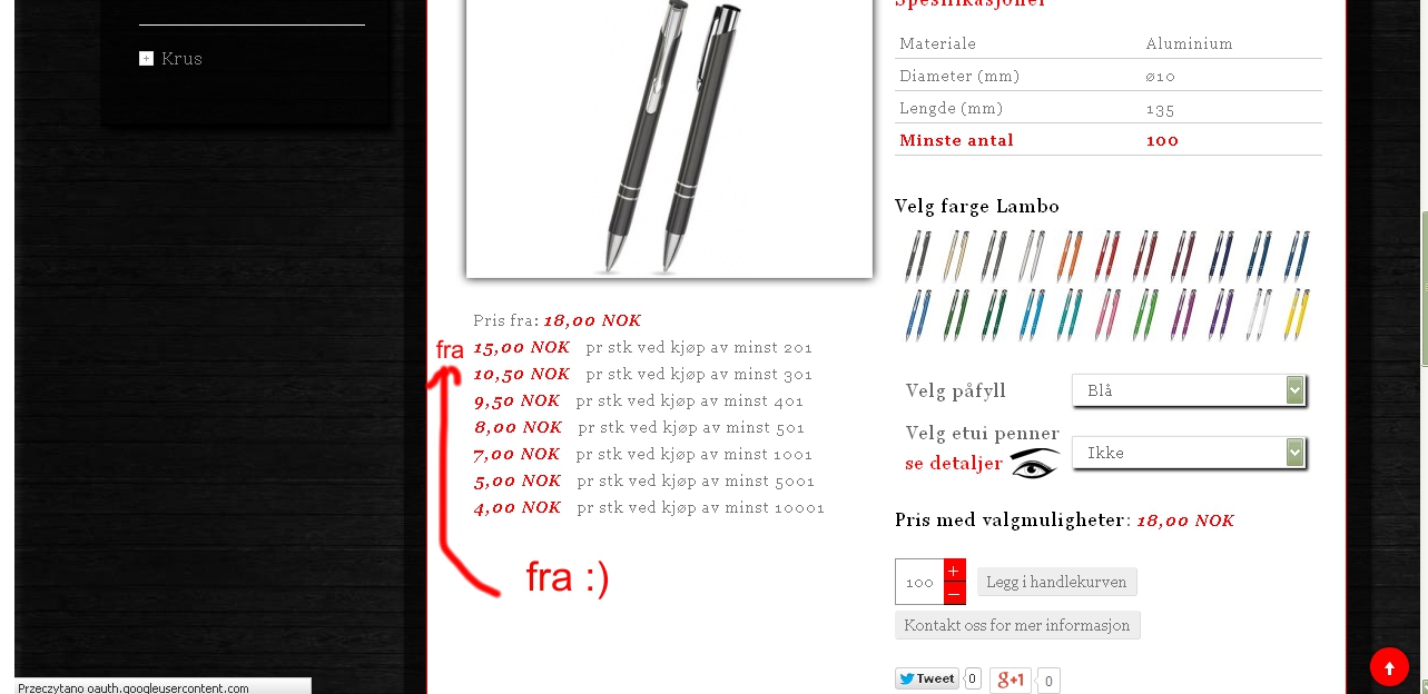

By the way, ask for two more things without which side I'm done.
first

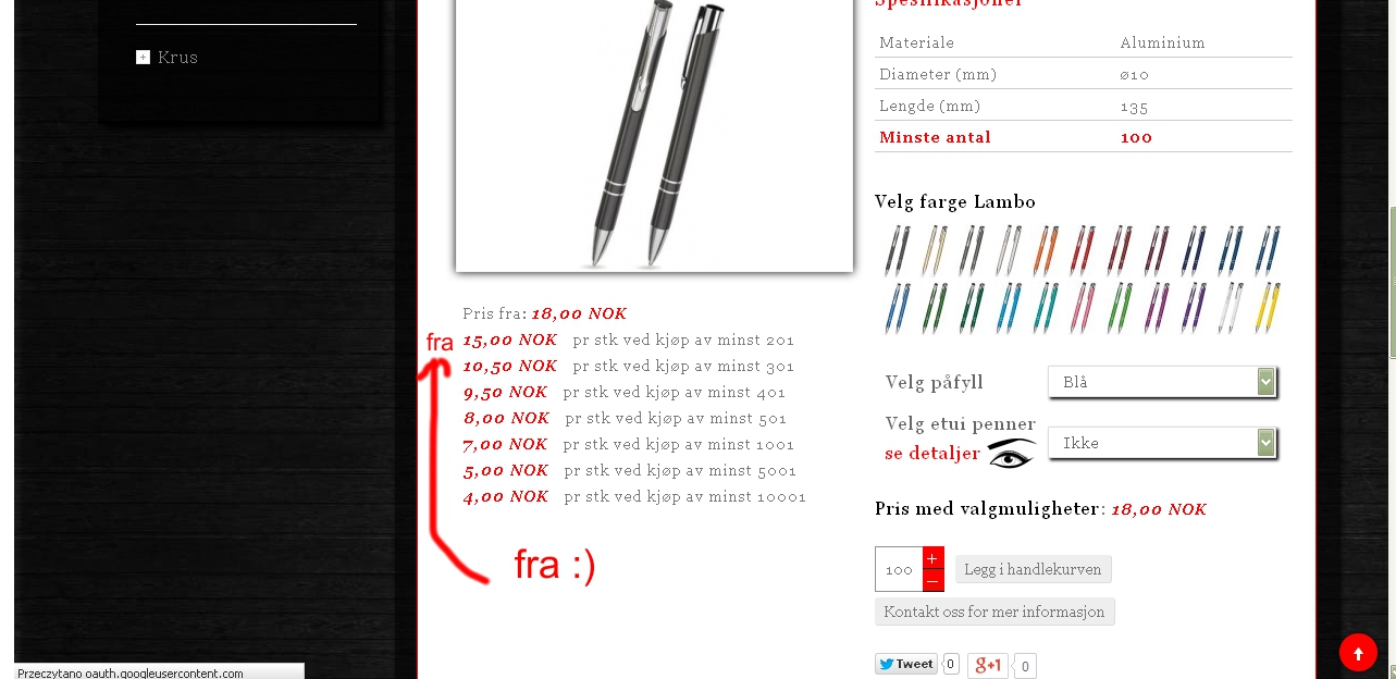

How to change the prices so where is the "pris fra" was the lowest price, that is when you buy many products?
The second

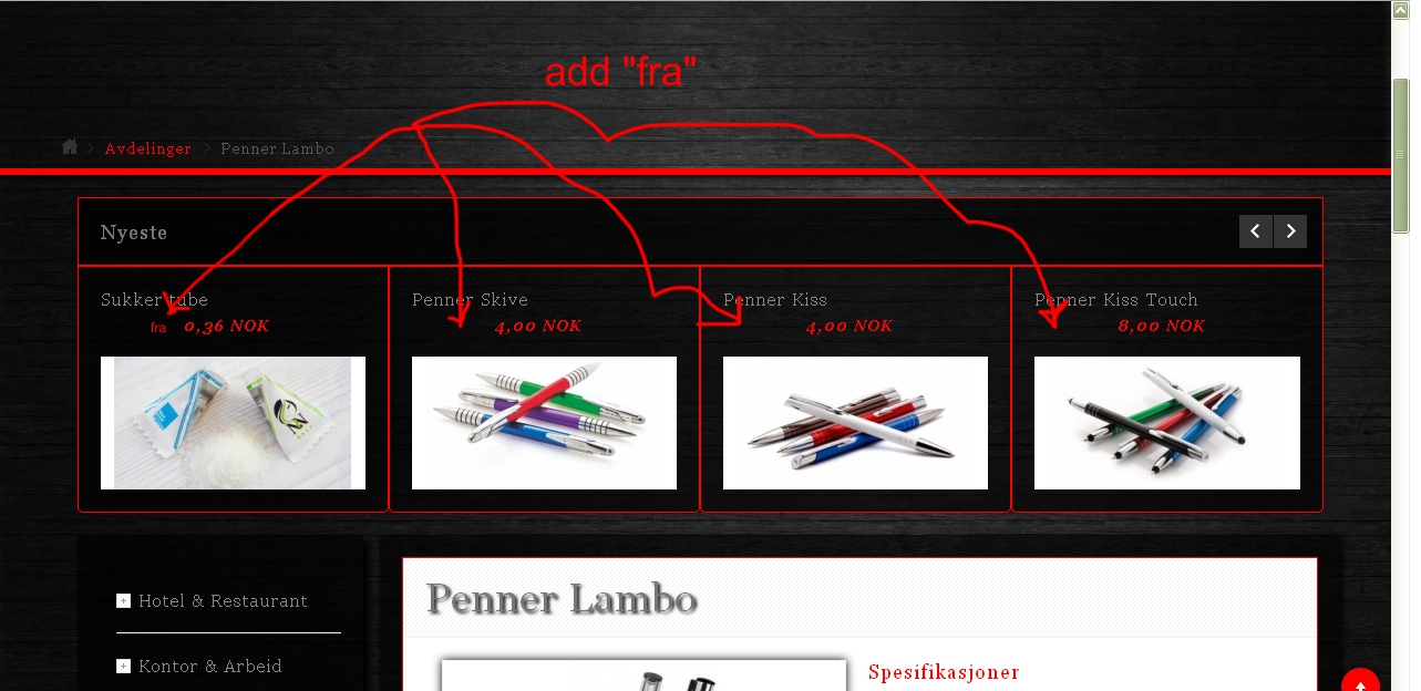

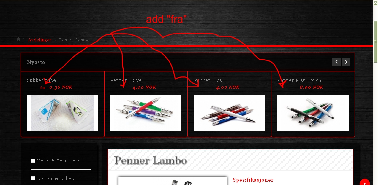

And how to add the word "fra" in the widths and on the product, but to being shown in the shopping cart.
If I can solve these problems it will remain my me just add the product and to start to business :) Yours sincerely

1. For the characteristics I now see this on your website: take.ms/ZRUjz
You can add such CSS on your website in order to fix it:
.hikashop_product_characteristics_table label{ display: inline-block !important; }
And it will then display like that: take.ms/8EZLW
2. You can add such CSS:
#hikashop_product_left_part #hikashop_product_price_main span:first-child{
float: left !important;
margin-top: 12px !important;
And oyu'll get that result: take.ms/42Nbx
3. I'm not sure where exactly you want to add that. Could you do a screenshot explaining where you want that ?

For the characteristics, I would recommend to add such CSS:
.hikashop_product_characteristics input{ display: inline !important; }
For the "fra" modifications, these will require modifying the PHP code of the file "listing_price" of the view "product" via the menu Display>Views. I would recommend to hire a developer for these modifications if you're not one yourself.
