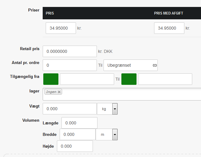

  • Posts: 26382
9 years 10 months ago #252452
I am sorry but that's not the case.
You can type either "34.95" or "34,95" ; it will be read by HikaMarket (and HikaShop) the same way.
pasteboard.co/eOPlIG21d.png
There is a function in HikaShop called "hikashop_toFloat" which convert a string into a float number.
The goal of that function is to split the digits into groups. All digits will be regroup except the last group which will be used for decimals.
Afterwards, YES, by default all prices are displayed with the point as decimal separator and without any separator for thousands.
Because the interface let you configure prices for different currencies it requires a standardization of the numbers and it is not based on the American format : but on the computers one.
Now, because you can override every views in HikaShop and HikaMarket ; you have to possibility to change how the prices are displayed in the interface.
In the view "productmarket / form_price" you will get all the code used for the edition of the prices and by changing the content of "$price->price_value" and "$price->price_value_with_tax" you can format them before their display in the input boxes.
You just have to include the case where these elements will be fully empty and where you want to leave the field empty (and not display a "0,000" data).
You also need to be sure that you will keep enough decimal digits ; HikaShop needs 5 decimals to work properly (otherwise you will have some lost of data and possibly some incorrect saved prices if you're using taxes).
