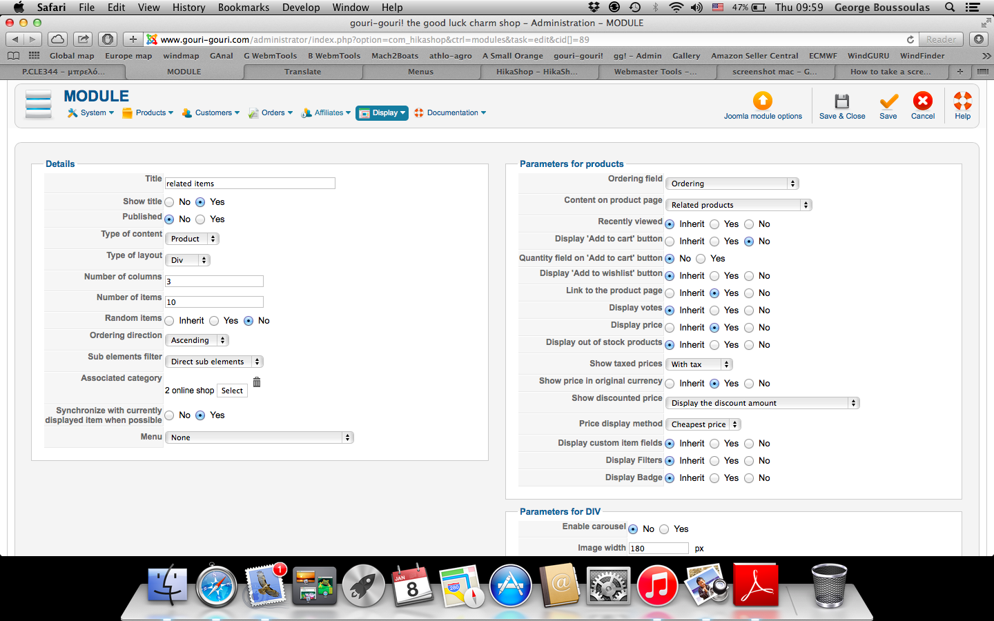

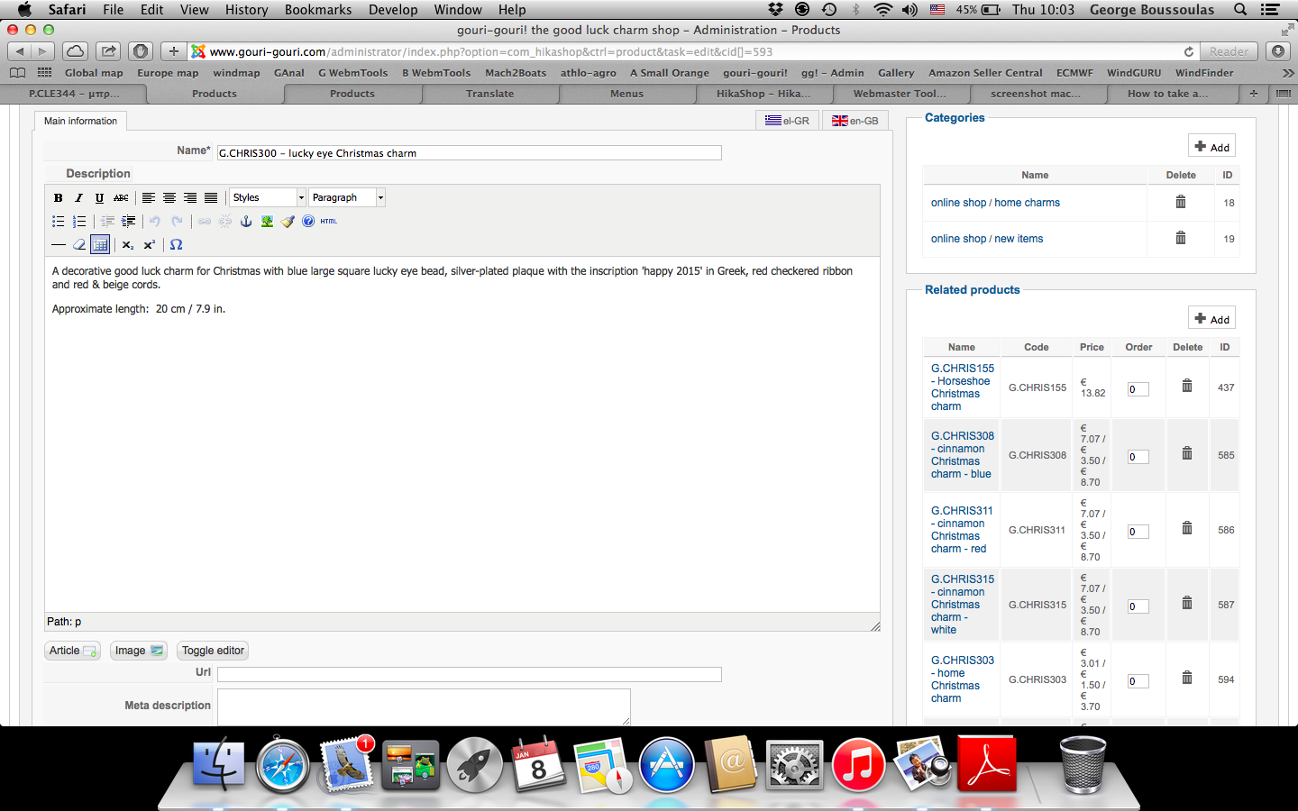

Please give us a screenshot of the products with id 593 and 426 settings.
For the related issue, please check the settings of the module with the id 89, it's maybe not properly configured.

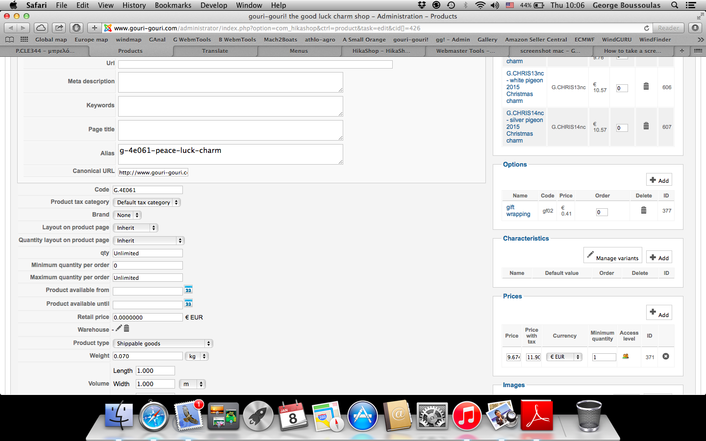

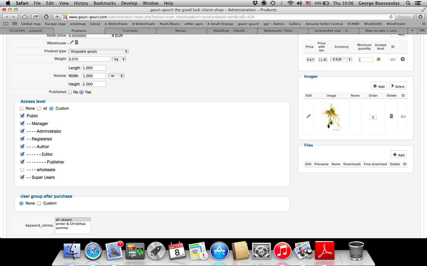

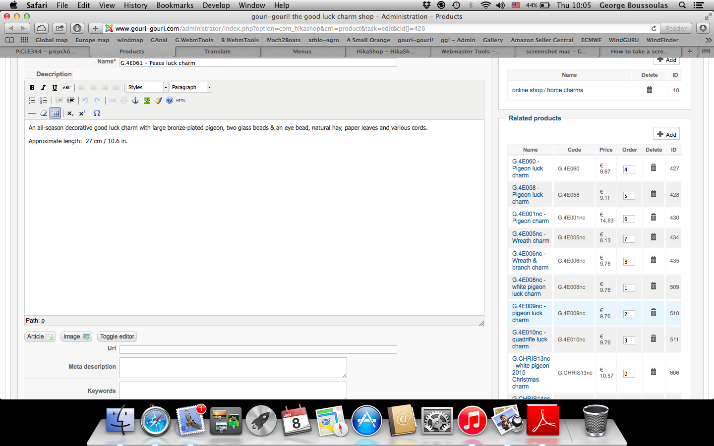

11 years 7 months ago #185695
Here they are:
11 years 7 months ago #185770
Could you provide backend access ? It will be easiest for us to find the origin of the issue.
You can send the informations via private messages or via our contact form.
Don't forget to give the url of that topic in the message.

Also, since first setting up hikashop the related items module (see screenshot above) has been unpublished but it still works normally! What difference would publishing make in this case?

11 years 7 months ago #186158
If you published it, your template would display the module in the position that you configure it via the joomla modules manager.
So it's normal that it is unpublished since HikaShop is displaying itself under the product page because you have it published in the "modules under the product page" option of the HikaShop configuration.

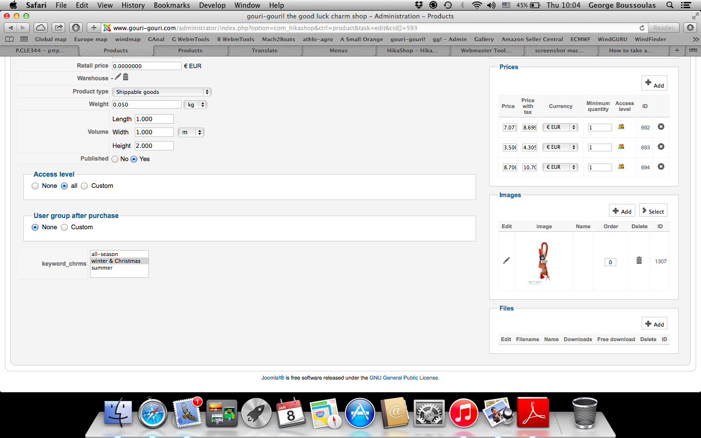

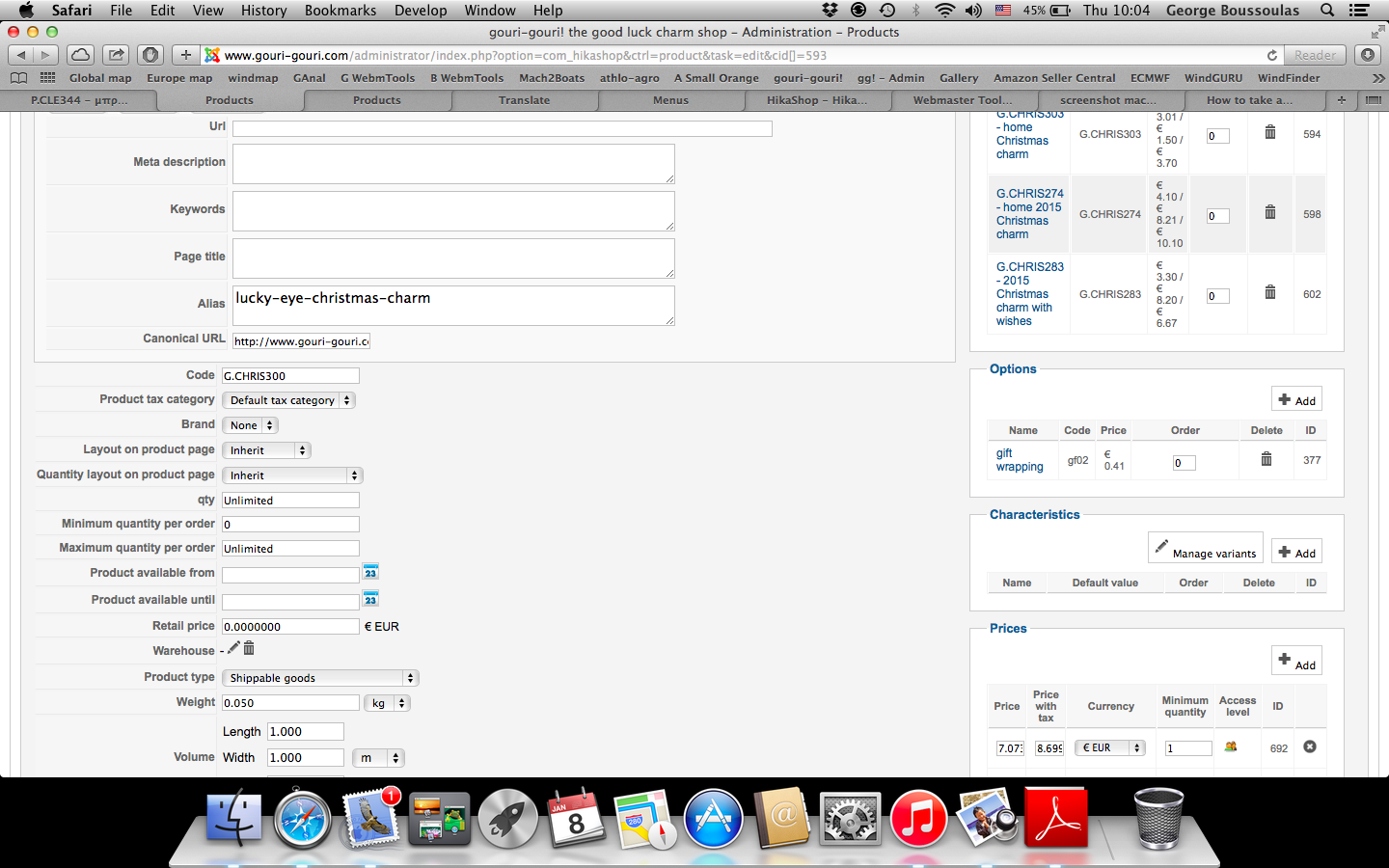

  • Posts: 64

11 years 7 months ago #187135
The problem is that you don't have the canonical in the header of the page so it's normal that you get all the URLs listed.
This means that either you didn't enter a canonical URL in the product, or that you have the file "show" of the view "product" which has been customized from an old version of HikaShop which didn't support canonical URLs.
So you would have to check that view file under the menu Display->Views and remove the customization in it in order to get the new code to handle canonical URLs in that case.
  • Posts: 64
11 years 7 months ago #187377
Hi Nicholas,
The main url is www.gouri-gouri.com/gr/home-charms . It has a canonical. The rest of the urls contain a product code inside. Those too have canonicals. And I have removed all my customisations but still no url appears in the source code of these duplicates.
