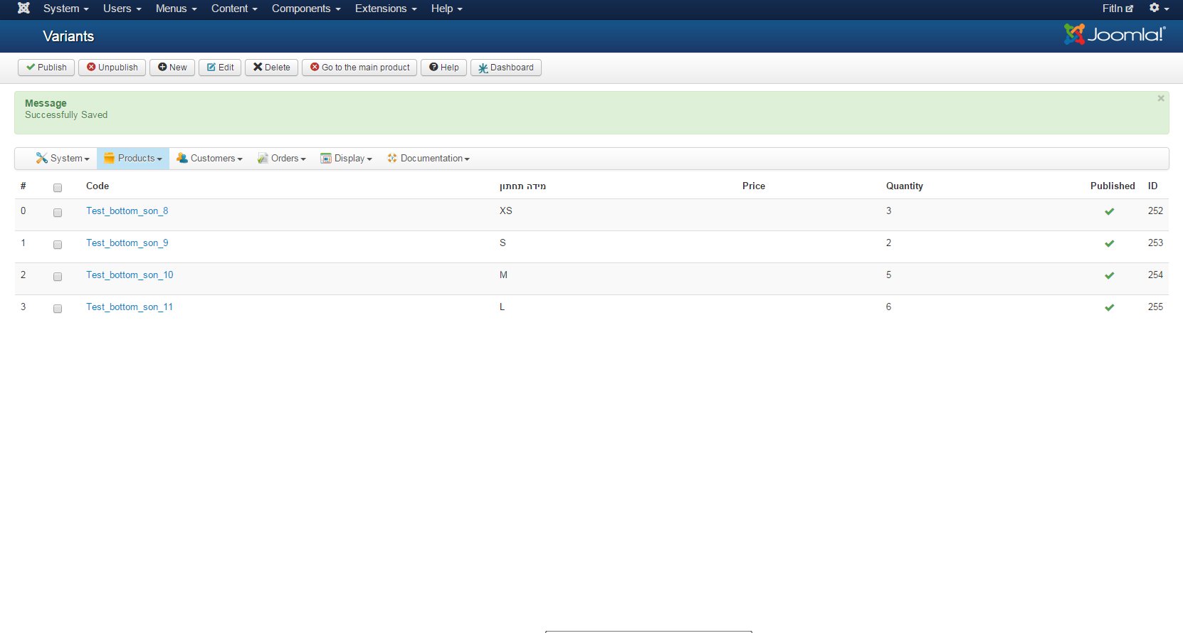

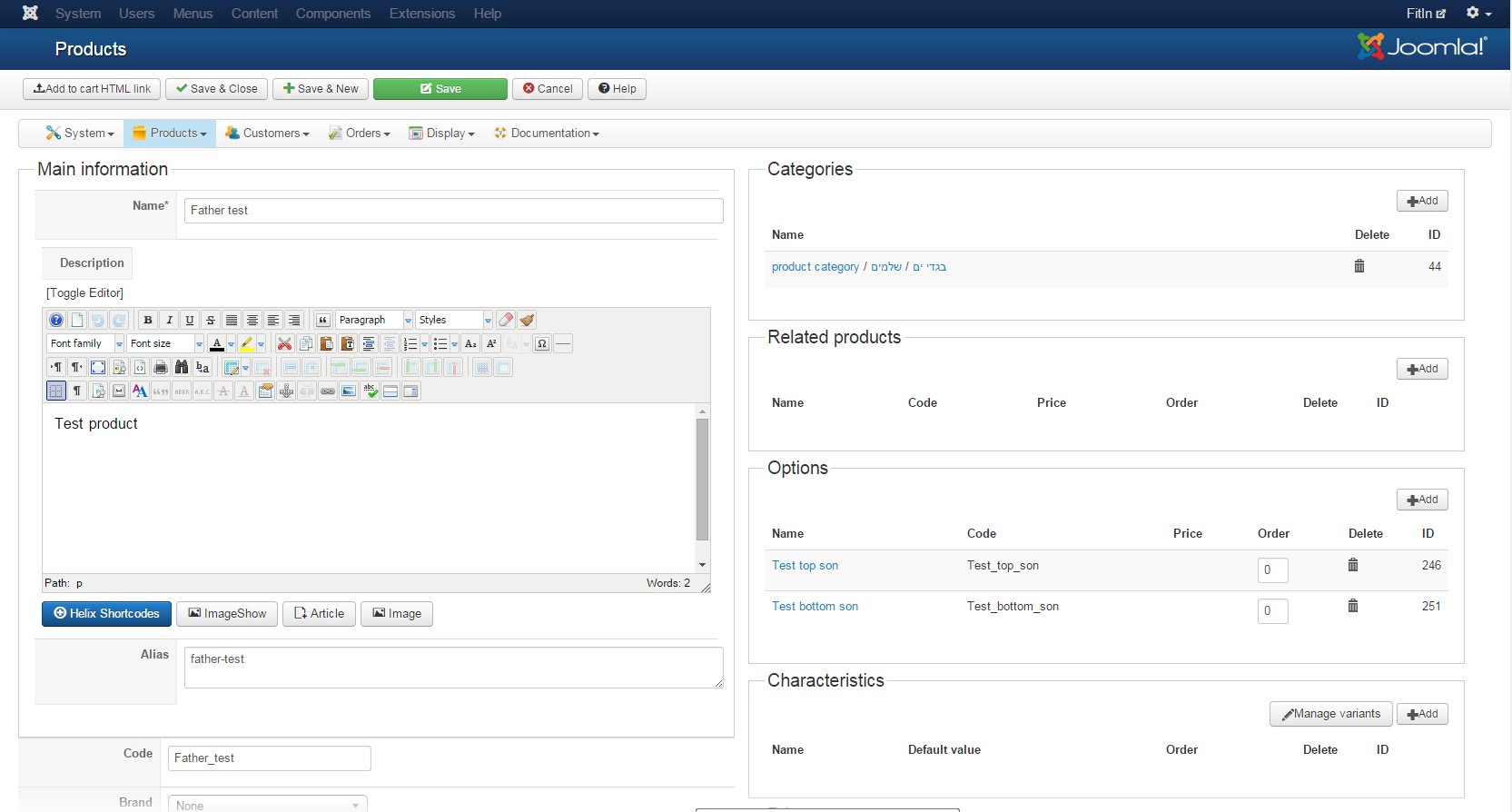

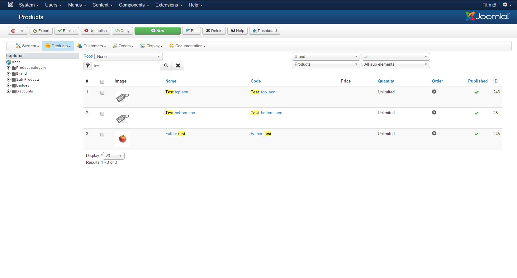

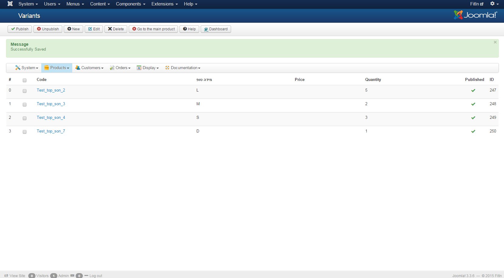

I've got a complicated setup on a site I'm building. I've created a Father product with Son products. The father is just an empty shell which holds the Sons which are hidden products that I've assigned to the Father as options. Now, each son has one characteristic assigned to it to manage sizes and stock respectively.
For example: My Father product is Bikini swimsuit, Son 1 is the top part, Son 2 is the bottom part. Each one have it's own product details and an add to cart button. Son 1 (top) has characteristic "top-size" assigned to it with sizes: XS, S, M, L. Son 2 has characteristic "bottom-size" assigned to it with sizes: S, M, L, D. The entire stock of the site is manged via the sizes.
My problem is that the characteristic seems to collide and will not work. When I use the dedicated size characteristic for each son the drop down boxes collide. In the given example the bottom drop down box shows the right stock levels but on the top son while the top does nothing. When I use the same characteristic for both sons one seems to work and I can see the stock values but the other won't.

See attached screen shot of the characteristic and product built as well.
