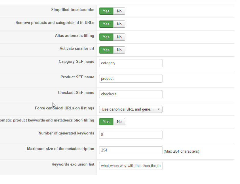

BTW, attached is the settings currently in the SEF Config. What did you need me to change to remove "product"?

Regarding the SEF configuration, you specify that you want to use (and force) the canonical url in the listing.
