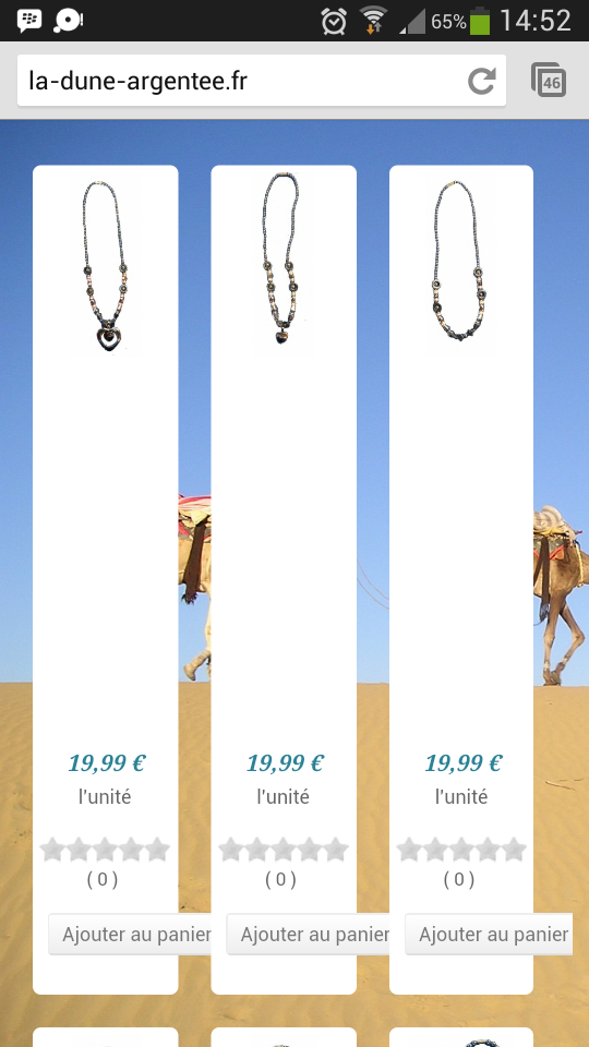

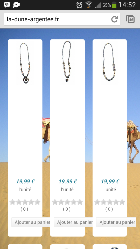

I've got a problem when using my website on a smartphone. The "add to cart" button is not placed well. How can i fixe it ?

Turn on the "use bootstrap design" option of the Display tab of the HikaShop configuration. That way, your HikaShop frontend will be responsive and adapt to the screen size of mobile devices.

Thank you, that worked !

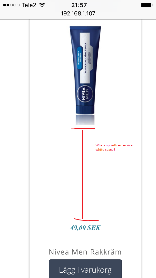

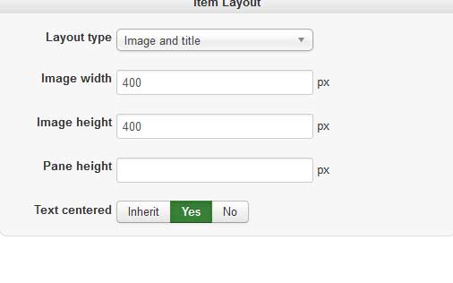

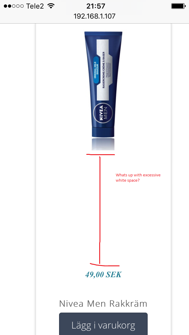

Hi, I have the same problem. When I changed my image settings in the menu, "item layout". To width and height 400 respectively. I got the same problem with the add to cart button as above.
Check my attached images. I turned on bootstrap design to no avail.

As you configuration screenshoot shows, you set that the image height must be 400px.
So HikaShop put some CSS to force that height ; but when you're in responsive, the responsive CSS change the image width without touching his height, which generate your "issue".
Clean up your menu settings and it should be better.

I mean do not force an height at all.
Like I wrote, you specify an height in the menu configuration so if the image became smaller, the height allowed for the image do not change and stays 400px !
