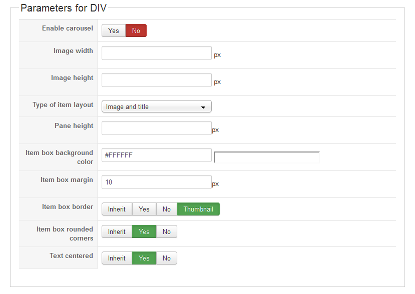

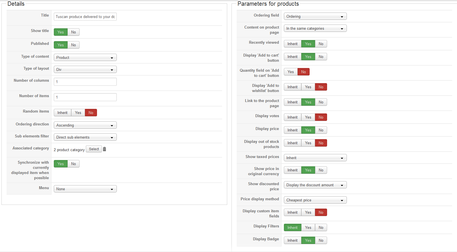

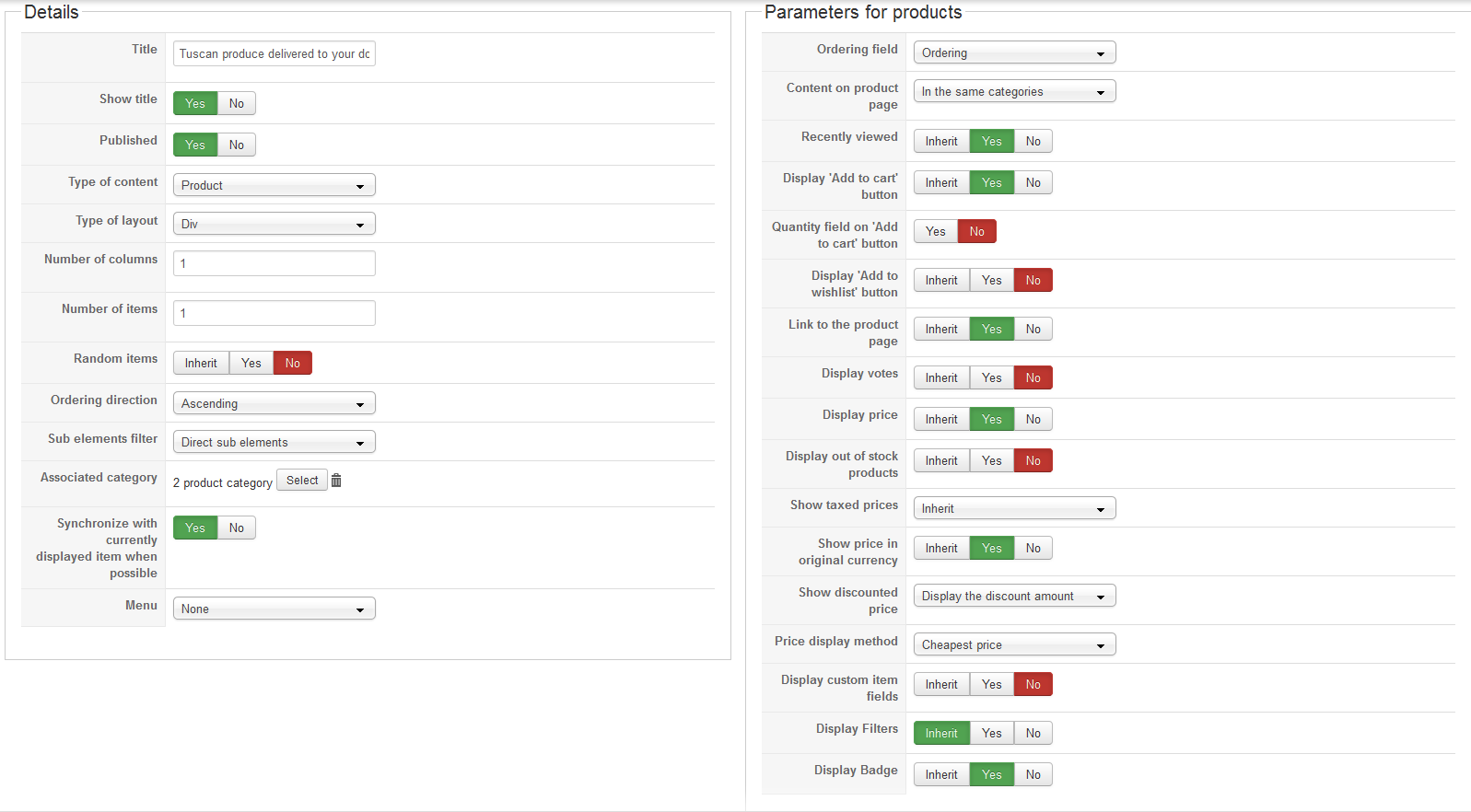

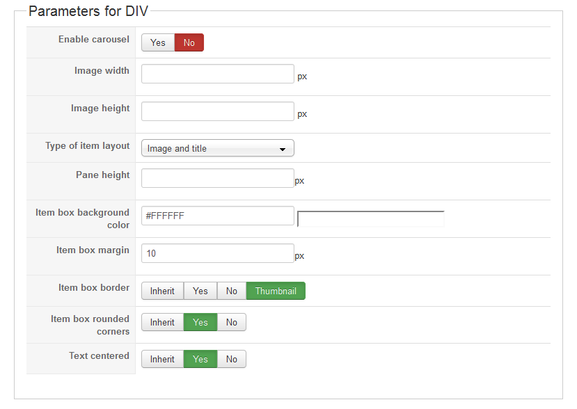

Screenshots of content module settings attached

First on the module configuration, see if you get the single random product you want there:
You have the column/number settings right for displaying only a single product, indeed.
Other settings for you to review:
"Random items": It you want random, why do you set it to "No"? It must be "Yes", obviously.
"Sub elements filter": Unless the products the module shall pick from are in the "Product category" (and not only in sub categories), you should set it to "All sub elements".
"Synchronize with currently displayed item when possible": Eventually turn it off.
"Recently viewed": No.
Should work.

Now, since that is out of the way, I understand you want a brief description in that "listing" module, and a few other layout changes. Shouldn't be difficult at all:
It appears that this listing is the only one where a brief product description (by using the "readmore" function) shall show, yes? If that's the case, you should select the div "Type of item layout" option "Image and description" for this listing module.
Next, you may go and edit the view "product / listing_img_desc" for your template, and customise it to what you want including the order of things, wrapping the product name in <h4> tags, and what not else.
Again, this will work only if you don't use "Image and description" anywhere else, as it'll affect all divs with that option selected - in which case you'd still not be lost... you could simply create your very own custom view, too.
