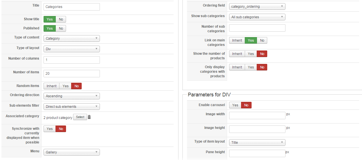

I am trying to create a sidebar categories listing menu and I have 2 issues. Here is the webpage: www.iartunique.com/index.php/gallery
1) When I select a subcategory form the main menu item Gallery, then the breadcrumb works as it should. But using the sidebar menu, I only get the path Home-->Gallery, not the subelements.
Please, find attached the configuration screen for the sidebar menu.
Notes:
a) When I select the div for the layout I don't get any contents as results to the right side. List type works well, but I want to keep it as div. Couldn't I?
b) When I select "All sub elements" then the module Categories doesn't have any contents.
2) For the Gallery listing (visit from main menu) I want to display only 5 items per page, but pagination is not enabled. How do I do that?

1.a The links are generated the same way, regardless of the layout you use. That is unless there is some customization of the view files done by you or your template provider which would break one or the the other.
So I don't see why this would happen.
1.b Similarly, I don't see why using the "all sub elements" would not display anything. It should be the opposite. When you use the all sub elements choice, instead of getting the direct elements, you get on top of it, the child elements of these elements.
Try to click on the "rebuild" button of the categories listing of the backend. Maybe there is a problem with the integrity of the category tree preventing the system from loading it in some cases.
2. Make sure that the "pagination" setting of the HikaShop configuration is activated.
