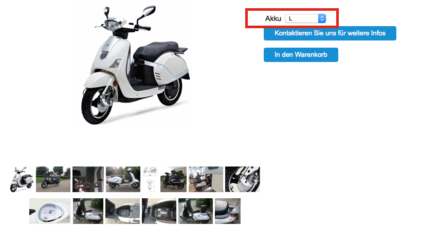

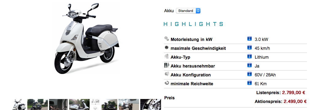

actually we made some changes to the views therefor the "right" part has a different view-form. now if we change the value from this option field the complete view is empty. can u tell me where to make the changes that it takes the right view instead of blank ?
picture attached

please see picture, if u choose an option e.g. Akku "L" all custom view/fields are gone
so there must be a setting e.g. "if option change, change innerhtml" and the innerhtml seams be the "standard" view which is actually empty cause all fields are custom fields and the view file is separate made, actually it's called "show_block_custom_main2" instead of show_block_custom_main, so where can i find this to change to show_block_custom_main2

11 years 5 months ago #192216
When you change the characteristic selection, the system will replace the content of the div hikashop_product_custom_info_main with the content of the hikashop_product_custom_info_XXX where XXX is the id of the variant and which is a div hidden on the page and added at the bottom of the product page by the "show" file of the "product" view.
So an easy solution is to delete the code adding the div hikashop_product_custom_info_XXX in that show file so that the system doesn't find it and doesn't replace the hikashop_product_custom_info_main at all.
