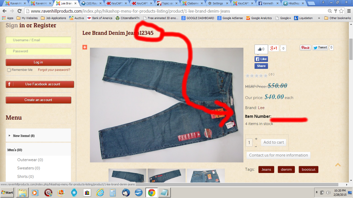

Move item number from title to below Brand:XXXX
  • Posts: 19
11 years 5 months ago #192601
-- url of the page with the problem -- : www.ravenhillproducts.com
-- Joomla version -- : 3.
Hello, Loving Hika shop. I would like to move the item number from behind the title and put it below brand preceded with the words "Item Number"
See Photo. Thanks
Ken

11 years 5 months ago #192604
First, study this tutorial for the procedure: www.hikashop.com/support/support/documen...-display.html#layout
1. You'll have to edit the view "product / show_default" for your frontend template.
2. In this view, 2ove this block:
<?php if ($this->config->get('show_code')) { ?>
		<span id="hikashop_product_code_main" class="hikashop_product_code_main">
			<?php
			echo $this->element->product_code;
		</span>
		<?php } ?>
to just before this line
<div id="hikashop_product_quantity_main" class="hikashop_product_quantity_main">
3. Replace "span" with "div".
4. Replace the line
with
echo JText::_('ITEM_NUMBER_CUSTOM').': '.$this->element->product_code;
Then study this tutorial to "translate" the new namekey: hikashop.com/download/languages.html#modify (the last section = "How to modify...")
5. As a new language override, add this line:
ITEM_NUMBER_CUSTOM="Item Number"
Test in frontend, should work fine.
Of course, products need to have product codes entered, and the display of the product code must be enabled in the configuration.
  • Posts: 19
11 years 5 months ago #192799
That was perfect instructions. Worked first time and looks good.
Thanks for your help!
Ken
