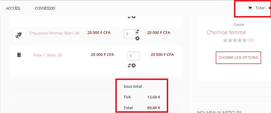

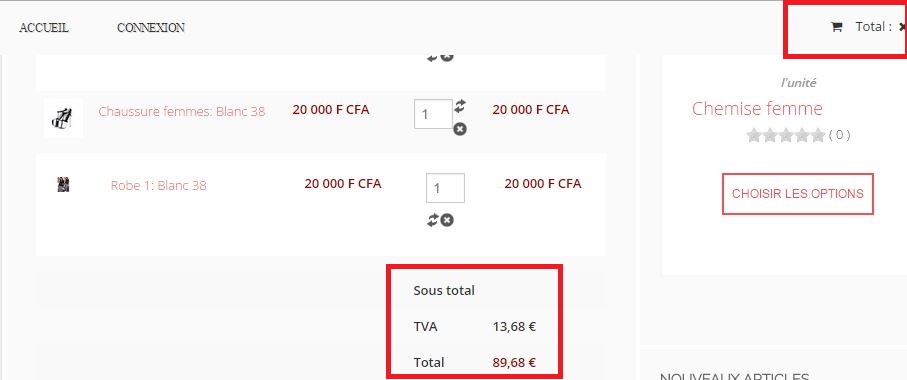

I tried but it's not working fine: sub-total, tax and total are only displayed in euro (kindly see screenshot attached).
Also I'm using multicart and now I have no price displayed in the mini cart.
Could you help me with the code to edit please?
Kindly see the screenshot attached.

You should not remove that code. That's the code displaying the price. If you remove it, the price won't display at all (like you got in the cart).
As I said, use a translation override instead to remove the brackets only.
