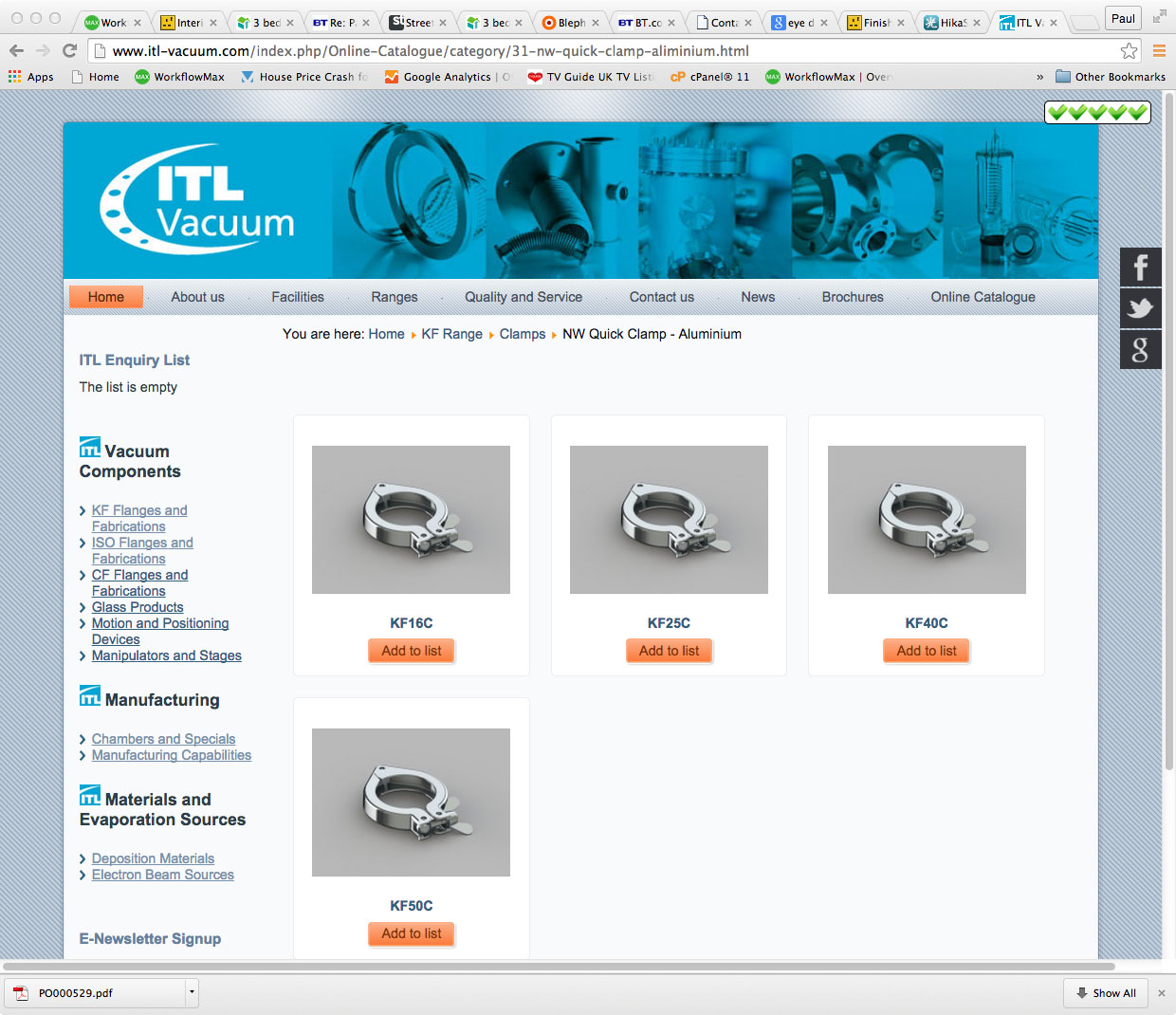

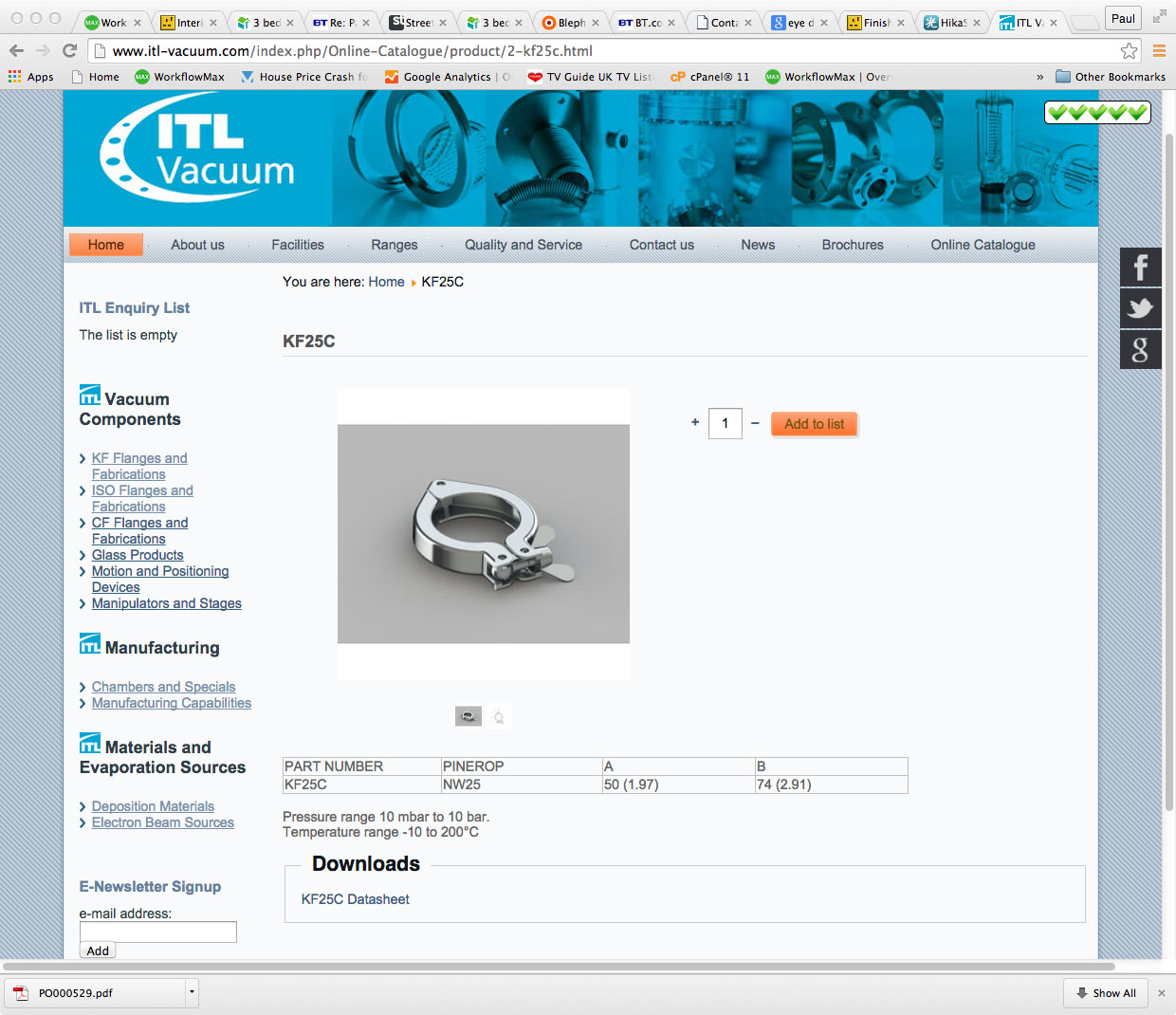

Hello

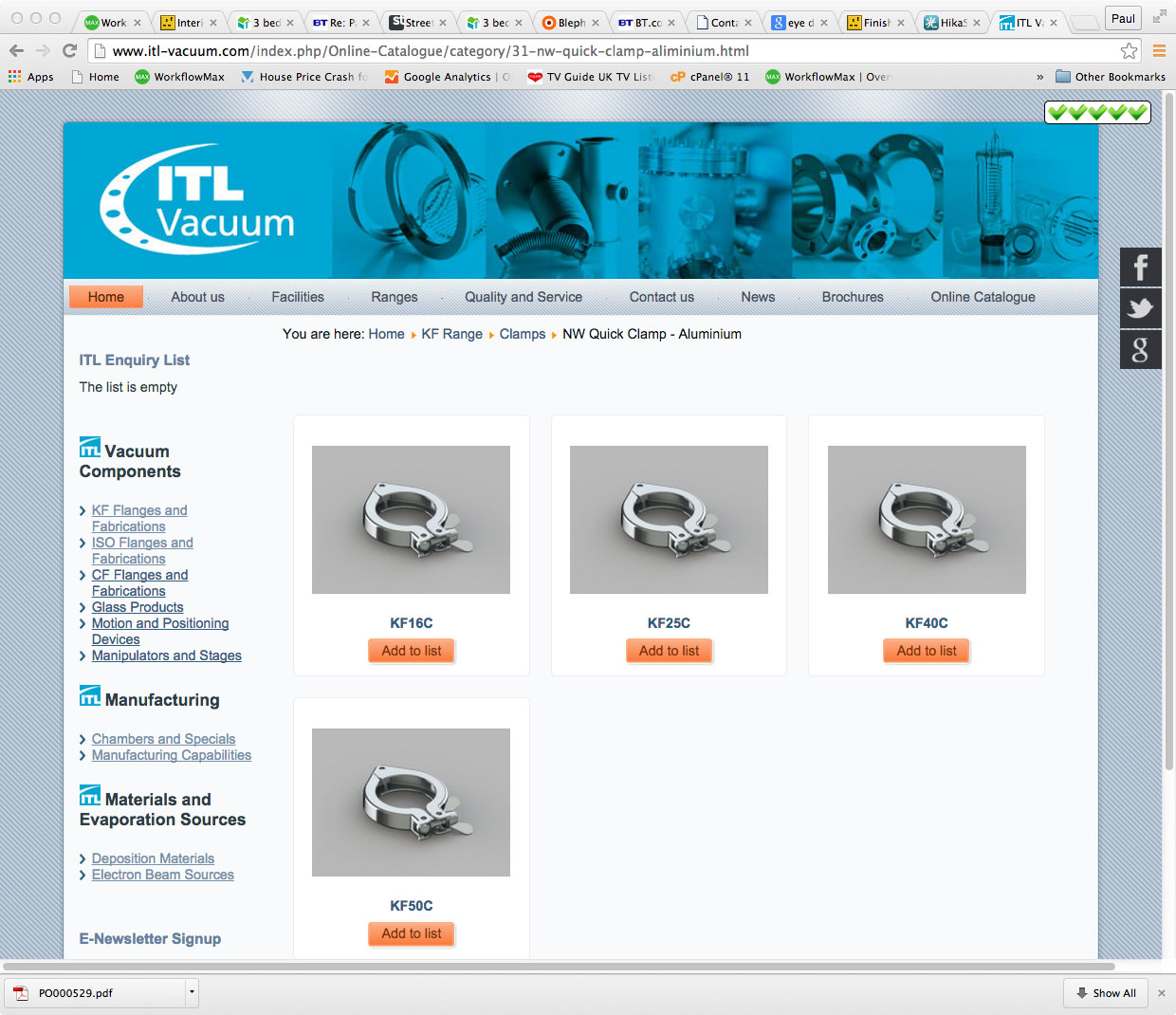

As we drill down the categories to select products the breadcrumbs work fine. See first.jpg.

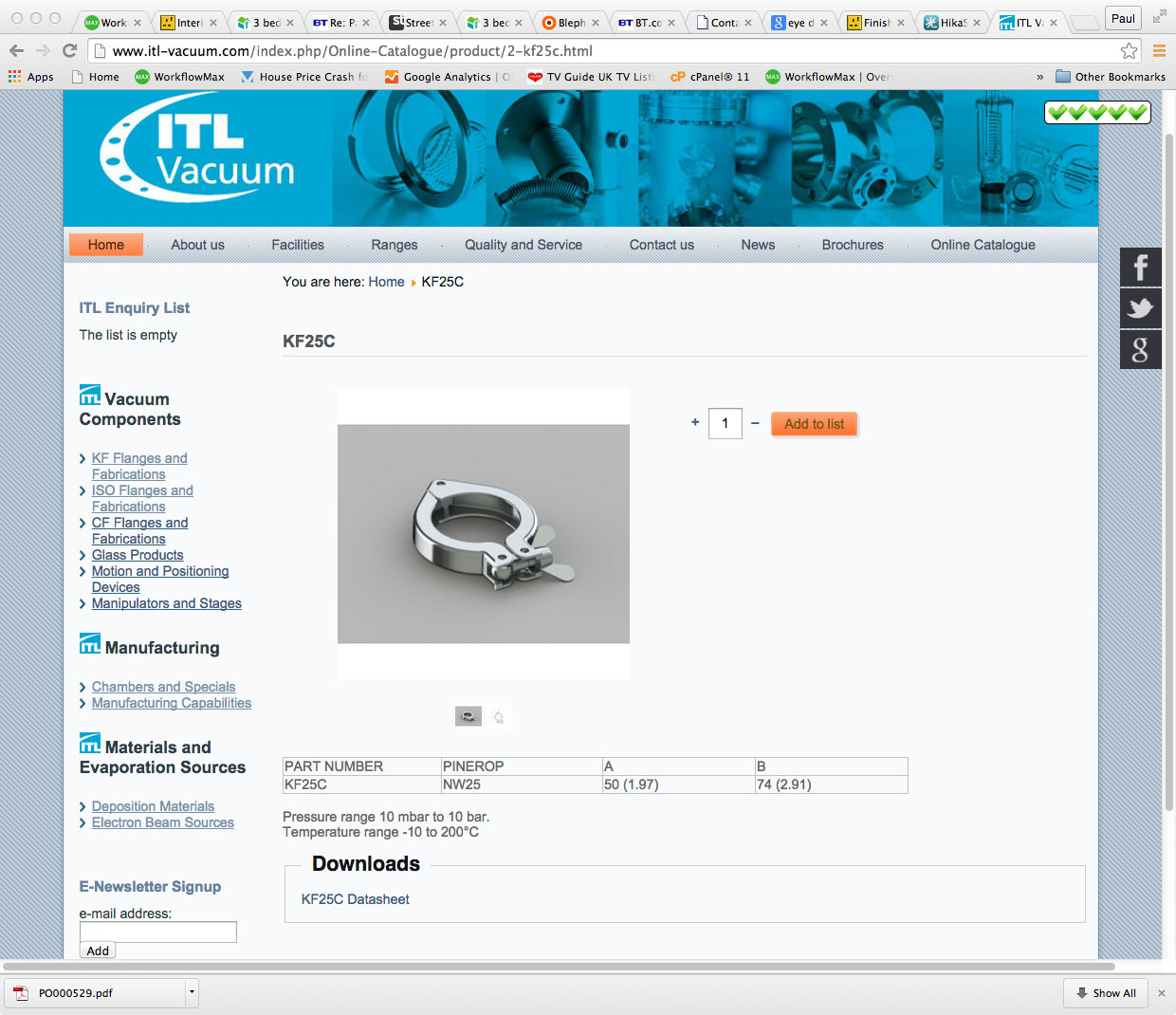

When we click on actual product the breadcrumb trail disappears. See scond.jpg.
How can we fix this?

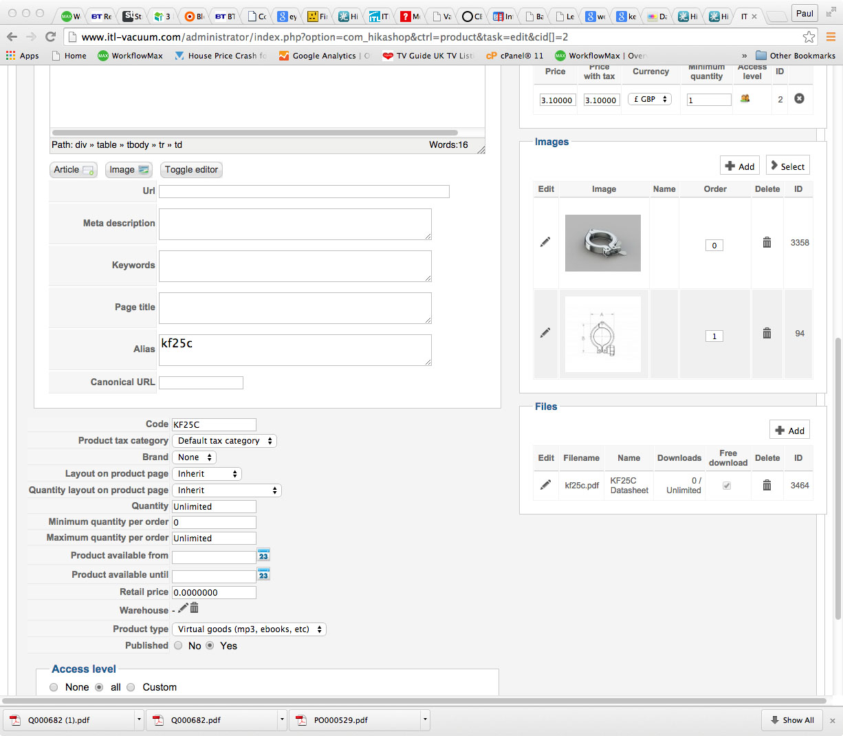

  • Posts: 94
11 years 5 months ago #194273
This field is blank also.

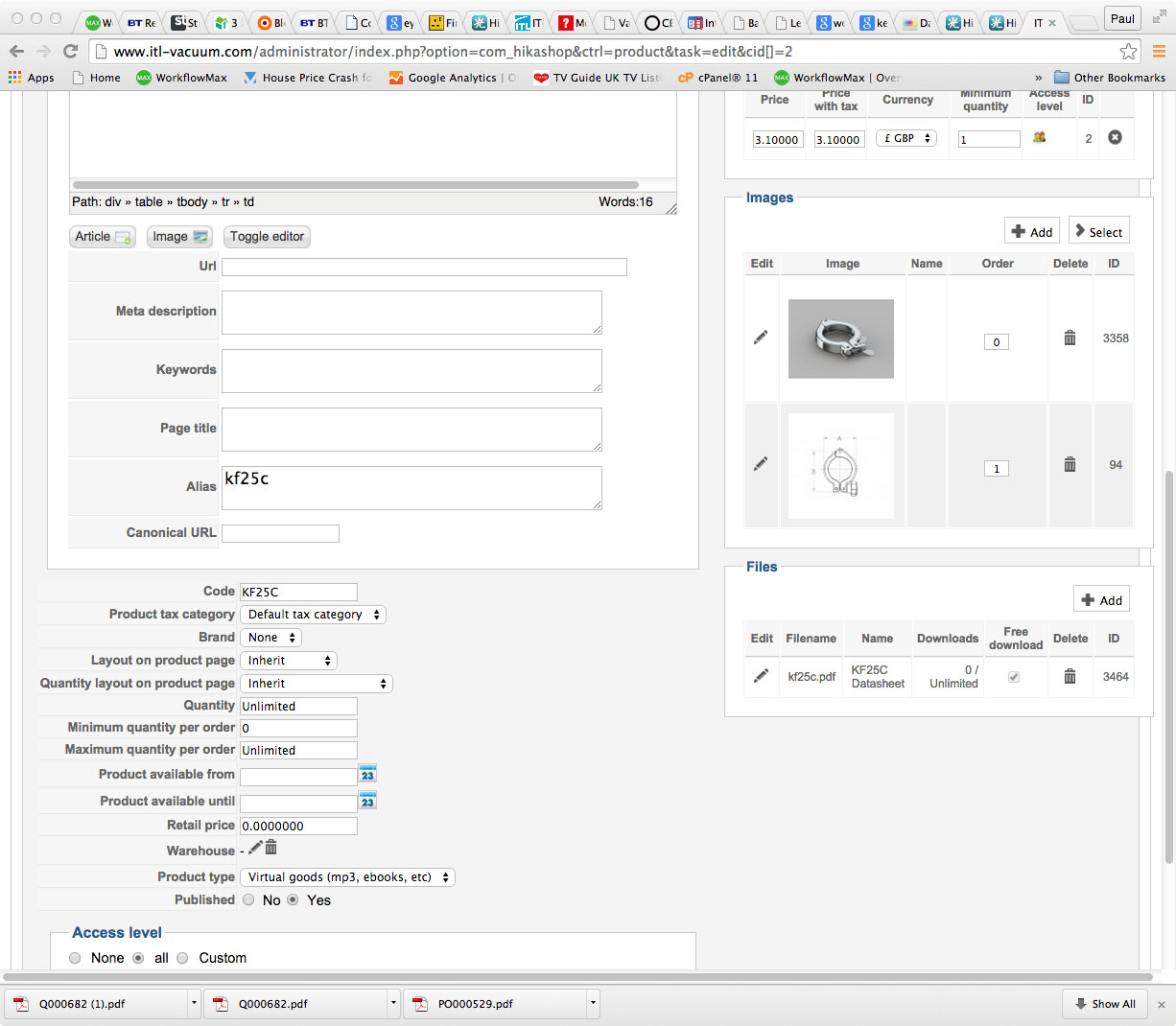

Screener here
  • Posts: 86077
  • Thank you received: 14186
11 years 5 months ago #194401
That's not normal. The link to the product page should change with you turned off the "simplified breadcrumb" option if you don't have any canonical URL.
You must have something caching the old URL. Either some caching activated on your website, or a SEF extension like sh404sef which also caches the generated URLs.
Could you please check on that ?

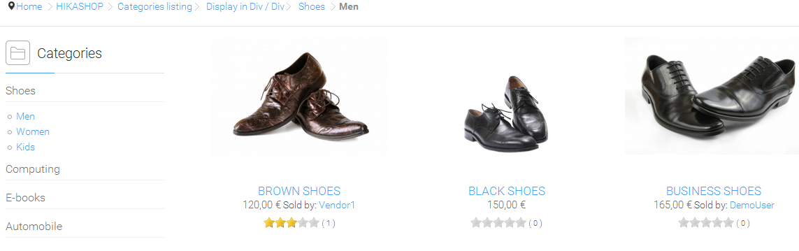

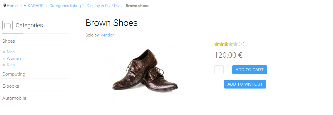

Here you see the breadcrumb drill down to Shoes / Men
When you click on the product Shoes / Men disappear from bread crumb. Can you make changes on your demo site to show Shoes / Men / product name in the breadcrumb?
  • Posts: 86077

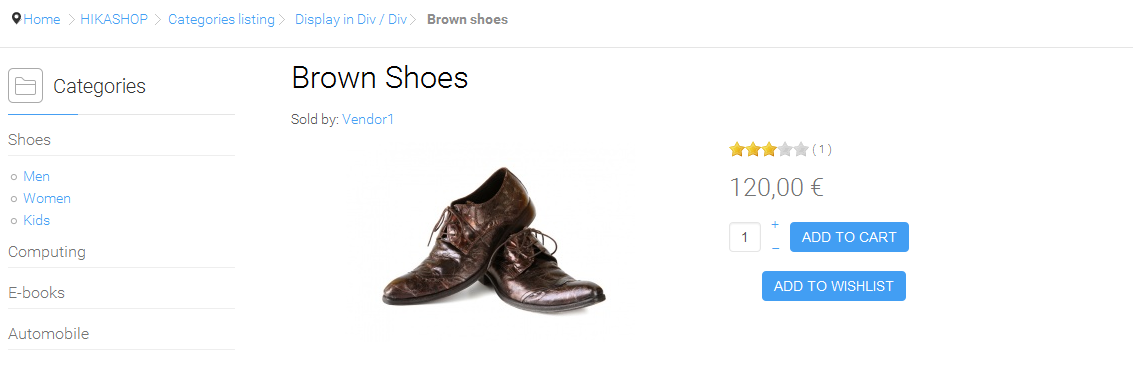

11 years 4 months ago #196684
It works fine on our demo website.
See: take.ms/Milic
Of course, in order to see that breacrumb on the product page, you first need to turn off the simplified breadcrumb option of the HikaShop configuration on the demo website (and you don't have access to the configuration page of the demo website for security reasons) and by doing that, it will add the /category_pathway-13 parameter at the end of the product page URL as you can see in the screenshot.
That's actually that extra parameter in the URLs of the product page which allows the system to display the breadcrumb like you want.
So if you don't have the category_pathway extra parameter in the URLs it's normal that you don't get the breadcrumb like you want on the product page. And that can come from either having the "simplified breadcrumb" option turned on (it should be off for the way you want the breadcrumb to appear), or that you have a canonical URL filled in your product (make sure that it is not the case), or that you have some caching preventing you from seeing the change on your frontend.
