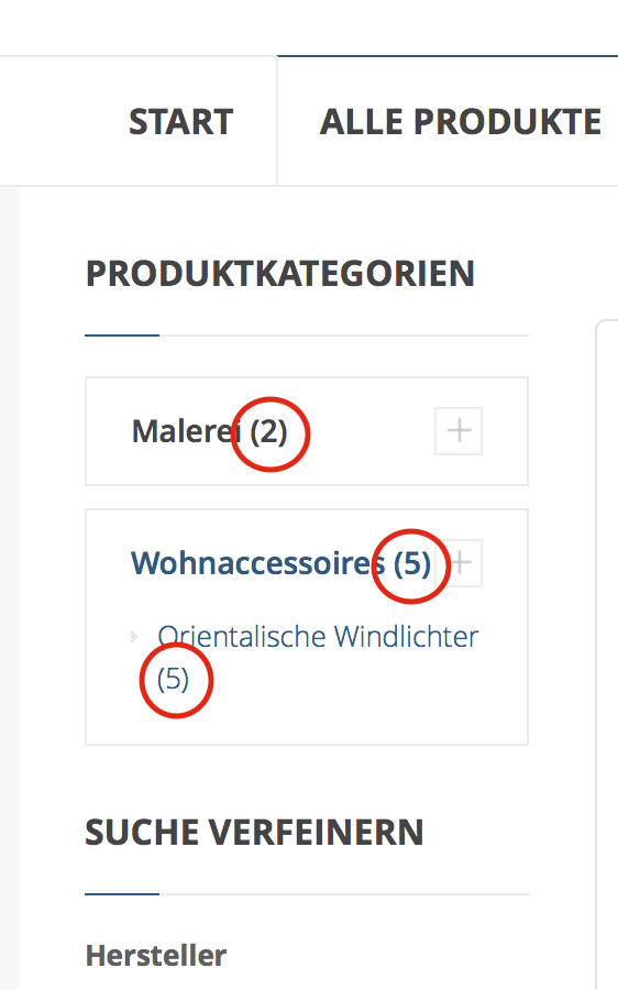

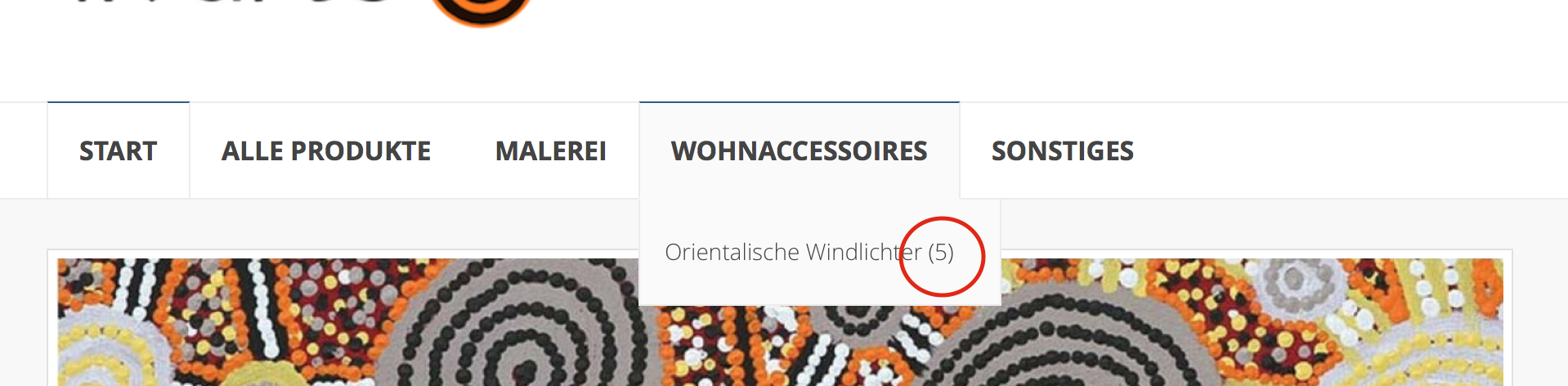

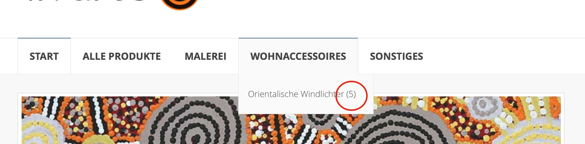

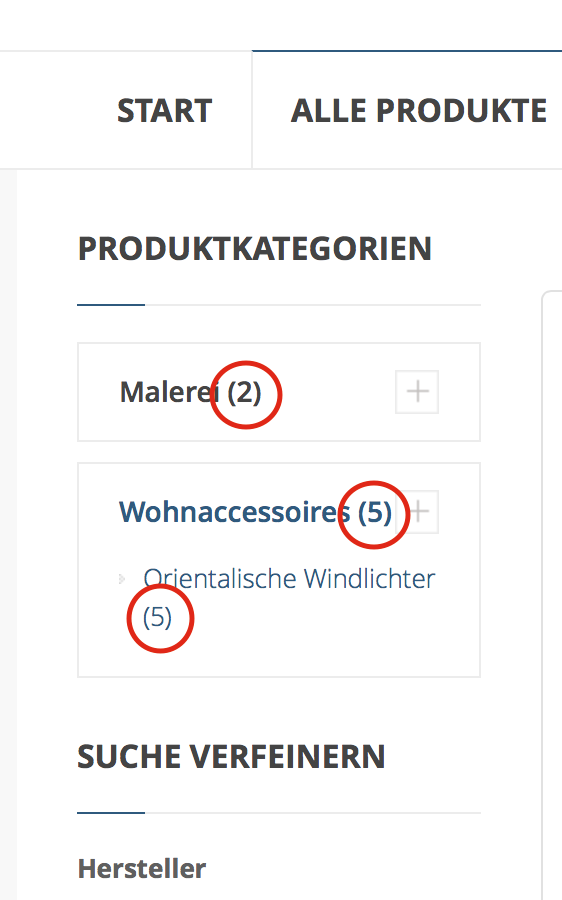

how can I delete a number of objects in a category from a top & left-side menus, please see screenshots attached.
It's probably a very simple issue, just got stuck on this somehow...
Thanks!

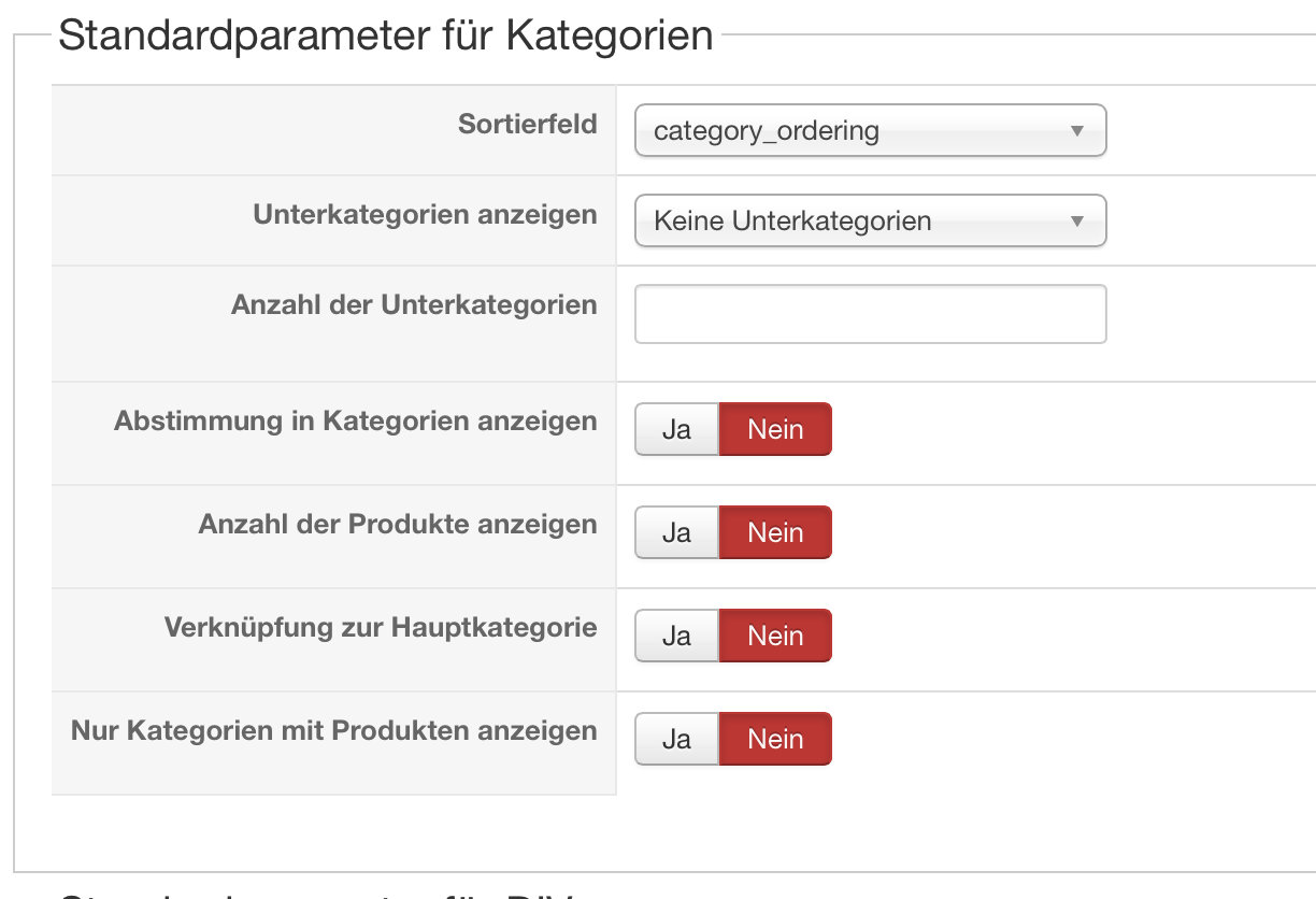

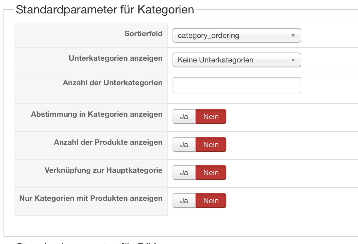

Anyway, as you proposed, I checked the option "Show the numbers of products" under > Config > Display. It is turned off, see screenshot attached, but the number of product still appears in the menu.
Any other idea?

Then the same option is set to "Yes" in the configuration for the category listings, this overriding the global configuration. Please check the relevant category listing menus/modules and make sure that the option is set to "Inherit" or "No".
